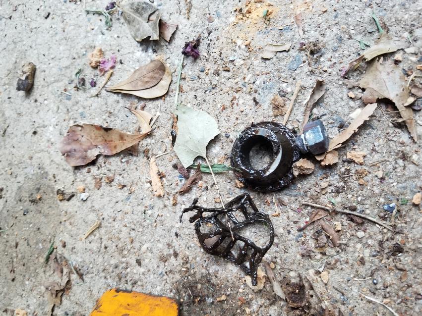

Oh and I tore into the truck a bit today, this is what is left of my upper trunion bearing LOL.
