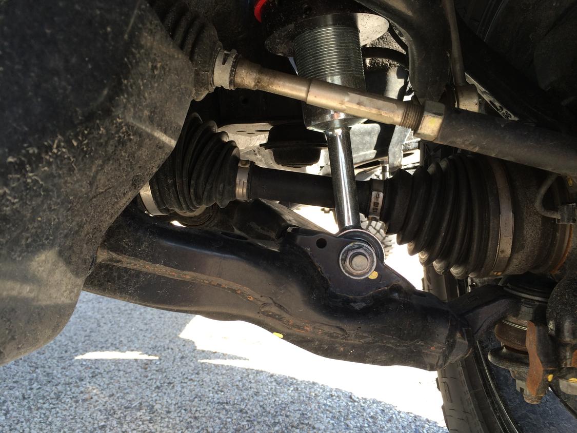

Hi Fellas, recently installed the BOSS/LR UCAs/285-70-17 Duratracs/17x9 -12 setup. Started reading about some folks having too much lift and having some issues rubbing (Alex T4R; NPTITims) and perhaps having their "CV boot fins kissing." I don't have any rubbing issues (after trimming mudguards) even at full lock; however, looking at my CV boots, they do "kiss". I understand it's nearing impossible to "diagnose" a problem via pictures, could anyone kindly comment? I did not change any setting out of the box from Toytec. New to modding Toyotas (formerly a wrangler guy) and not familiar with independents. Nonetheless, would sure appreciate any feedback. Thanks much!

I'm curious as well. I just installed the toytec boss kit and my boot ribs are rubbing as well. I have the diff drop and lowered the coils to only having 9/10" of thread showing below the locking nut on the coil. I installed re manufactured axles from vcj with the extended boots. I feel like lowering the coils more would alleviate the issue but then what's the point of lifting. Ha

Dude, your CV's look more than ok. I wouldn't worry.
