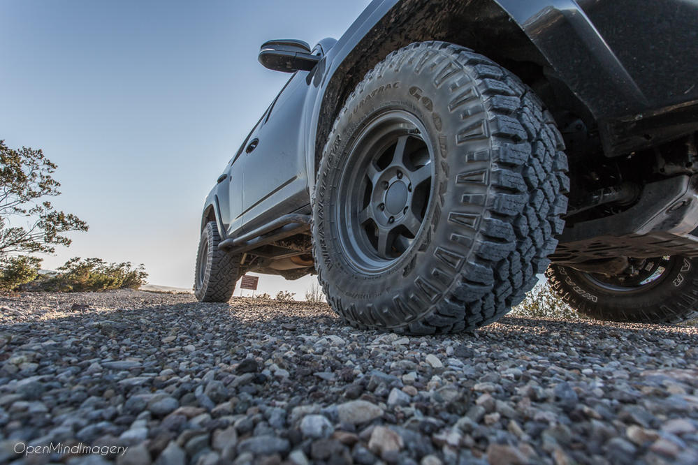

Those of you running these coilovers, if the height of your truck is LEVEL, how many threads are showing beneath the bottom collar[adjustment] on the front coils?
At full lock I'm still having some rubbing issues on my bumper (inside the fender) & body mount after 285s and an alignment, and hoping to save myself a few tire removals by starting at a tested height. :D
Still has a little front rake to it but intend to fix that asap. I shall pay the forum Gods back in Big Bend pictures from this weekend :grouphug:
