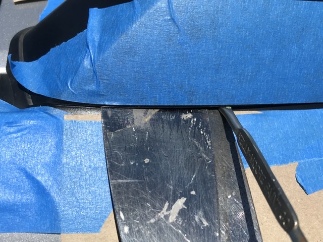

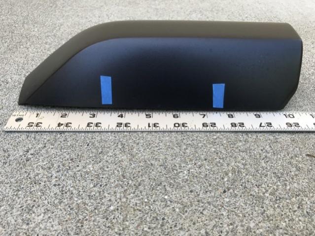

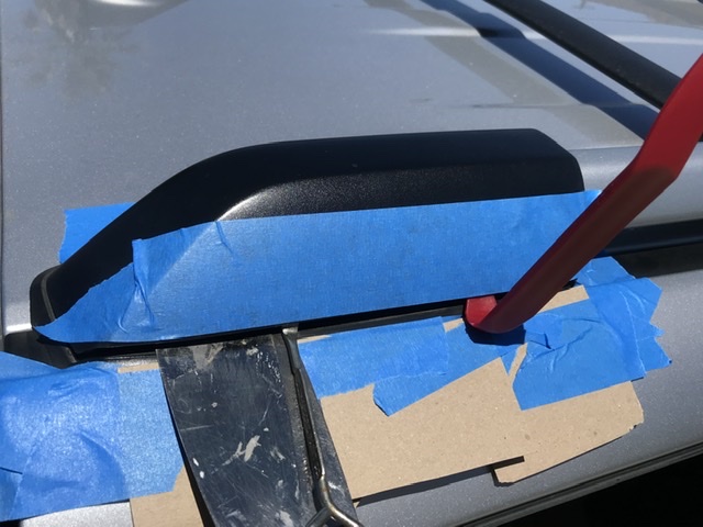

I have an 18 ORP but I believe the side rail end covers are almost the same. Here’s how I removed my rear covers.

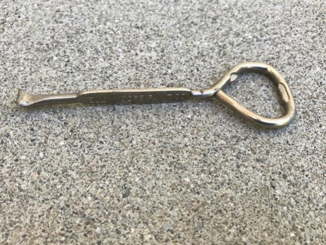

Put masking tape over your roof area to protect it in case you slip with your tools. I also taped down a layer of thin cardboard. Don’t pry against the roof metal. I used a thin putty knife to open a small gap between the cover and it’s base plate at the rearmost clip location. (See the photo with blue tape at the clip locations). I actually used two putty knives, one on top of the other. Then inserted a paint can lid removal tool between putty knife and cover to lever up on the putty knife and pop the clip up. With a large gap opened up I then used a plastic trim tool to slide and locate the other clip and pull up to remove the other clip and the cover came right off. See the photos for reference.

Thank you for the pictures. You’re probably right on the methodology, my concern is over the fact that these covers are shaped different and the entire rack is different too. So not sure if there was a difference in methodology.

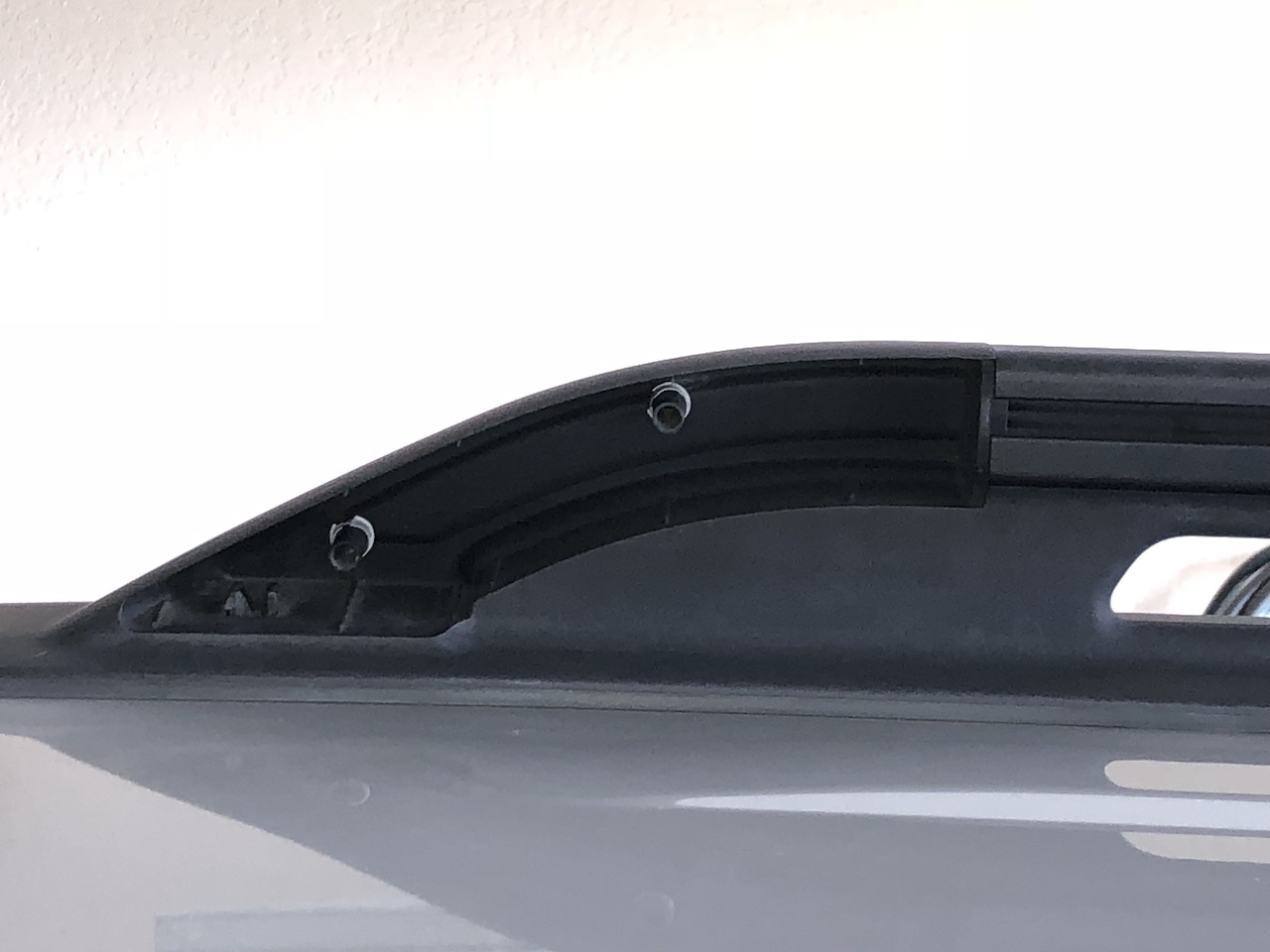

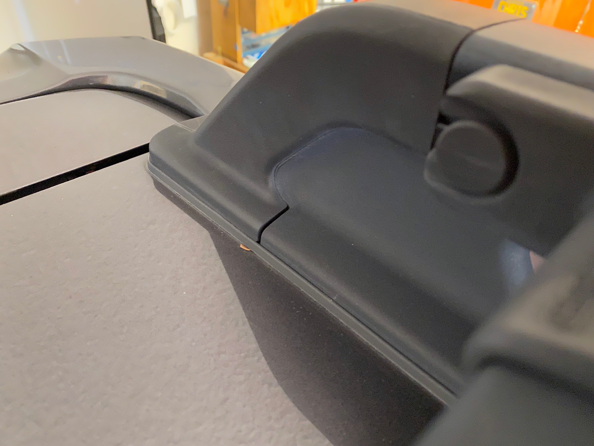

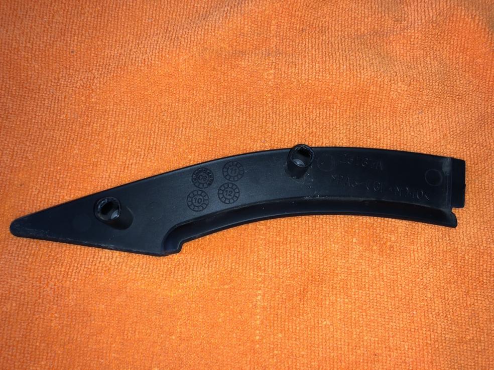

Nope. They are completely different. Only the inside of the 10-13 Trail rack end cap is removable. The good part is you don't have to pry it off down next to the sheet metal.

I think you're pointing out exactly what I was seeing when I originally asked the question. Your pictures indicate the front inside of each rail. When visually inspecting it seemed to me like those might pop off. Your pictures confirm it! Couple of questions if I may:
- It appears that these front inside covers basically pull back straight (towards the center of the roof). Is that correct?
- Once these inside covers are removed, does that expose the inside channel (in order to slide an item in or out) or is there a stopper or some other object?

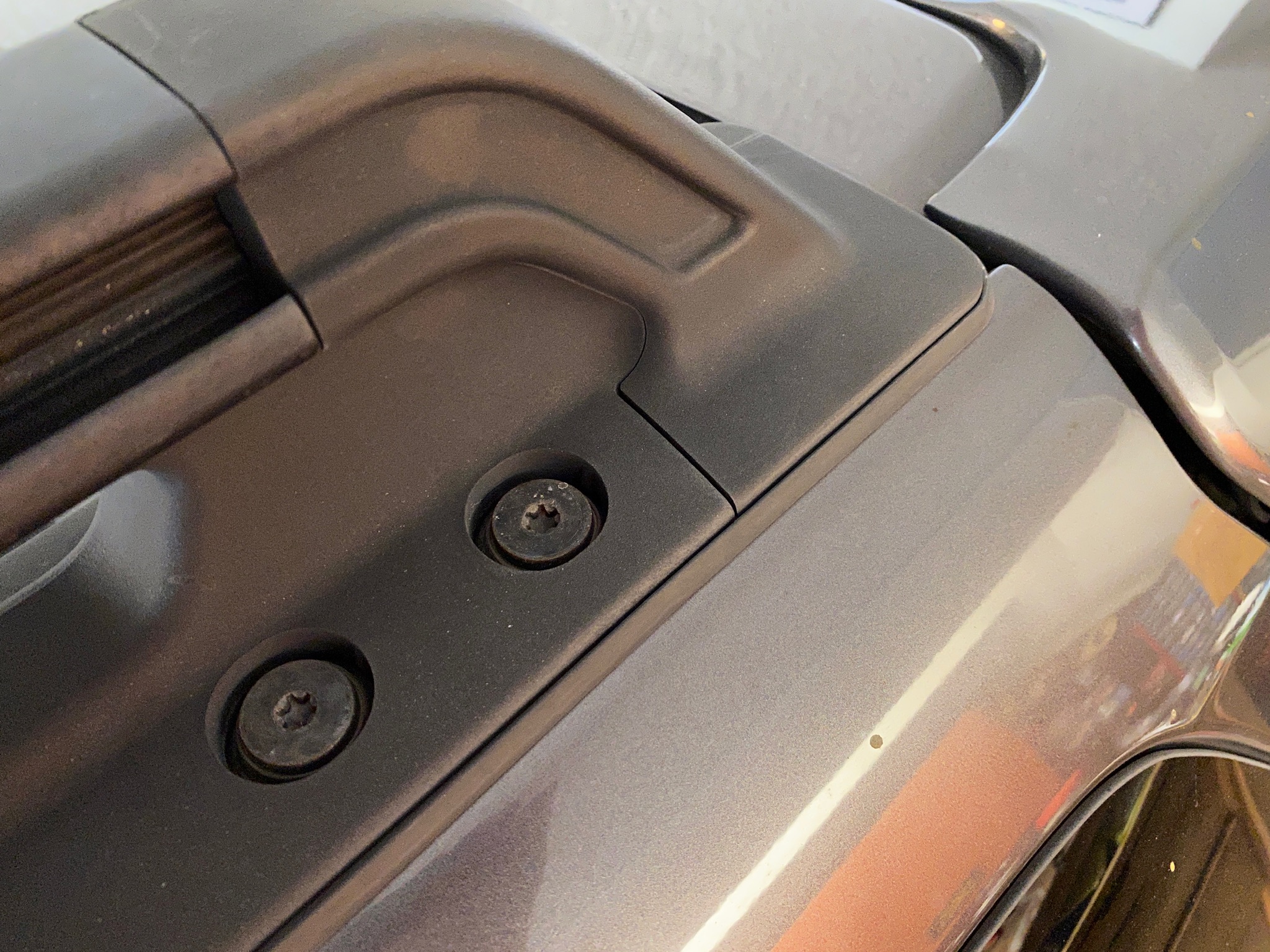

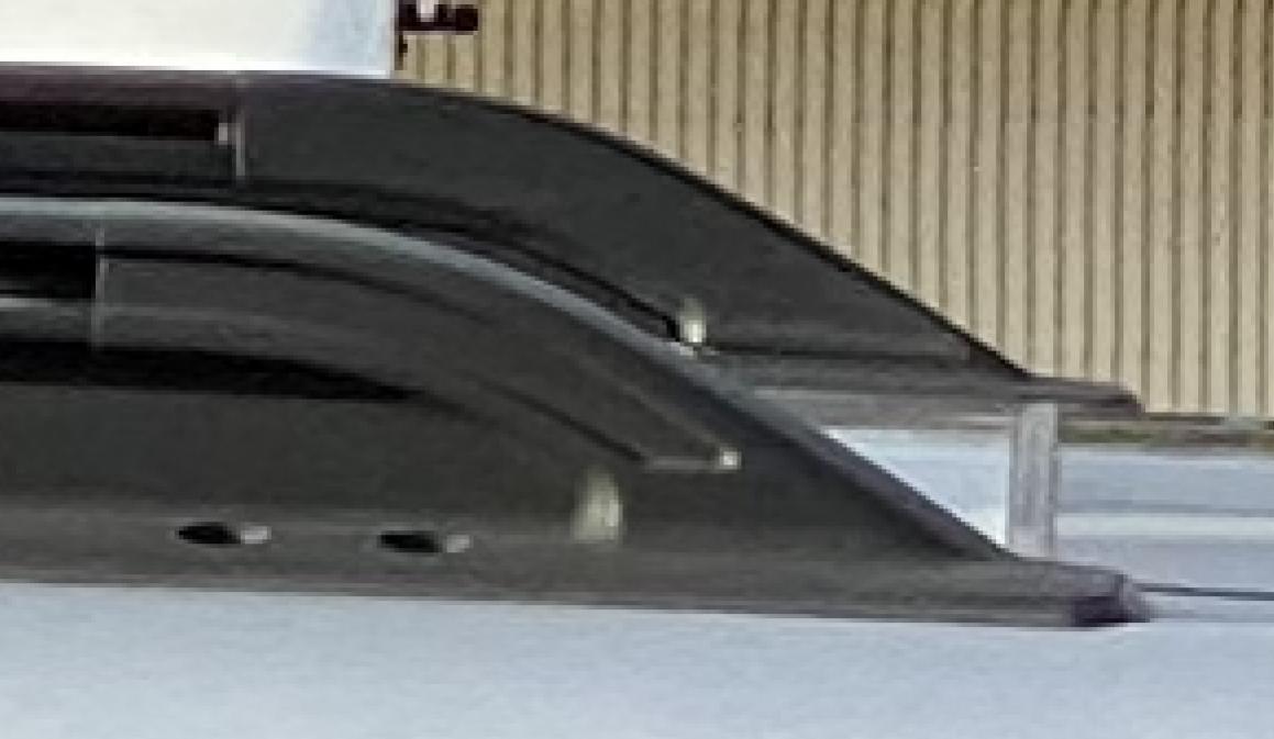

- To confirm, the back is not a two piece design (with pop off covers)? I'm attaching pictures from the back that seem to indicate a two piece design.

As for popping them out, you are correct. They pull straight out, not up. I used a plastic spudger to get behind and pry them. But it looks like you have to remove the back covers to slide bars in and out. Back caps are removed vertically.
