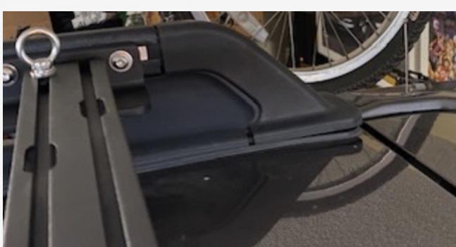

I'm hoping you guys can help me out again. Last time I was trying to figure out how to remove the end caps...now I need to figure out how to place them back on! Obviously I can put them on, but it looks like it's not seated all the way. At the base I can't seem to get it to move forward all the way whereas where it touches the rail it's pretty good. It seems like I have to get it inserted in the rail first. Then it pivots or rotates down and into place. But it hits the base rubber/trim at the back and wont go any further. I don't know what I'm doing wrong, but after 30 min I gave up for the evening. I'm afraid I'll break something. I've got some pictures attached for reference of what I see.
Appreciate your help!
Figured it out. When I left the end caps off for a few days, the rubber began to shrink. Used a heat gun and got it in.

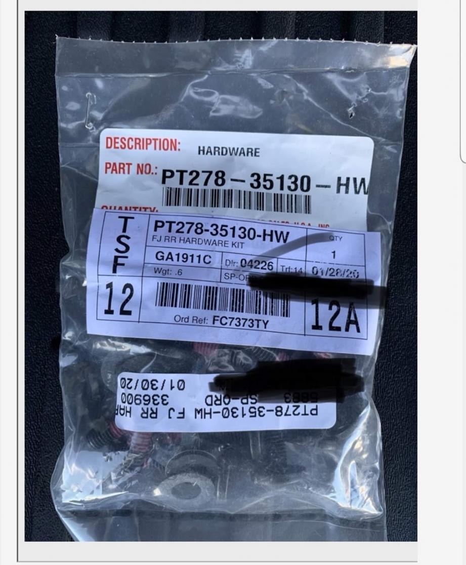

I bought a used trail rack and need your help!
There seems to be a black gasket material that has broken off on every one of the "nubs" where the screws go through and mount to the body. It is rock hard and almost plastic-like. You can see it inside of the metal spacer as well.
Can anyone shed some light as to what this is? I contacted Toyota and they had no clue.
<a href="https://ibb.co/6PyQxwN"><img src="https://i.ibb.co/DC1dyWL/Screen-Shot-2020-10-23-at-5-35-50-PM.png" alt="Screen-Shot-2020-10-23-at-5-35-50-PM" border="0"></a>
<a href="https://ibb.co/ZVd2J1j"><img src="https://i.ibb.co/KX6KGzP/Screen-Shot-2020-10-23-at-5-35-38-PM.png" alt="Screen-Shot-2020-10-23-at-5-35-38-PM" border="0"></a>
I believe those are the remnants of the original mastic washers. If you order the fj roof rack mount kit it comes with new ones. I just mounted a used trail rack in the same condition. Ordered the kit, used the foam washer in the kit along with my original mount bolts and rubber coated washers then sealed the mount bolts and haven't had any leaks.
