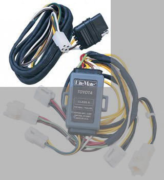

I just need to replace the 4 pin piece in the picture. I don't need the whole kit. I think my mechanic might have removed it a while ago and didn't put it back on. Chances are he doesn't have it now either.
Anyone know where I can find the 4 pin part of the kit? I can't seem to find it or maybe Im using the wrong search words?

If you have the original Toyota converter they might have the pigtail separately. I have used many of the Hopkins converters and they have a very short life span.
I recently had a problem with hitch wiring as well. Instead of replacing and rewiring part of it, I found it more effective to replace the whole kit converter and all. The PO of my truck had a janky UHaul converter that wasn't run properly so now I have a nice, new, fully functioning kit. Might be worth a replacement for you too.

4pole vehicle wiring harness
You can just use the include quick splice connectors and ditch the white connector in your original pic.
