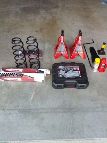

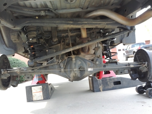

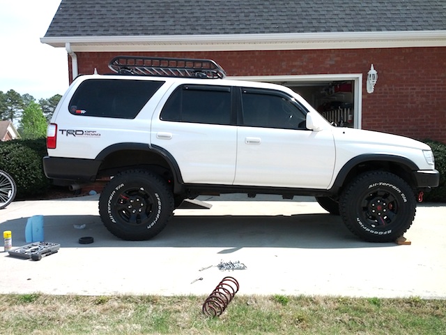

Lifted the truck more today only did the rears for now. LC coils and shocks in the back to replace my 99 tall coils with a 1.5" Daystar.

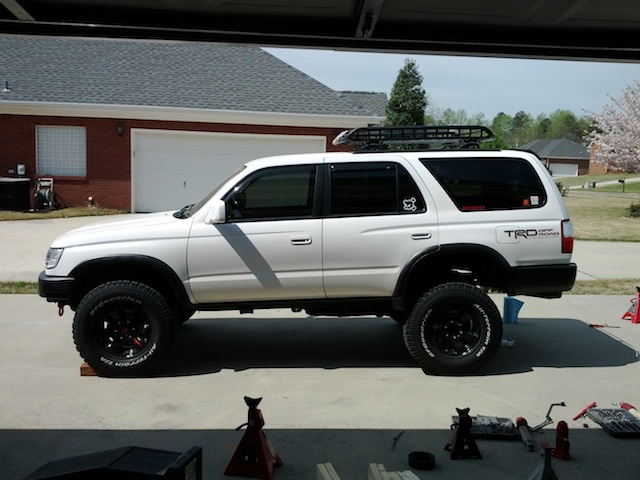

Before. Rear was 38" fender to ground.
After. Rear is now 41" fender to ground.
More to come tomorrow....got some Bilstein adjustable 5100's and Toytec/Ebiach coils going in the front to level this beast out! Super happy with the outcome and the ease of install.

Oh man, you're gonna love it with the Toytecs/5100. The white lettering on your tires looks awesome too.
Nice job dude! Can't wait to see it with the front lift installed! Any plans for bigger tires?? If so, what kind are you planning on getting?

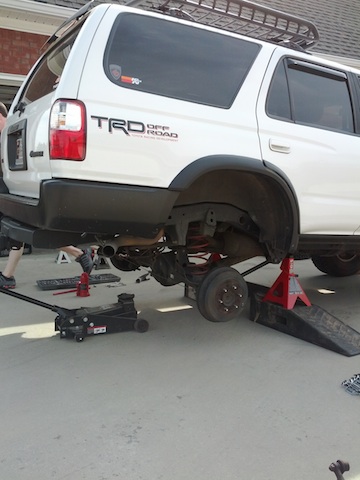

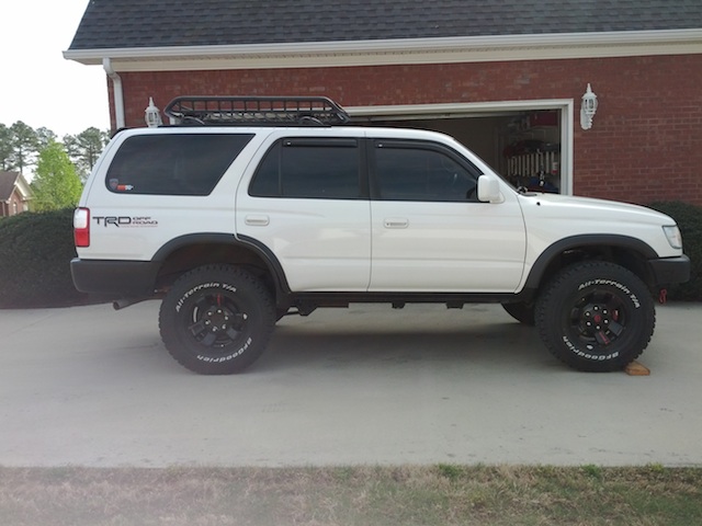

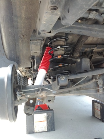

got the fronts done today! Was too bad, couple of friends and pb blast got the job done. Here's some cell phone pics of the install.
Pretty fun day....I've missed wrenching on this thing.

Looks good man! I've always been a fan of the look of your 4R. I like the CO's you chose...just put a set of those on my Runner over the weekend & the ride is MUCH improved!
I also like how you painted/plasti-dipped below the doors & the pinch-weld. Nice!

thank you sir! Gotta love our white 4R's. Love the front CO set up also. As for the rocker panels they are bed lined and I love em!
Man, Ive always liked the way your truck looks. Every part adds to it. The flat black flares and bumpers, gloss black rims, and even the tires with white lettering showing. If just works well on your truck. Nice addition with the lift.
Looks great man! So whats the new front lift measurement?
Thanks man! And I forgot to measure before we lifted it...guess i got ahead of myself. But after i ended up with 38"ish fender to ground after the lift I believe. Its significantly higher I know that haha. So I've got the slight rake I like but not too much.

When I saw the first pics with just the rear done, I was thinking "Holy RAKE!!! Batman!"
But then you got the front done, and it all flows perfectly.
I noticed you left the extended studs installed in your shock's top plate (looks like you had a spacer lift up front @ some point). Why didn't you swap them out for the stock studs while you had it all apart?
