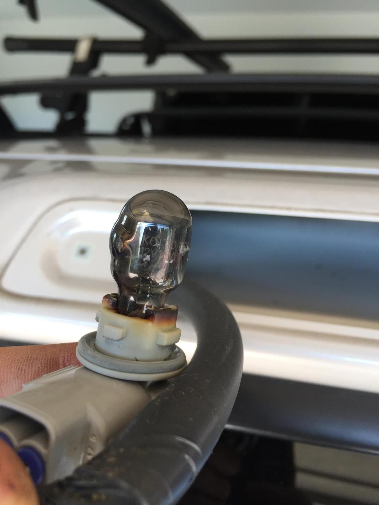

The ISSUE IS FIXED AND WAS A BURNT OUT 3RD BRAKE LIGHT BULB! I can't believe this and how i missed it. I just had the truck inspected like 2 months ago and all lights were working and this whole thing started about a month ago. I put a gallon jug of windex on the brake pedal to test, and sure enough, 3rd brake not lighting up! Same bulb in there since 1997! 20 yr old bulb (Koito 18 watt), and it was charred and bulb glass a little warped. Pulled the bulb out and went for a test drive. Same issue, until I put in a NEW bulb, and then it fixed the issue!
A few questions.
1) Why does a new bulb have to be installed to fix this? Seems odd, but maybe just this specific location, 3rd brake light causes this?
2) Now I can make the issue happen by hitting the brakes with the gas on, like someone else mentioned (which is normal, torque converter, and that's what was happening when I signaled with the burnt out 3rd brake bulb.
Also funny how you must remove the spoiler to install a new 3rd brake bulb.

Bulb creates a voltage drop that the ECM relies on
