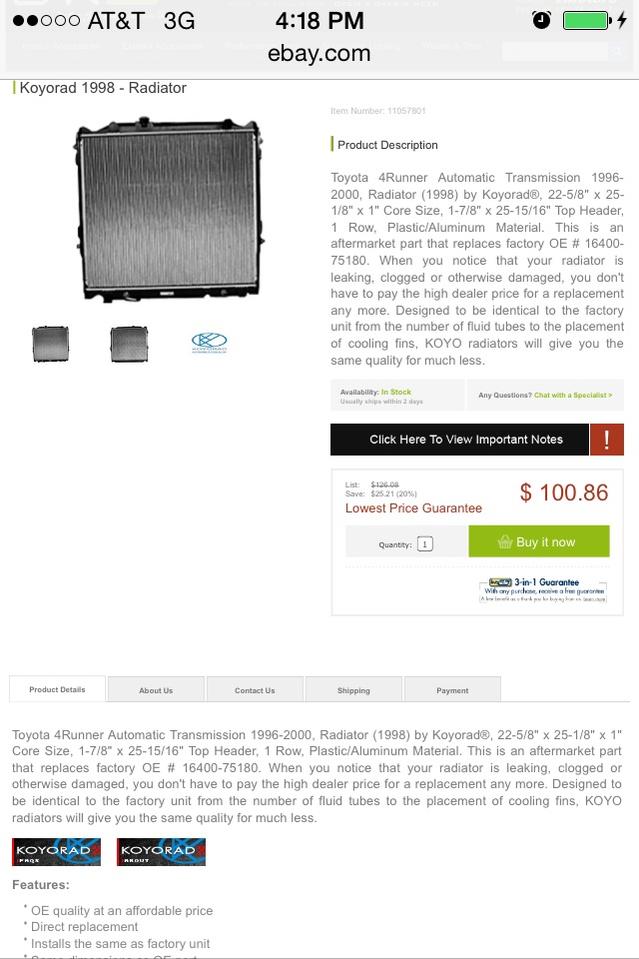

Is this the right radiator,it says 1998 not A1998?
Yes, that's the right one. Also check RockAuto and Amazon. Also know that Koyo and TYC are the same thing so you might search for both.
