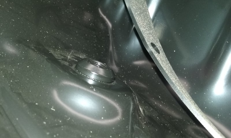

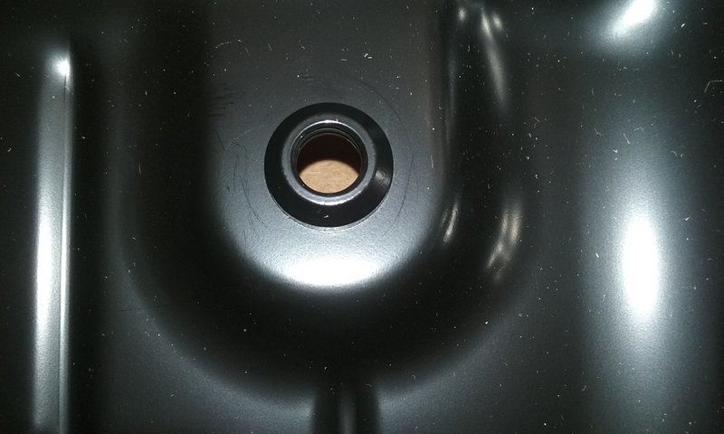

The threads are probably not stripped. There is a captive nut like device that is 'bonded' to the inside of the pan. It's not really spot welded, more of a arc bond. That bond will break and allow the 'nut' to spin. The 'nut' looks like a thick conical washer with female threads.
You may never experience a leak or it may start to loosen. As a temporary remedy you may be able to grab the plug head with a pair of vice grips and pull down at a slight angle with a lot of force while tightening and get the 'nut' to grab enough to firmly tighten the plug. That's a one time thing.
The only way to confirm and fix this is to remove the pan. If that is the problem then the 'nut' can be spot welded back to the pan at a low amperage.
Here is picture from a Tacoma pan.
Thank you for that picture. I saw that raised section on an ebay auction but figured it was just a pressed out part of the main steel pan. That probably saved me money on another pan. I will probably put some JB weld on the outside of the drain plug to make sure it doesn't back off and drop the pan in about 30k miles for another drain/fill. Looking at a picture of the underside the threaded conical piece does not extend to the outside and wrap or crimp around. Should not be too hard to remove if the threads are buggered up and I can weld on a nut of the correct size, 10mm 1.5 I believe. I've got stainless wire in the MIG right now but that is a long ways off.

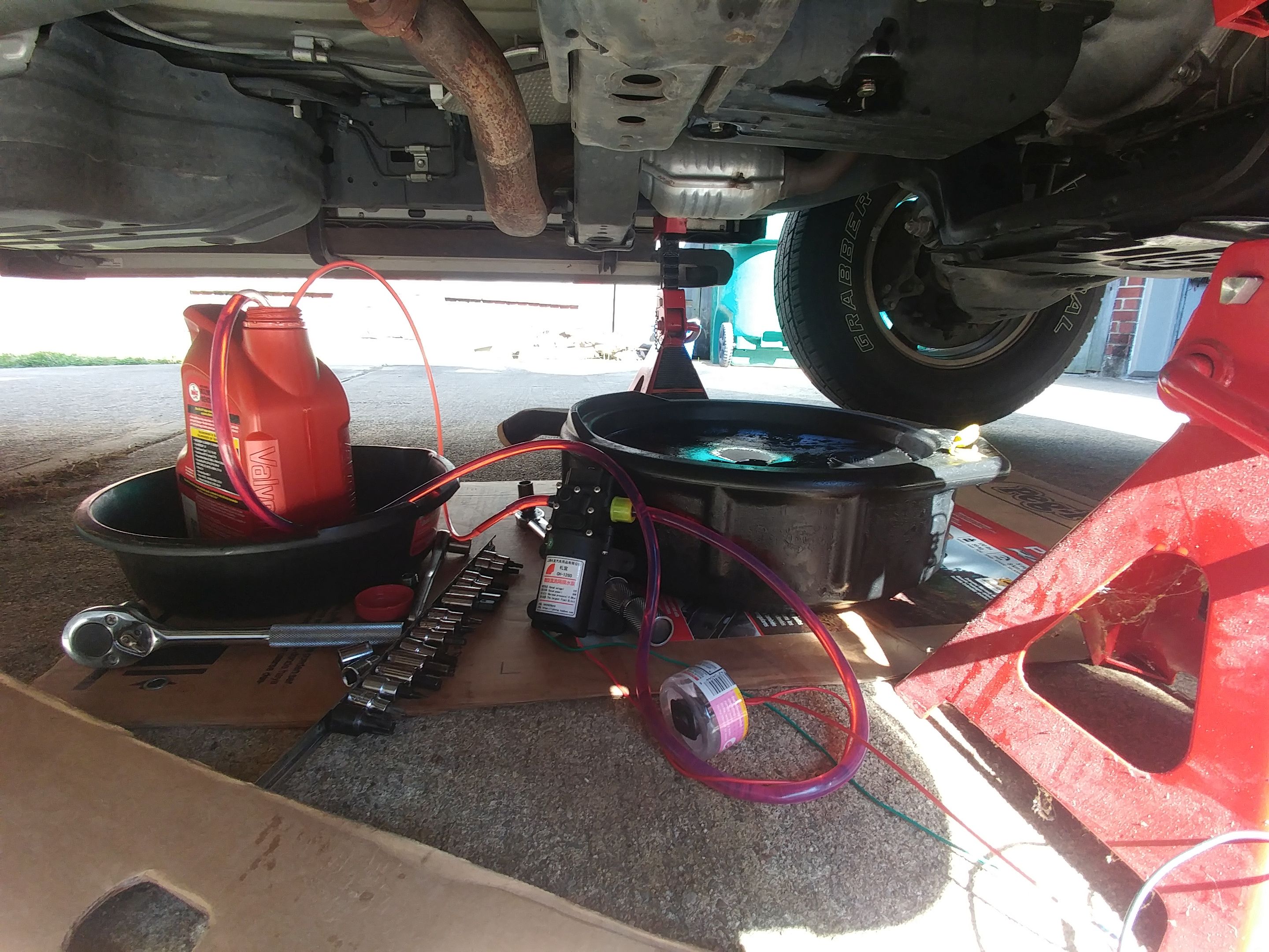

With these large holed mesh filter/strainers used nowadays it really does make more sense to pump them out. The pan on my Ram is a disposable item! $175. For that I think I will use my electric pump I got from eBay. It damn near emptied the jug of MaxLife I put in the 4Runner. There was not more than an ounce left in the jug, I was impressed.
