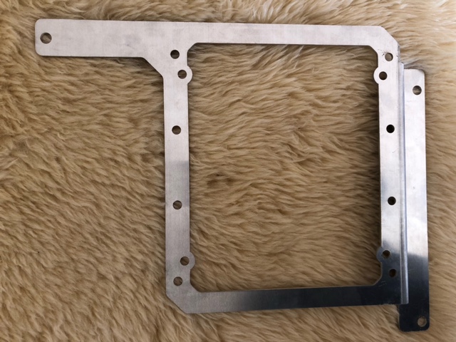

Here is a shot of sexy bracket goodness reclining on sheepskin.... :banana:
This is the Iconic protoype bracket that I received last night. I'll be working on the install today. Shout out to Devon at Iconic!

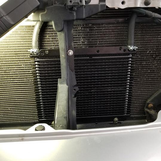

Teaser photo of the second test fit in my 2018 off road premium model. No winch or anything else, mostly stock
Jim

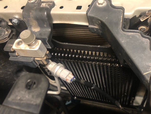

Many thanks to [MENTION=6100]teotwaki[/MENTION] and his very gracious and detailed assistance I have a bracket design that should work for the 5th gen 4runners. I've opened up pre-ordering on my website linked below, I should be able to start shipping in about 2 weeks.
My bracket goes on the passenger side. You may have to bend the lower left power steering line bracket slightly for more clearance and also push the AC line out of the way slightly. Other than that I think it fits like a glove, all bolt in.
