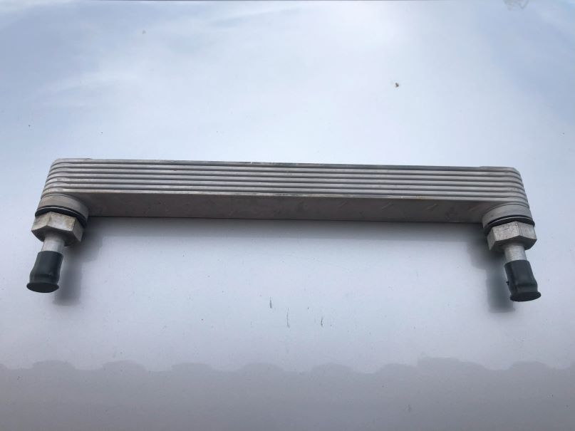

Bonus photo of a trans oil cooler that I took out of the radiator of my 4th Gen. The 5th Gen is probably the same design.

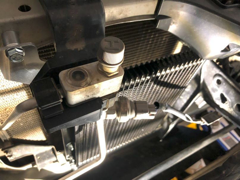

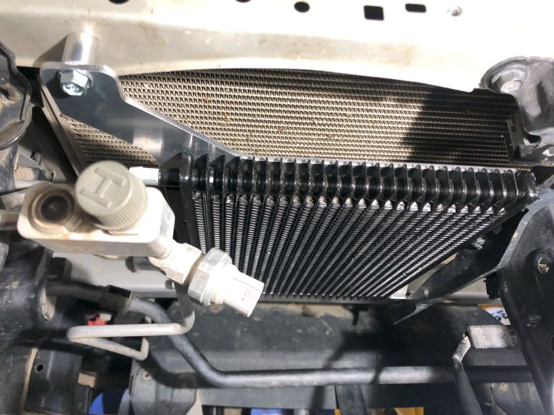

Here is a preview of what the final design looks like in place, one shot with the AC bracket moved for a clearer view.

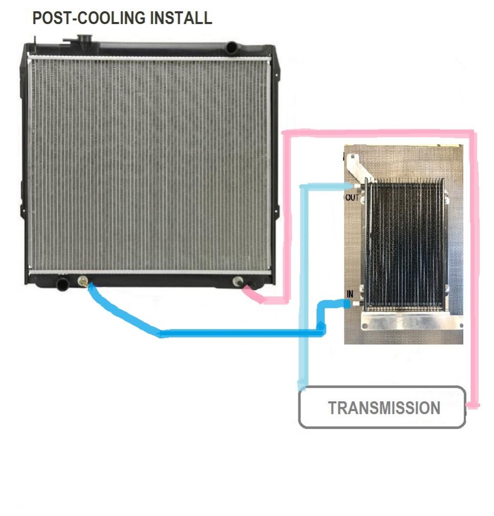

Before the install I read dozens of internet posts and watched almost as many videos on transmission oil cooler installs. To make sure I didn't accidentally swap rubber hoses I drew up my own diagram and took a ton of pictures under the 4Runner. I really had my heart set on making connections near the top of the steel lines where they arch over but it's tough to get in there. I opted for the easier route (and one longer hose) by tapping in near the large radiator outlet at the bottom and on the driver's side.
I spent a few hours choosing how I would route the hoses in order to take advantage of the OEM openings on the passenger side of the main radiator. If this Hayden cooler works well when I'm towing my trailer I will likely have the cooler's return line make a home run towards the steel line that originates from the transmission. Then I would "abandon" (cap off) the steel line that runs outside of the radiator fan shroud, travels upwards and then has a rubber hose run back to the transmission return line. This could shorten up the return hose from the Hayden cooler.
The Hayden 698 is fed from the bottom inlet so as to push any air bubbles up and out. This cooler comes after the Toyota integrated oil cooler because I would like the return line temperature to be lower than the 180 degrees F from the main radiator.

Install Notes, not necessarily in order
I chose the Hayden 698 cooler billed as the "internal pressure bypass" model for cold climates. Patented Internal By-Pass Coolers

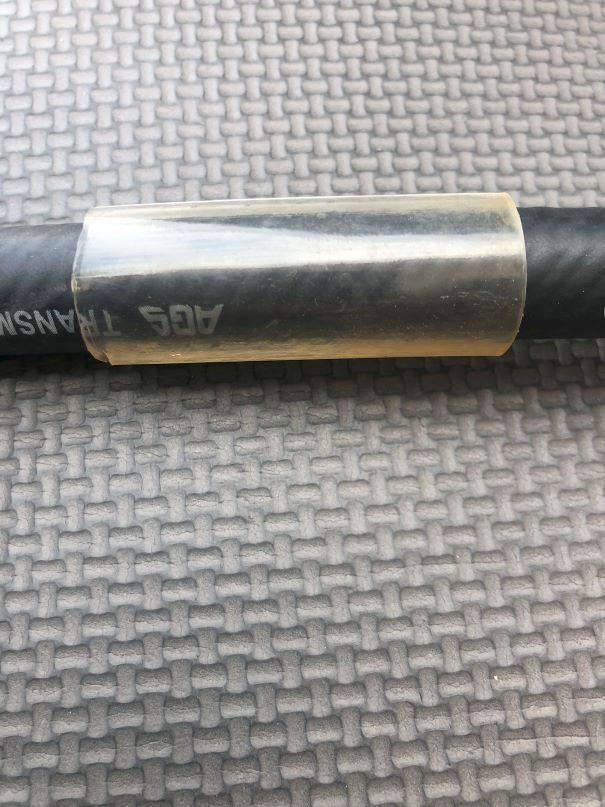

Before install of the bracket it is nice to take a file and knock off the sharp edges that are a byproduct of the laser cutting.

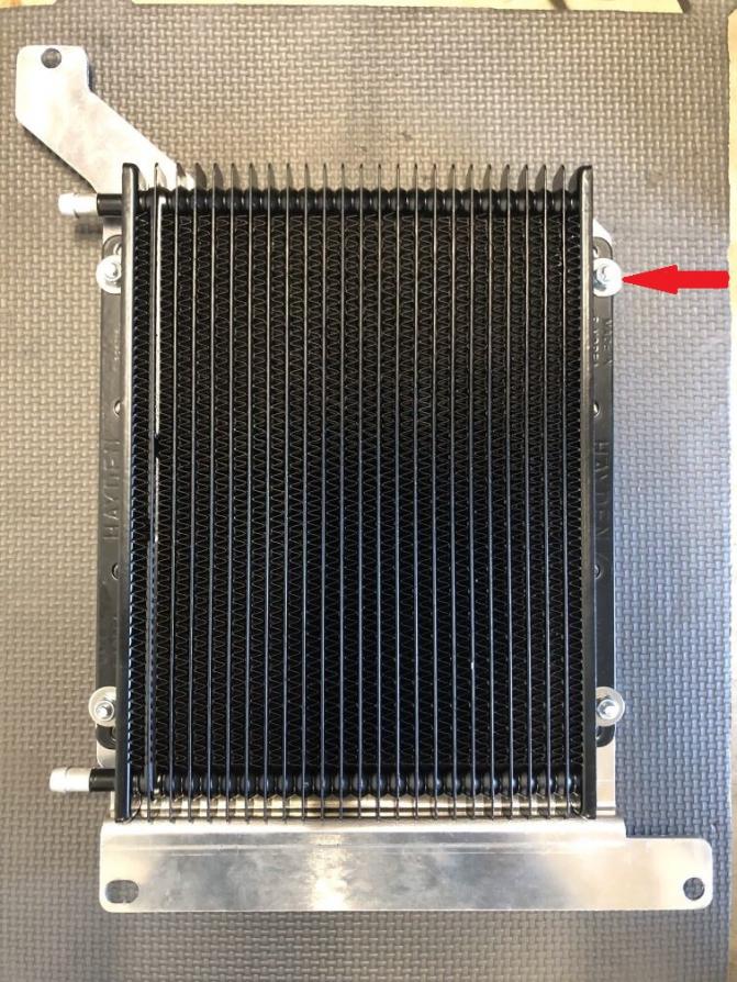

When installing the bracket it is easiest to first bolt the cooler to the bracket. I faced the bolts forward towards the front of the truck so as to have less things hanging out on the back when putting the bracket and cooler into position. I supplied my own washers for the bolts but given how light the cooler is the washers aren't necessary. There are no lock washers supplied but nylock nuts are supplied. Future production kits may vary in the interests of improvements and ease of assembly.

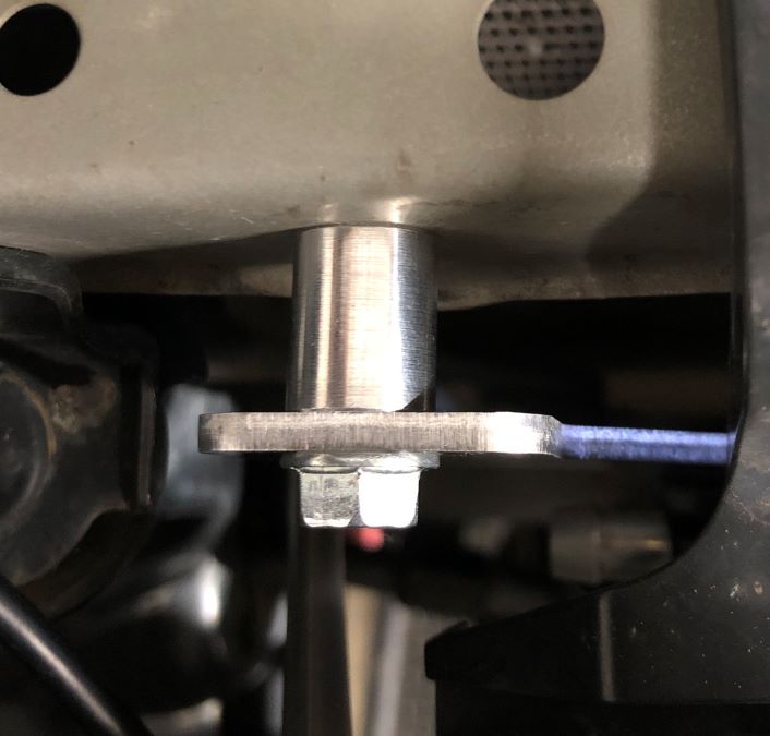

Note the hole that the upper right corner bolt is in. This is to avoid the bolt directly contacting the hood latch vertical support bracket.
Before installing the bracket I applied a 1" square foam pad to the spot right above the upper right bolt. This is to prevent any chance of vibration against the hood latch support bracket as they are about 1/8" to 1/4" apart. This was something that I wanted to do and may not be part of the production kit.

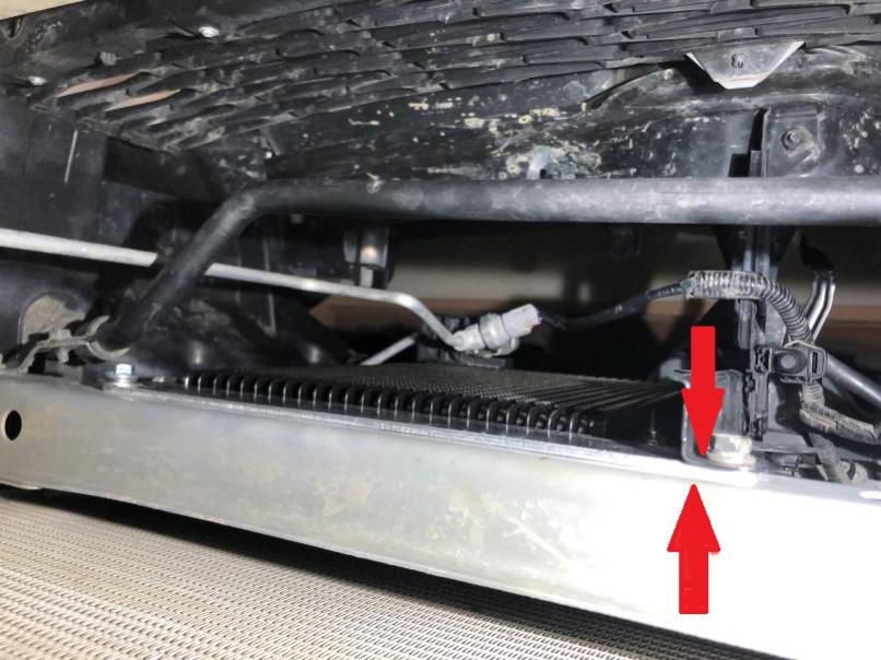

When installing the bracket and cooler, you can loosen up all four bolts of the hood latch and its support bracket. Or you can take a shortcut and just unbolt the lowest bolt of the vertical hood latch support bracket. Gently pry the support bracket forward to allow the trans cooler bracket to slip in. Use a center punch or similar to align the holes and thread in the bolt. Next thread in the trans cooler bracket's lower left bolt and then the upper bolt and spacer.

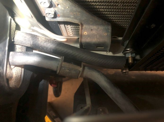

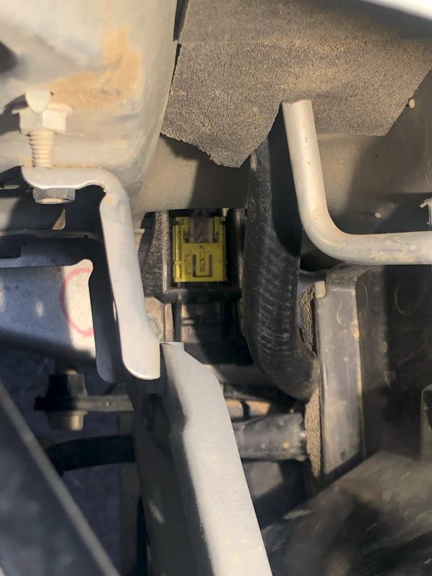

Once the trans cooler is installed it is easiest to feed the rubber hoses in from the engine bay towards the cooler inlets. The lower hose for hot fluid could use a sleeve to protect it from chafing on the edge of the port cut in the metal bulkhead. I used some clear tube I had around.
A picture is attached of the lower hose routing from the cooler, showing how it passes under the aluminum AC line. The upper hose must pass through a foam sheet and I used a razor to cut a "X" pattern to try to keep the air seal in place.

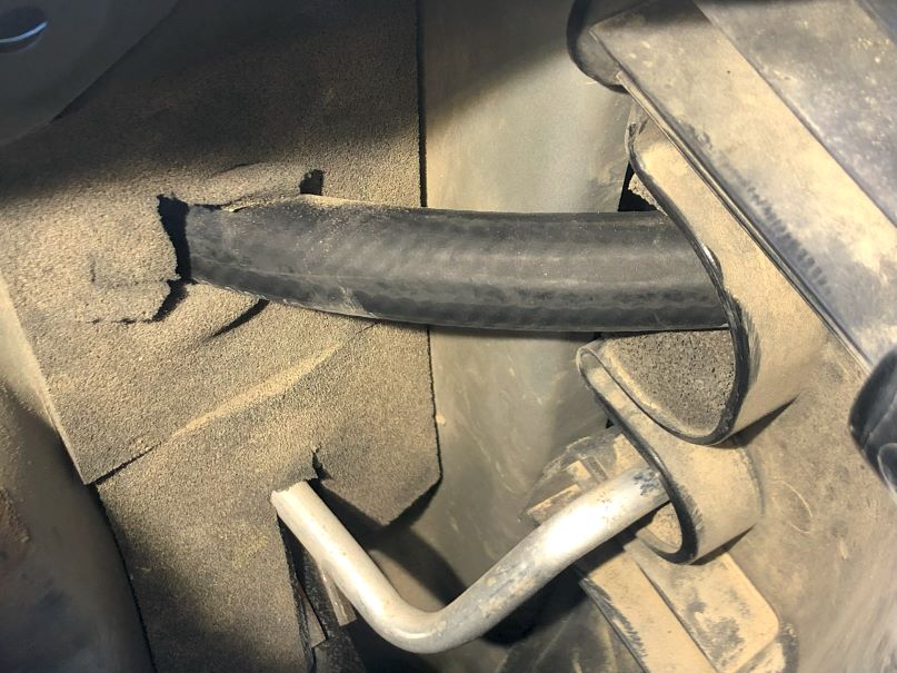

I was looking under the hood of my 4Runner and the hose from the radiator mounted transmission cooler runs along the base of the radiator, then turns and runs up the passenger side of the radiator before turning again and running back to the radiator.
To me (not a mechanic) it looks like the best way to route the hose to the new external transmission cooler would be from the cold metal tube near the top passenger side of the radiator to the external cooler, then from the external cooler using a union to tie back to the hose that runs to the transmission.
Is anyone else doing the above when routing theirs?

I'm guessing you didn't see all of the pictures I posted? Scroll back to message #41 and up and they may answer a number of questions.
The FJ's engine radiator mounting is different as are the openings available for hose routing. The best routing on the 4R is on the passenger side as the steel lines from the trans run along the passenger side.
In my install I ran both of the cooler's hoses together but in hindsight I could have run them differently and shortened them a bit. As I recall, one could have home-runned to the steel trans line and the other could have attached to the short steel line coming up from the radiator that you mentioned. The second short steel line can be capped off and abandoned in place. When I get the energy I'll go back and do all that.
The problem with the ideal routing is that it was near impossible to get my hand and a tool in there to remove the factory line clamp. I think a lot of other things will have to be unbolted to create access.
