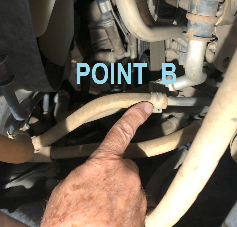

I saw your pictures, but I wasn't able to tell exactly how you tied into the system. I could tell that you ran your hoses to the passenger side of the radiator, but I was unsure how you tied into the system. Your post #43 made it look like you might have tied into the system the same way as the FJ Cruise.
Not sure if the following is clear, but my thought was to remove the current transmission cooler hose from the steel transmission cooler line near the top of the radiator. Then run a new hose from the steel transmission cooler line to the external transmission cooler, using top hole. Next, take the transmission cooler hose that runs to the transmission (that is no longer attached) and reroute it through the bottom hole with the A/C steel line. Finally, use a barbed hose union to add a length of hose so that I can connect to the cold side of the transmission cooler (if needed) and route the fluid to the transmission.

As I said in my last post, removing the hose from that line on the passenger side of the radiator is a PITA.
The problem with the ideal routing is that it was near impossible to get my hand and a tool in there to remove the factory line clamp. I think a lot of other things will have to be unbolted to create access.
Maybe a skinny long jawed set of needle nosed pliers might wiggle in there?

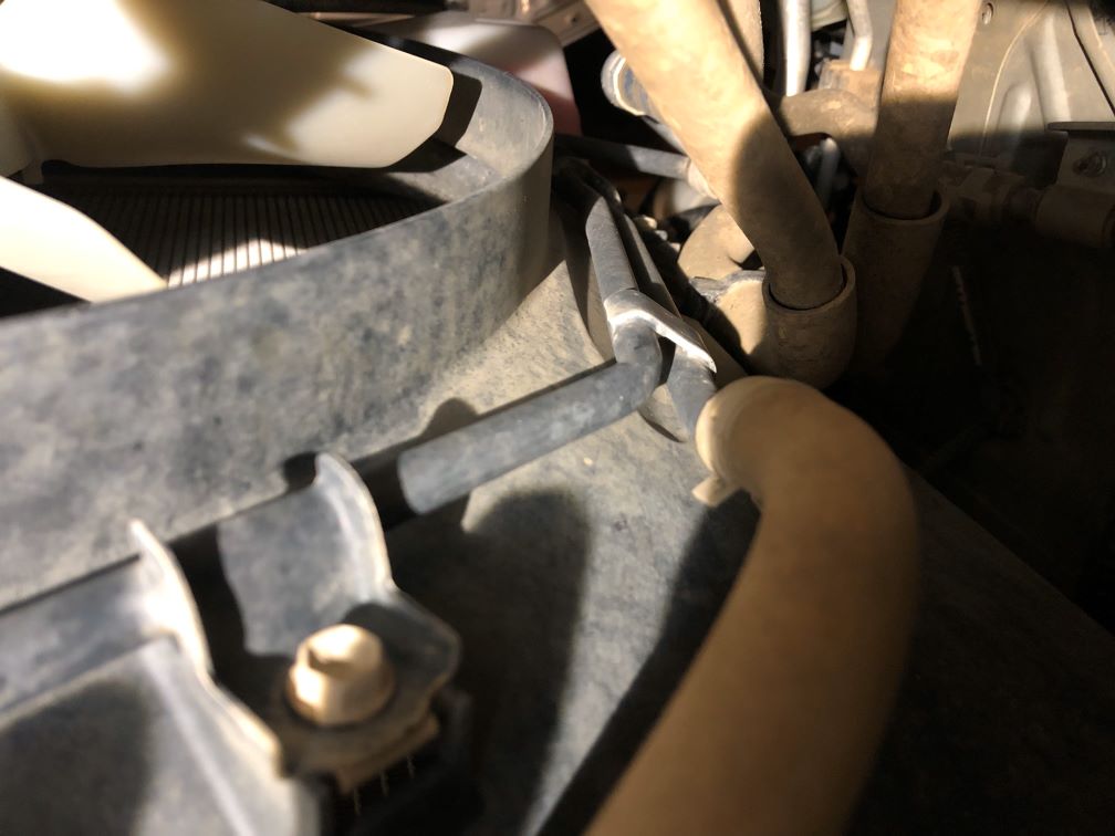

That Toyota spring type hose clamp locks open. I think I could get a set of needle nose vice grips in there to open it. I should be able to slide the clamp out of the way then. The slightly tricky part could be getting the hose off the tube.

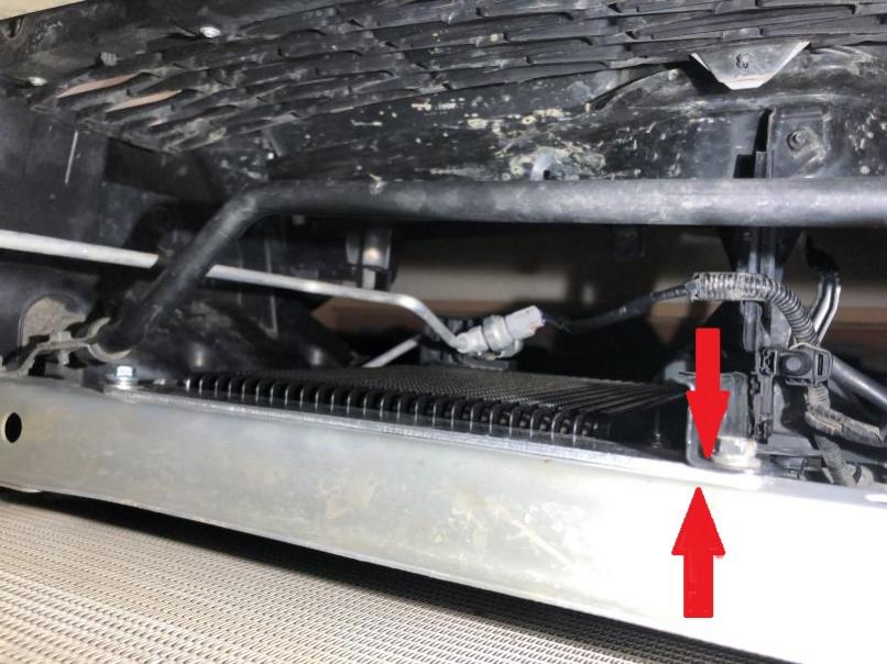

Your picture of this is what caused me to ask if the transmission cooler could be mounted to the other side. That bottom barb looks like it would have to contend with the radiator mounting bolt, but I couldn't tell for sure.
That picture you copied is of the first or second version of the bracket where I used a bolt and stack of washers to push the cooler forward to improve fitment and hose routing. After that the bracket was redesigned to achieve the new spacing.

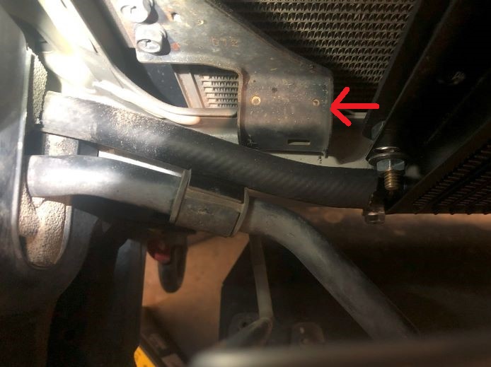

I originally shared the picture to illustrate how the hose was to be routed in front of the radiator mount and also the need to bend the power steering line bracket about 1/2" forward.
The problem I anticipate with your suggestion is the barb running straight into the radiator mount (red arrow) if the cooler is moved back. Can you estimate what sort of increase in cooling might be gained from moving the trans cooler back? Based on the numbers I recently posted in #45 the trans fluid is already significantly cooler.

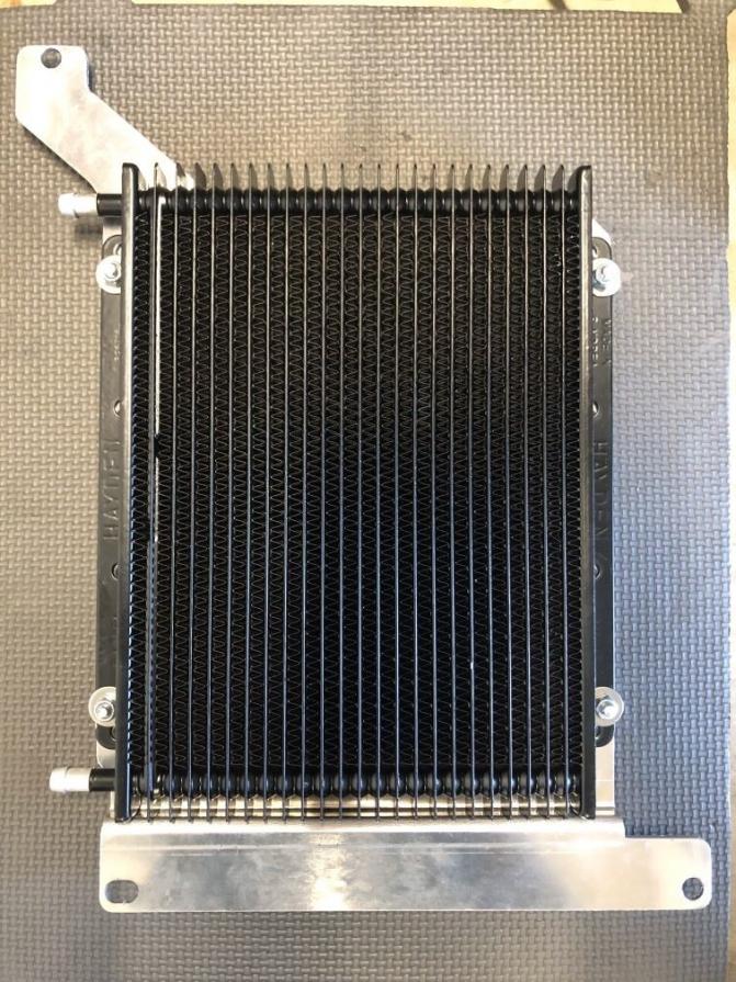

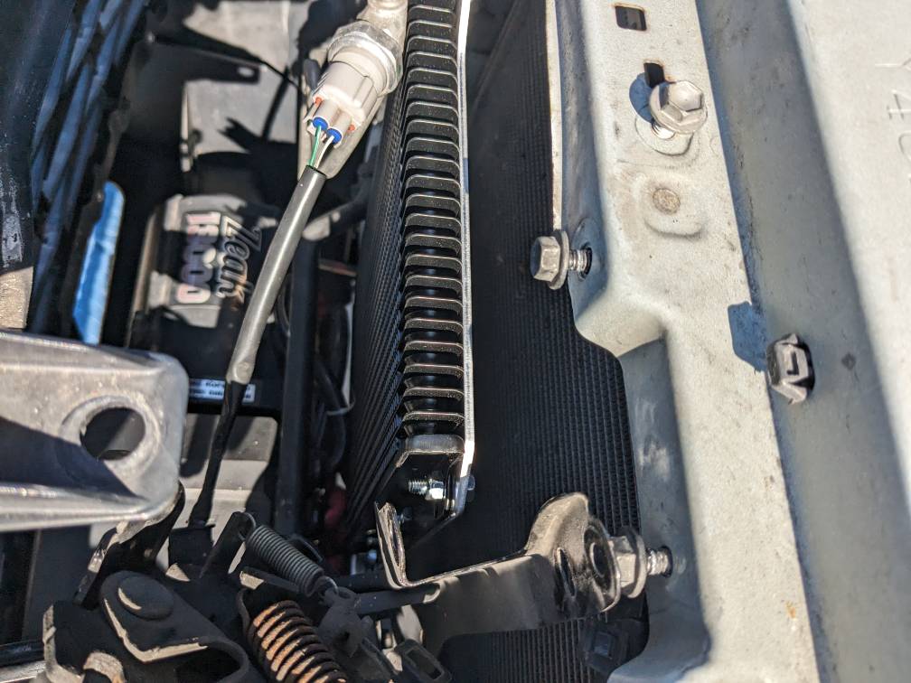

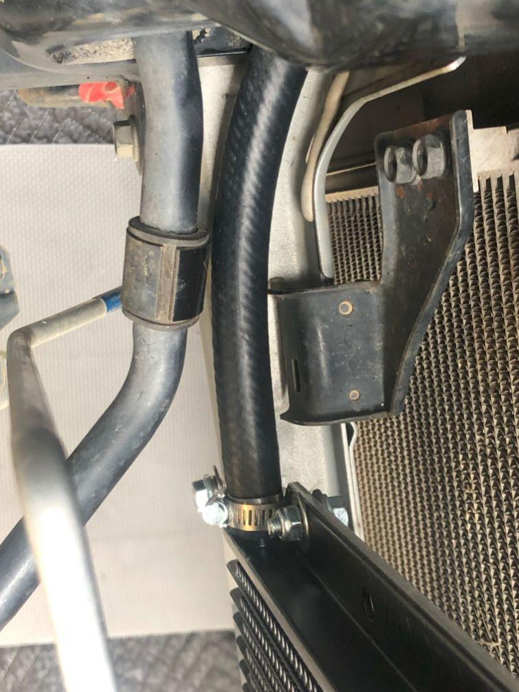

I went through my phone and downloaded all of the final install pictures. Some have been previously shared so there may be some repeats.
These include:
The cooler mounted on the bare bracket to illustrate the bolt locations as compared to the inlet and outlet tubes. The Hayden has lots of mounting holes so new ones could be drilled in the bracket.
The routing of the lower hose between the engine radiator bracket and the power steering line and bracket.
One with two opposing red arrows indicating how the new bracket fits under the vertical hood latch support bracket.

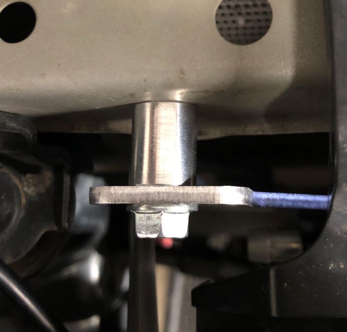

Illustration of how the supplied bolt spacer is installed

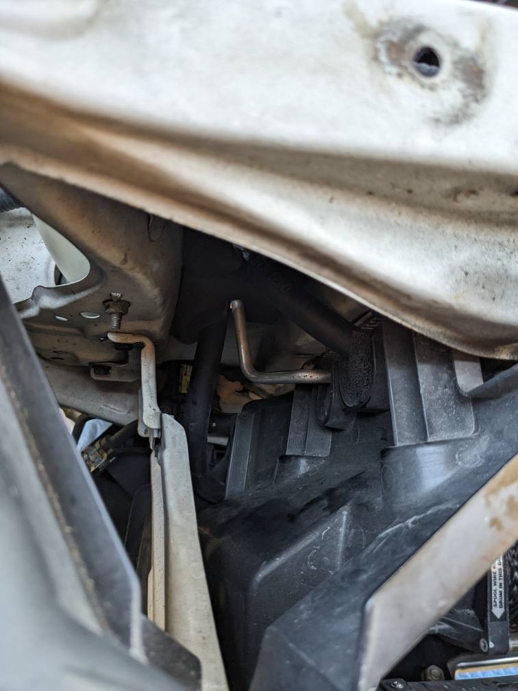

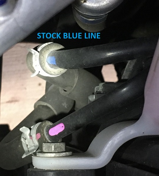

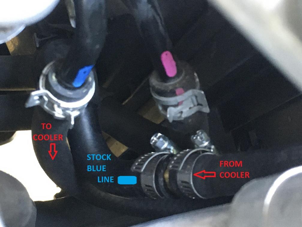

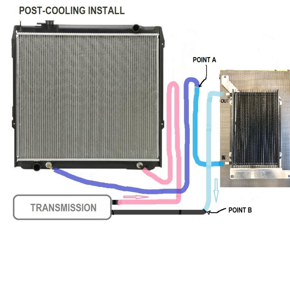

I am going to attempt to share how the hoses should be routed with a diagram that tries to capture the stock routing and the ideal way to insert the cooler. I'm sure I'll trigger as many questions as I am trying to answer!
The stock setup includes two steel "jumper" tubes that route from the upper corner of the engine radiator on the passenger side, then down to the lowest area of the engine radiator facing the engine. Toyota marks these with pink and blue paint at the higher point. The "pink" colored line remains unchanged. On the diagram the purplish colored line is the stock steel line that routes up to "Point A" where we insert the trans cooler.
I've read in a few sites (including Hayden's) where they recommend the trans fluid flows into the lowest point of the cooler and exits the higher point. Probably to create a "pool" of fluid in the radiator that rises upward and "overflows" downhill towards the transmission. That approach might force any air bubbles up and out such that the cooler is always void free.
The OEM "blue" line is where the cooler is inserted. I found a picture that I marked up where the OP used a union to connect one of the cooler's hoses to a line at I point I show as "Pint A". The easier option might be to just home run the cooler's rubber hose down to a point I show as "Point B" which is the steel tube running back to the transmission. This approach would leave the steel jumper tube capped off (abandoned) rather than use a couple and route trans fluid the extra distance.

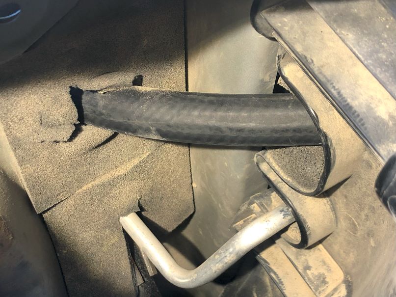

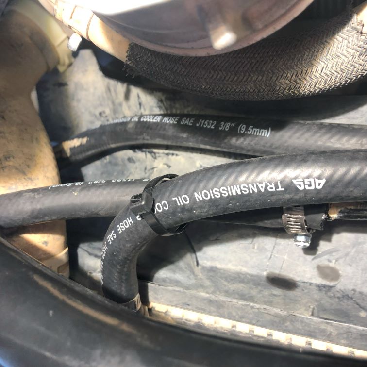

I also have a couple of pictures showing how the hoses route from the cooler and make a right angle turn through the foam covers on the mounting of the engine radiator. The lower cooler line is the one that routes beneath the steel power steering cooling line and passes above the yellow labeled sensor..

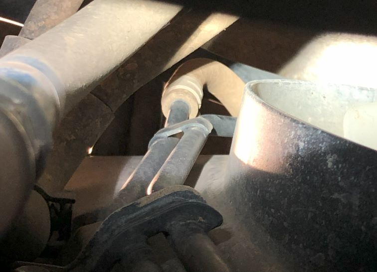

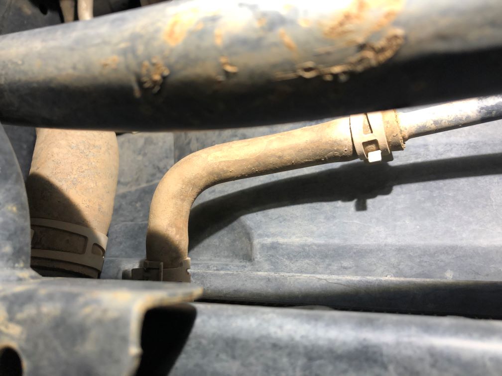

Here are what the stock steel "jumper" tubes look like

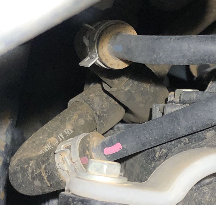

teotwaki,
I think you might have plumbed the cabling the way I was considering.
Are these the transmission hose/lines near the top of the radiator on the passenger side once the transmission cooler has been added?
410936d1712322309-trans-cooler-mount-need-kansas-5th-gens-new-product-fitment-new_blue-jpg
teotwaki,
From your below picture of the elbow hose exiting the radiator. This is the point on the FJ Cruise where people tie the transmission cooler into the system. I thought you tied into the system at this point.
410943d1712324091-trans-cooler-mount-need-kansas-5th-gens-new-product-fitment-img_8511-1-jpg

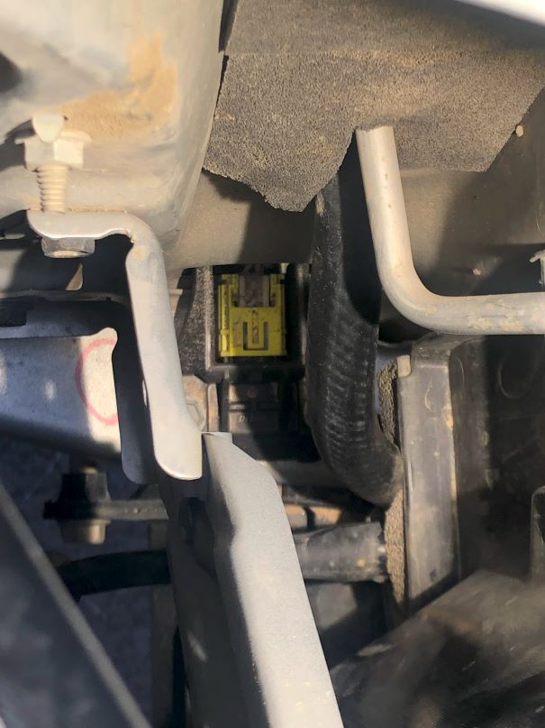

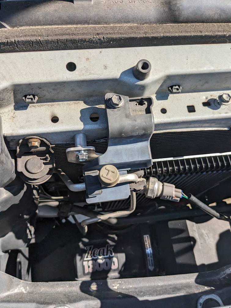

Installed my cooler yesterday. It was definitely a pain getting your hands in tight spaces and routing hoses in the engine bay but totally doable. Definitely ran into issues with spacing and mounting etc since I have a winch in the way. I had to modify the mount a little bit. I'm going to monitor it to see if there's any issues with rubbing etc. I think later on I will totally reverse the whole cooler on the mount and give it more room, but that's down the road.PXL_20240424_203525573.jpgPXL_20240426_153722775.jpgPXL_20240424_203529014.jpg
