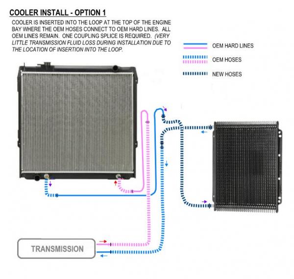

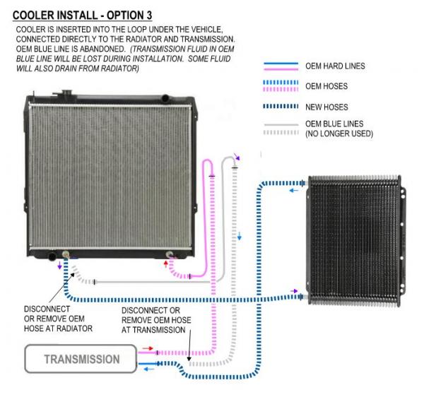

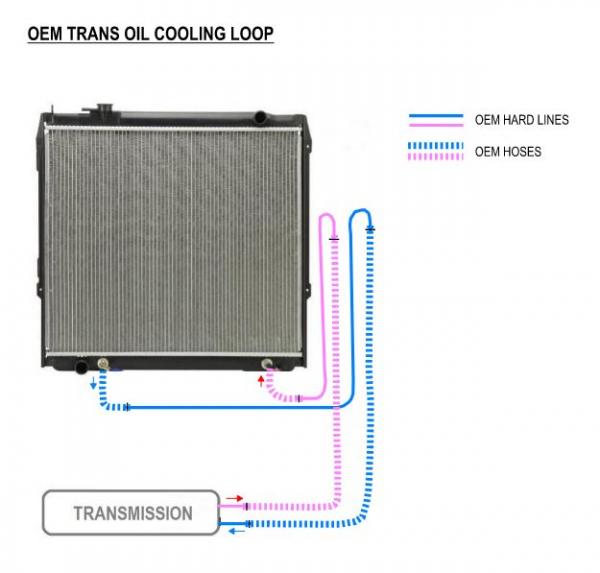

Between sketches here and youtube videos, it seems there are a few options. So taking all that info, I came up with some drawings based on other sketches in this thread that might help other noobs like me. Maybe I'm being paranoid, or just overly cautious, but I know trans fluid level is critical, and I'd rather not have to go through the drain/fill process right now.
So, after crawling around under the vehicle and looking at the various hoses and hard lines, here's my version of the sketches and options. Since I have not actually made my connections yet, the narrative on fluid loss during installation is only speculative. Comments are welcome and I can adjust the sketches as feedback is received. So have at it... let me know your thoughts...

GREAT drawings! You captured things well.
Let me know how hard it is to get at the top of the OEM hard lines if you go that route. It's a cramped space. I eventually want to go the route of abandoning one of the OEM hard lines and shorten one of my hoses

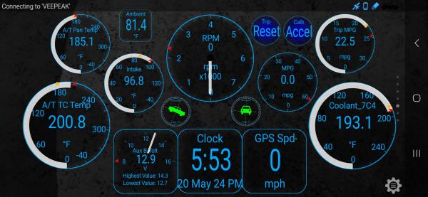

I have some baseline temp readings for future comparison. On my ~20 mile evening commute I would hit around 185f A/T pan temp and about 200f max torque converter temp.
zkengle-albums-trans-cooler-install-picture63229-torque-app-screenshot-evening-commute-no-cooler-installed-~20-miles-35-minutes-ambient-air-temp-81f-t-pan-temp-steady-around-185f-t-c-temp-max-around-200f.jpg

(Screenshots are from Torque app, connected to Veepeak OBDCheck BLE+ Bluetooth 4.0 OBD II Scanner. Ignore the avg mpg - that seems to calculate really high for my regular commute. Its fairly close for my camping trip, maybe just a little high.)
I'm still going back and forth on which option I'll go with. Option 3 seems like it would probably provide the least restricted flow, but I'm concerned about loosing too much fluid during the process.
So I think I'm leaning towards Option 2 right now - seems to be a good compromise with minimal risk for fluid loss. Still might even pour some fresh fluid in the hoses just for the heck of it. Obviously can't fill the whole cooler with fluid since it will be cold and the bypass will be open, but it seems like every little bit would help.

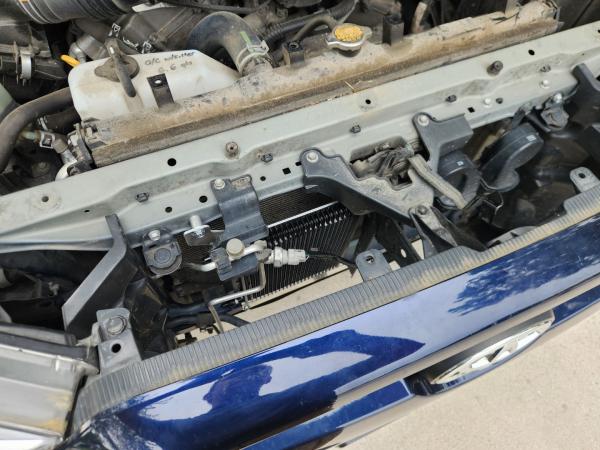

The bracket and cooler fit perfectly! I didnt have to pull the bumper - just removed the engine bay shroud to access the space.
I routed the hoses through the existing openings in the plastic shroud to the left of the radiator (looking at the front of the vehicle) and then turned them back towards the engine and through the existing openings in the sheet metal radiator support. It was a little tight trying to reach down in there and was at one point on top of the engine, but it really wasn't too bad at all. Literally the hardest part was manipulating the hose clamps.

Got my cooler in today. Kind of a pain to route the new hoses. I removed the radiator overflow tank to get a little better access. The hardest part was getting that edge protector stuff in the access holes.
Got my cooler in today. Kind of a pain to route the new hoses. I removed the radiator overflow tank to get a little better access. The hardest part was getting that edge protector stuff in the access holes. I added a half quart of WS through the return line to make up the minor amount I spilled and the volume of the cooler and hoses.
