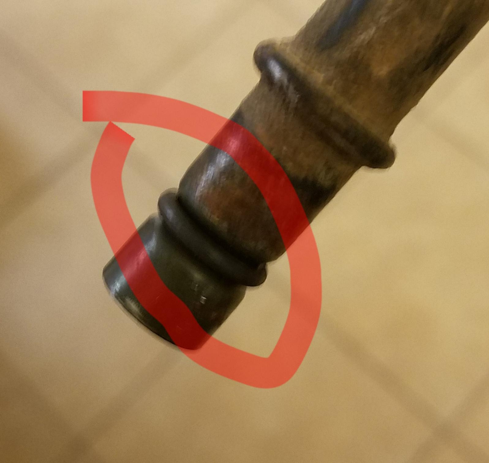

Yes. I just did this today(edit currently doing this) and there should be an o-ring on the top half of the trans dipstick tube that slides into the lower.

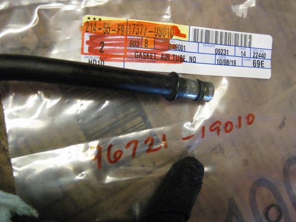

Is a special O-ring needed or just any O-ring of the correct size? I know some oils will deteriorate certain rubber compounds. A link to this O-ring would help too.
Is this it? https://www.amazon.com/Toyota-96721-19010-Engine-Dipstick-Tube/dp/B00KTJ8GY4
Or this? https://shop.advanceautoparts.com/p...ationPath=L1*14923|L2*15030|L3*16027|L4*12947
I hope this reply goes through with photo. Im not the best at formatting
That's exactly what I was hoping to see. Thanks much Salgood!
Edit: Here's another picture just for clarity and size context.
