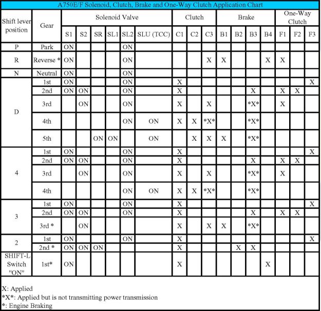

There is no solenoid that handles R and OD only (gears use different solenoid actuations to divert fluid to the correct clutch/brake packs)
The only items that I can see R and OD share without sharing with any other gear is B1

looks like you use s1 and sl2 solenoids on first gear and reverse.
