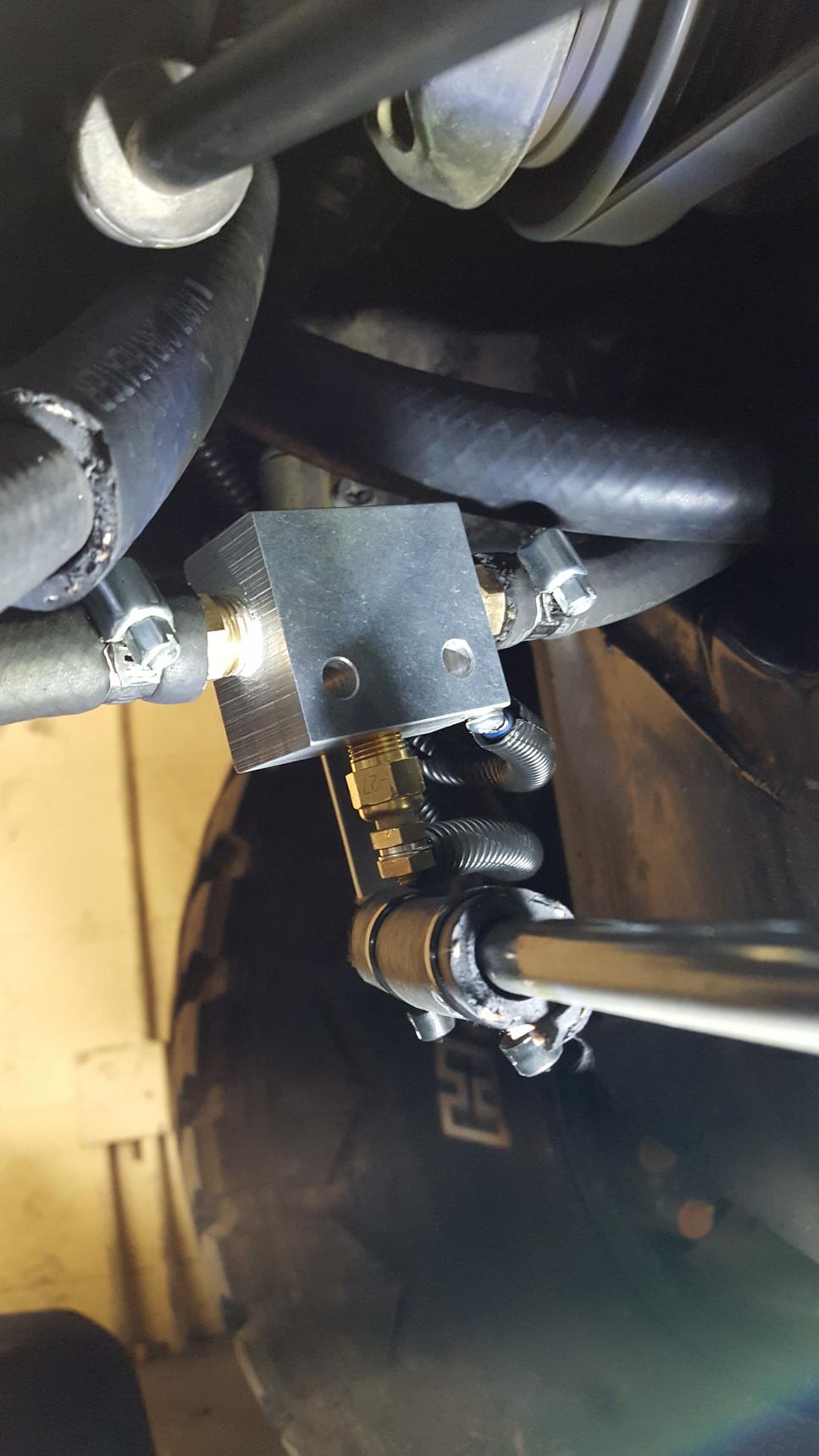

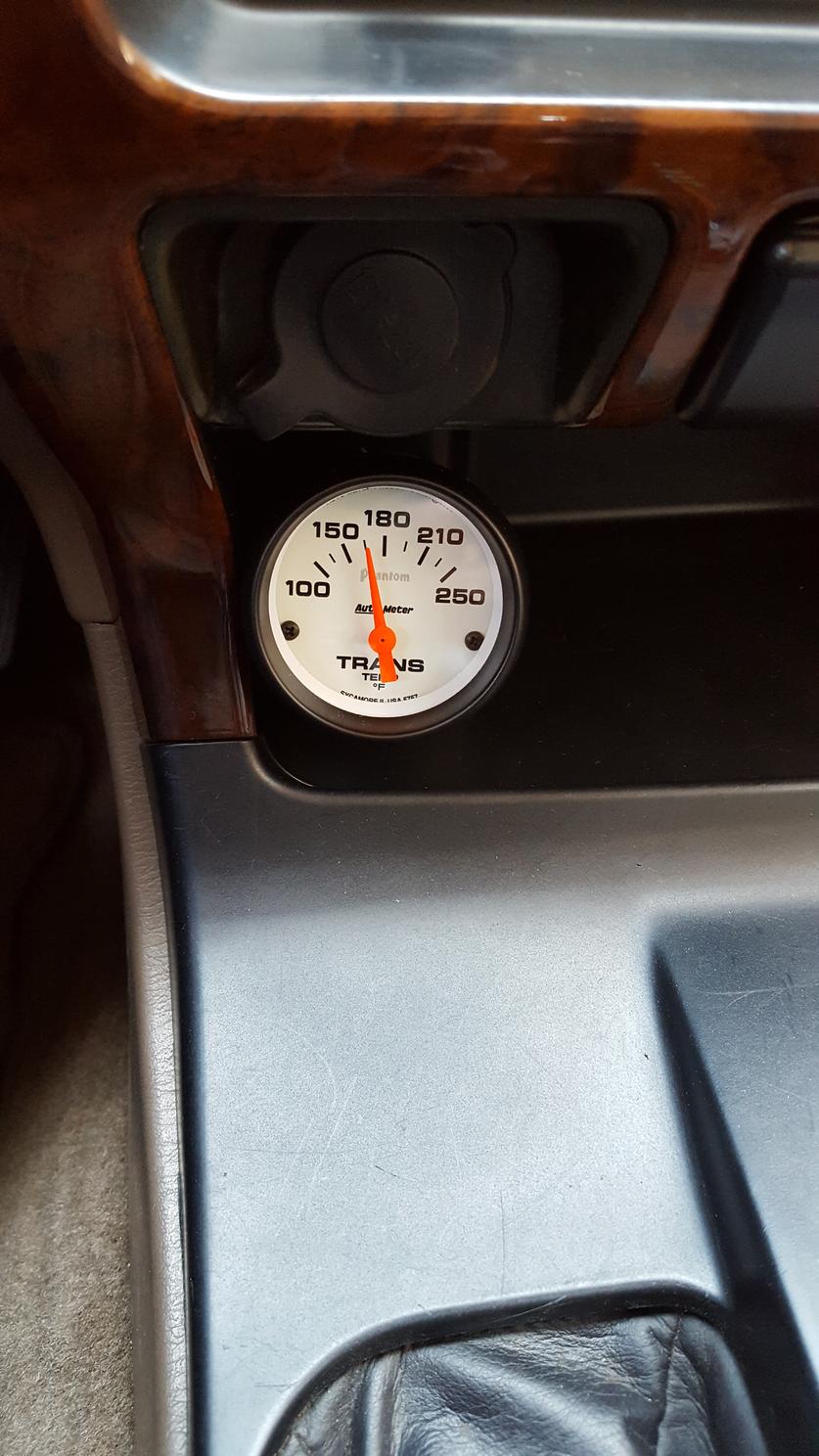

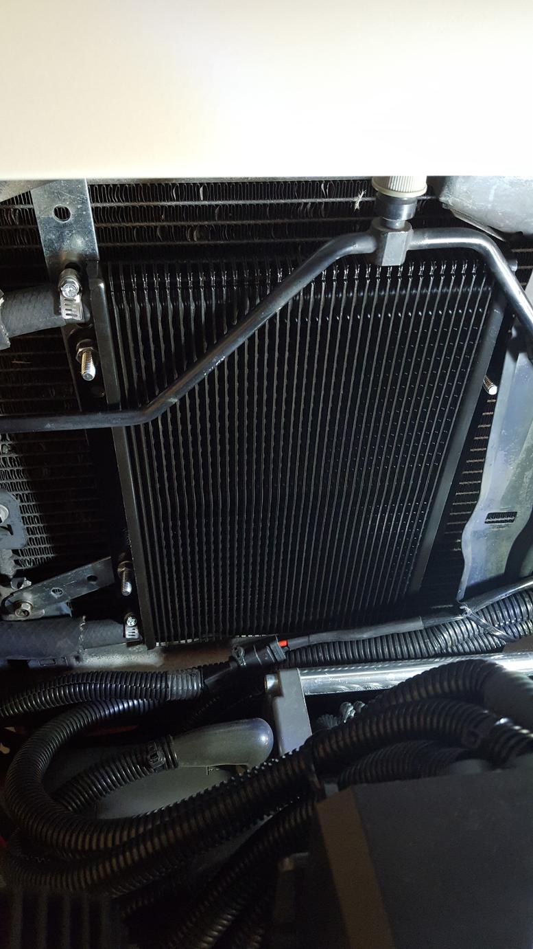

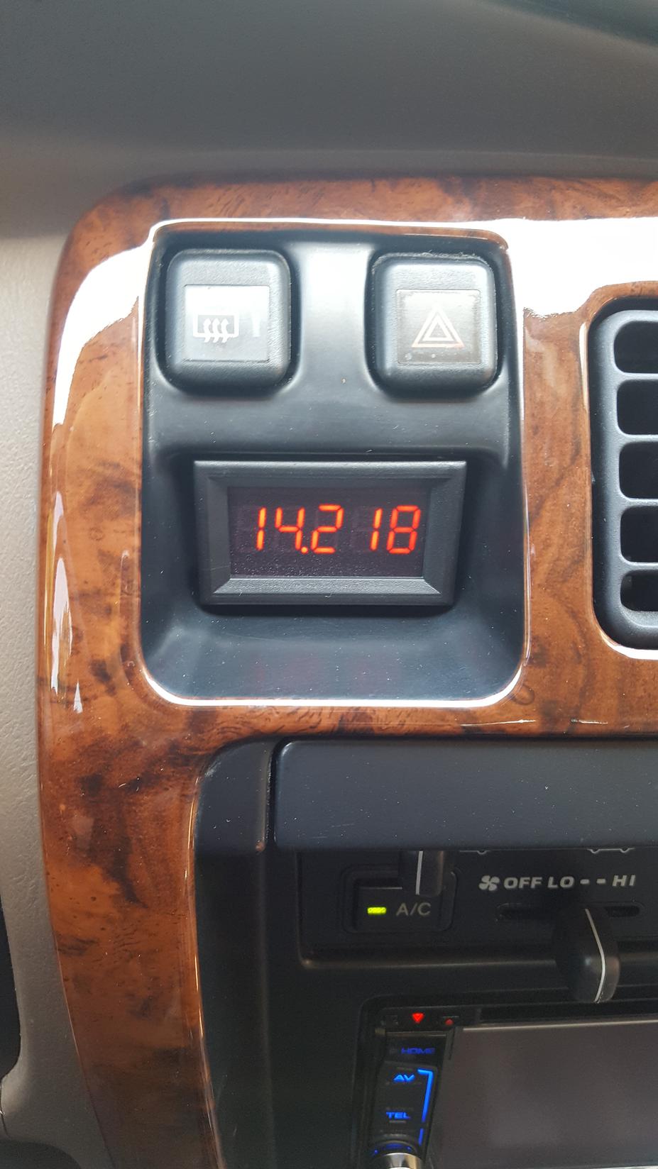

I just installed my B&M 70268 this weekend along with my temp gauge. I also ran it in series because my OEM Toyota radiator is less than a year old and I'm not too concerned about the "strawberry milkshake". I have a 98 so my torque app doesn't show trans temp but it definitely shows on my 01. That is why had to install the Autometer temp gauge.
After the install I drove it around town, up and down hills and freeways with my A/C on and it never got passed 180. The outside temp was in the 90s. Mind you I have 33s, front and rear heavy bumpers with a swing out and a winch. I don't ever plan on towing but my trunk is pretty loaded with stuff. The true test is when I drive up to Bigbear.
I wanted to do it "clean" so I purchased a temp gauge sensor manifold (Dakota Digital) with a built-in ground since the manifold was connected between rubber hoses. I placed the sensor on the line coming out of the transmission so I can see highest temp. On my 01, I can see that Toyota placed their sensor on the same line so it was a no brainer for me. I know there are a lot of debates on this subject on the forums but this is what I'm comfortable with. It worked like a charm. I'm a little OCD so don't blame me...hahaha. FYI, I run Amsoil ATF. I also installed a voltmeter in place of the clock since it doesn't work, the fit was perfect. Enjoy the pics.

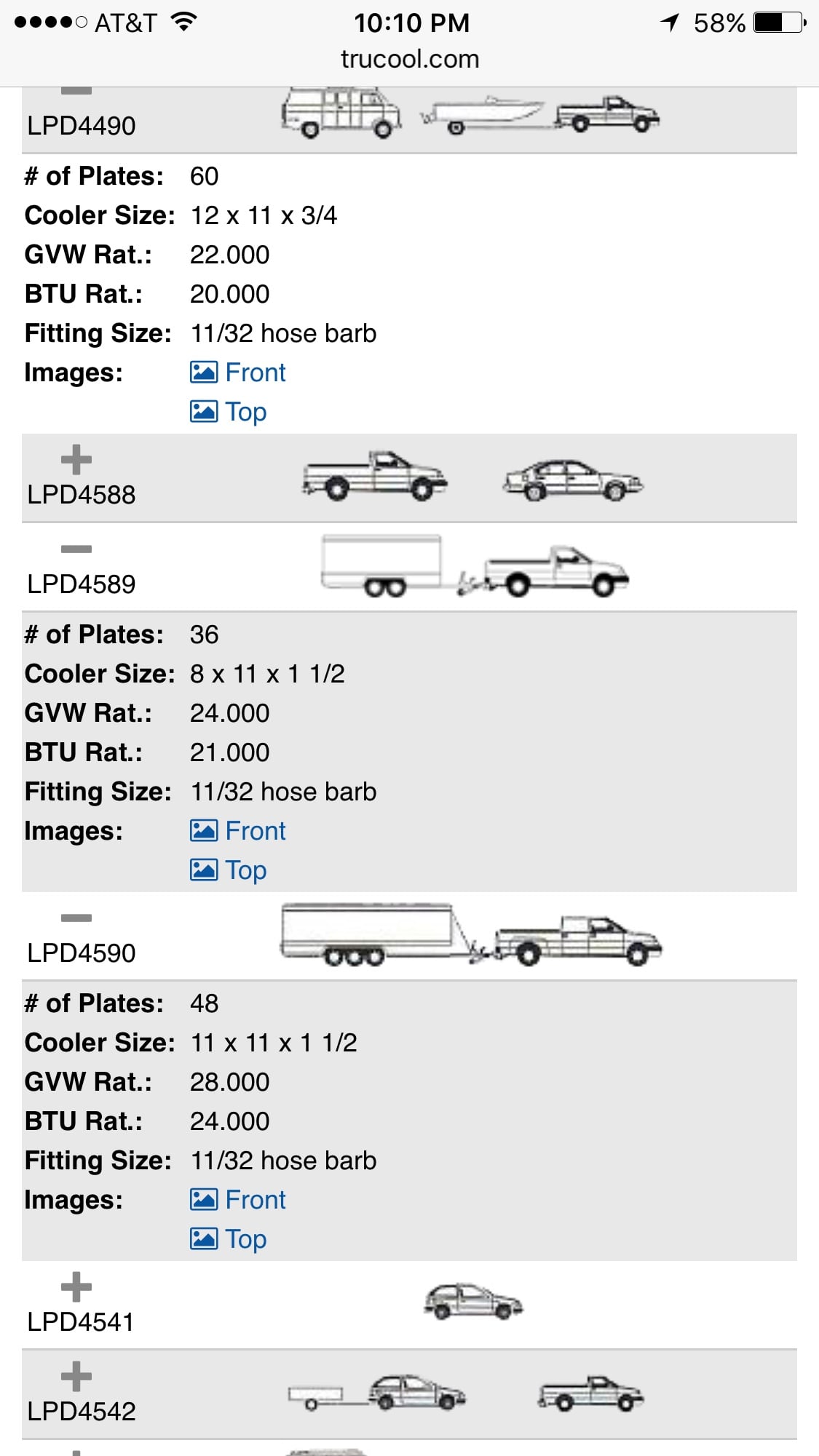

If your buying a low pressure drop True Cool get the 4589. It's got twice the rating and bigger than the BM everyone else has been installing. I installed the 4589 on the 97 Puppy Hauler. Worth it to get the larger cooler. It barely fits but is doable.

Forgive me, but what do you mean by "buying a low pressure drop"?
Oh and I thought of going bigger, but seems like the 4490 will fit easier (behind the middle bracket) and almost same cooling capacity. Any reason to go with 4589 vs 4490?
That's what the LDP part of the part number stands for. The cross tube flow thickness promotes kind of a temp regulator or internal bypass to try and prevent the fluid temps from going too low.
Here are the specs on the 3 you have in question. The 4490 is 12x11 but only 3/4" thick. I had no problem fitting the 4589 which is thicker at 1.5" and 8x11". Bigger is better. The air to oil coolers are not as efficient as the cooler in your rad you want to bypass. You should also install a temp gauge.

Thanks for the info. I already saw the specs and the 4490 is only 1000 btu less (20k vs 21k) than the 4589, which is why I'd get that one since it's easier to install. I may go with 4589 but that's really not a big deal to me. My main concern was whether to go with trucool or B&M, but from the sounds of it's a cointoss and I should just go with the cheaper unit.
