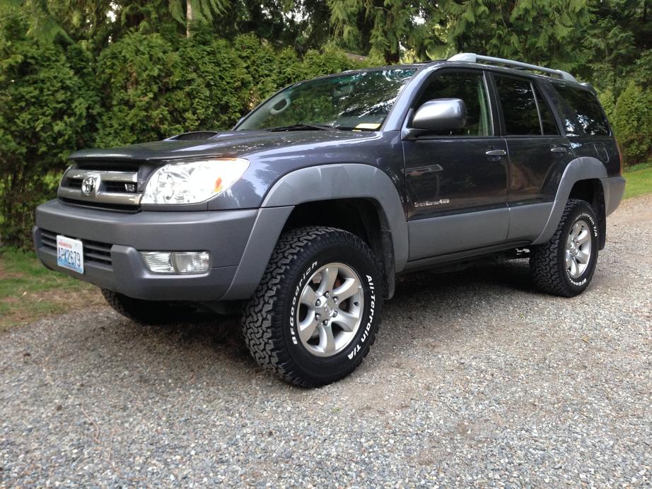

I think I'm gonna go for it and run the mobil 1. Thanks for all the input. I added a pic. Not enough 4runners on here with the gray cladding and blue paint. I must say I'm loving it more and more. When the 4runner first came out with the unpainted sides, I hated it. Now I own one and love it. Go figure.
