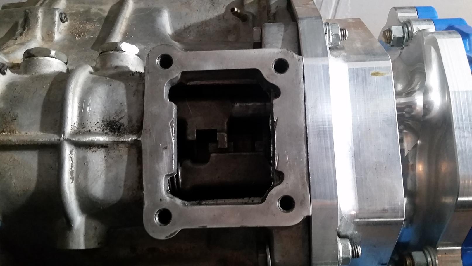

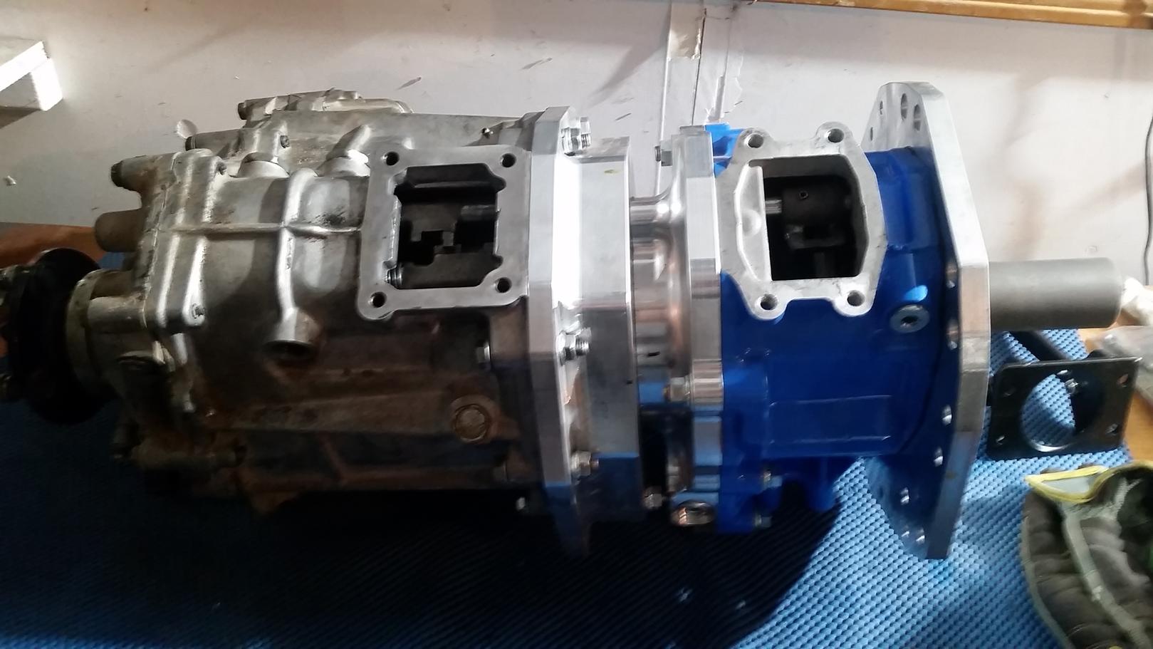

I'm in the process of installing an inchworm complete dual case, and having some issues.
I intially had trouble mating the reduction box adapter to my stock t case. There was about a 1/16" gap between the adapter and my t case. The adapter (by itself) would fit snug to t case (no gap), and the reduction box (without the adapter) would slide on with a gap equal measurement of the adapter plate. But bolt the 2 together and there is a gap. ???
After many texts back and forth to Lowrange offroad tech, he suggested I slowly snug adapter to T-case with the bolts. So I did, and was able to get adapter snugged up with very little torque (in fact I purposely used a 1/4" drive ratchet). But just as I set the ratchet down, I heard a loud pop (like a 22 rifle). I Looked everything over, couldn't see any damage, or cracks. But I couldn't get the output shaft (splined shaft coming out of reduction box that will mate to transmission) to turn, and I couldn't get t case shifted out of 4lo. The shifting rods seemed to be seized.
So I seperated the reduction box (with adapter) from my t case and pulled the back off the T-case, expecting to see broken parts, but all looked ok. Keep in mind I'm a rookie at this, but there were no pieces or parts floating around. Everything was intact. In pulling the back off the t case, it seemed to free up shifting rods. I was able to move them in and out. So I put the t case back together and shifted (manually moving shifting rods) it into neutral. Then reinstalled the reduction box (with adapter plate) and it slid right in place, no gap. I tested all the gears (in both cases) on my bench and all seemed fine.

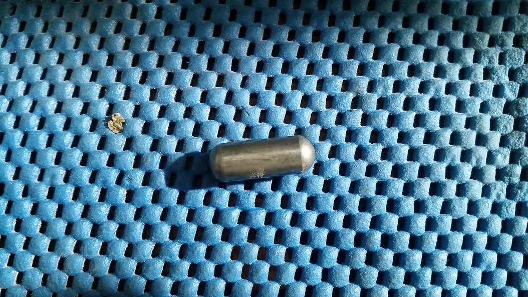

But, as I was putting the t case back together I found this little 'pin or bearing'(?) on my bench. I had cleaned my bench beforehand, and am almost certain it wasn't there before.
I temporarily installed the assembled dual case in my truck, to make sure everything fit. Which it did...barely. I removed it last night and started to install my Radesigns triple sticks, and was making sure I was able to shift into all the gears. All of that worked fine, but when I put it in 4lo (stock t case), and can not turn output shaft again. It turns in 2wd, and 4hi.
Any idea why I can't get output shaft to turn when in 4lo?
Does that part ('pin or bearing') look like it came from my t case?

That pill is part of the lockout between the shift rails on the stock transfer case. I twin sticked mine and that was one of the items that has to be removed in order to make the shift rails run independent of each other. I used this write up when I did the twin stick....

Looking at your pic, something doesn't look right on the right side shift rail. Specifically where the shifter goes. It should be a square notch, but yours looks like its broken or something. I'm not at home right now so I can't send you a good pic, but if this link works you can see how both shift rails have nice little square notches in them. This is mine right after I did the mod to twin stick it.
images
On a second look, it looks like that right side shift rail (2wd/4wd) is to far forward, you shouldn't be able to see the spring at the rear. If it came to far forward the pill may have fallen out of its hole when you had it apart. Now the case could be bound up internally.

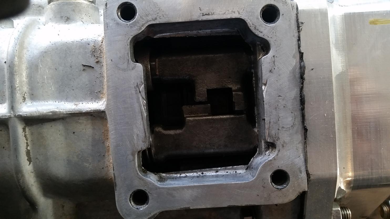

Here is close up pic (another crappy cell pic). I'm sure my shift rails are not chipped or broken...just a bad pic.
So do I need to reinstall the pill? I'm using Radesins triple sticks. The 2wd and 4hi seem to work as they should. Not doubting what your saying, just trying to be clear.
Is that what they call the interlock pin?

Sorry man, been at work then home dealing with the kids. Your right, the shift rails look normal from that angle.
These cases do have those flat keys in them, and they have to be installed correctly or they will cause things not the work properly. It took a little finesse to get the 3 of them in the right place and get the collar slid over them at the same time. I had to do it a couple times when I was playing with it, they can "pop out of place" but not necessarily fall all the way out. You need to make sure the shift collar can slide back and forth over them all the way or they will cause things to bind. That make any since?
I think you need to take the case back apart, sounds like something isn't sitting in there correctly. Also if your not "twin sticking" the case internally, I would put the pill back in.

Leave the pill out. As stated, that pill needs to be removed if you're running twin/triple sticks. No worries there [emoji1360]

x2 just got on and saw this. the info your getting is absolutely correct. pull it apart and make sure nothing is broken, but definitely leave that interlock pin out. Better to find out now than when you have it all back together and filled with oil. It's a pain to get it done but the result is one of the best mods you will ever do.
