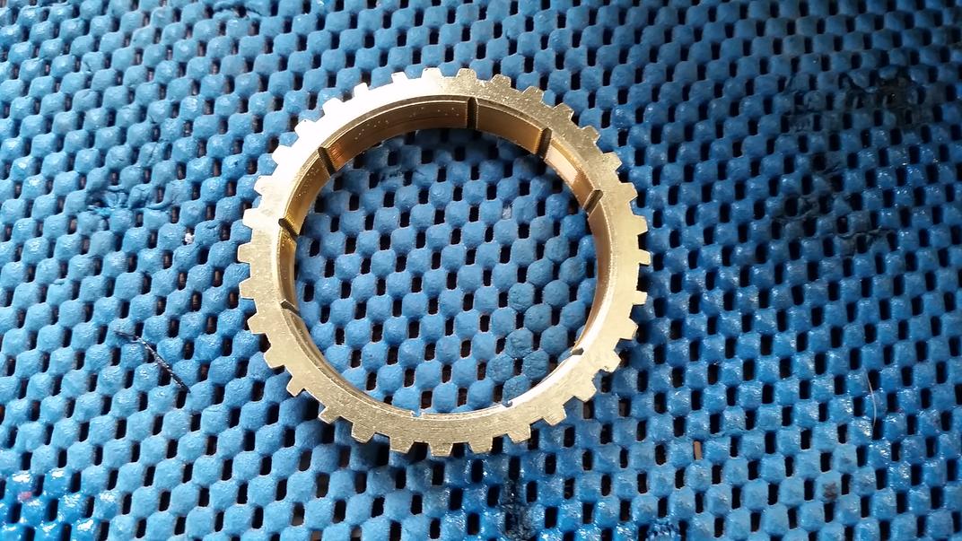

Does this 'ring' just sit on the shaft? It was not attached to the gears, or shaft or shift rails...anything when I took the case apart.

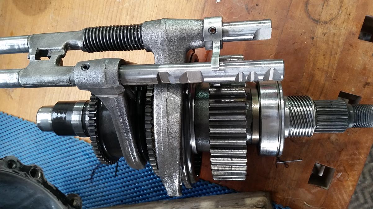

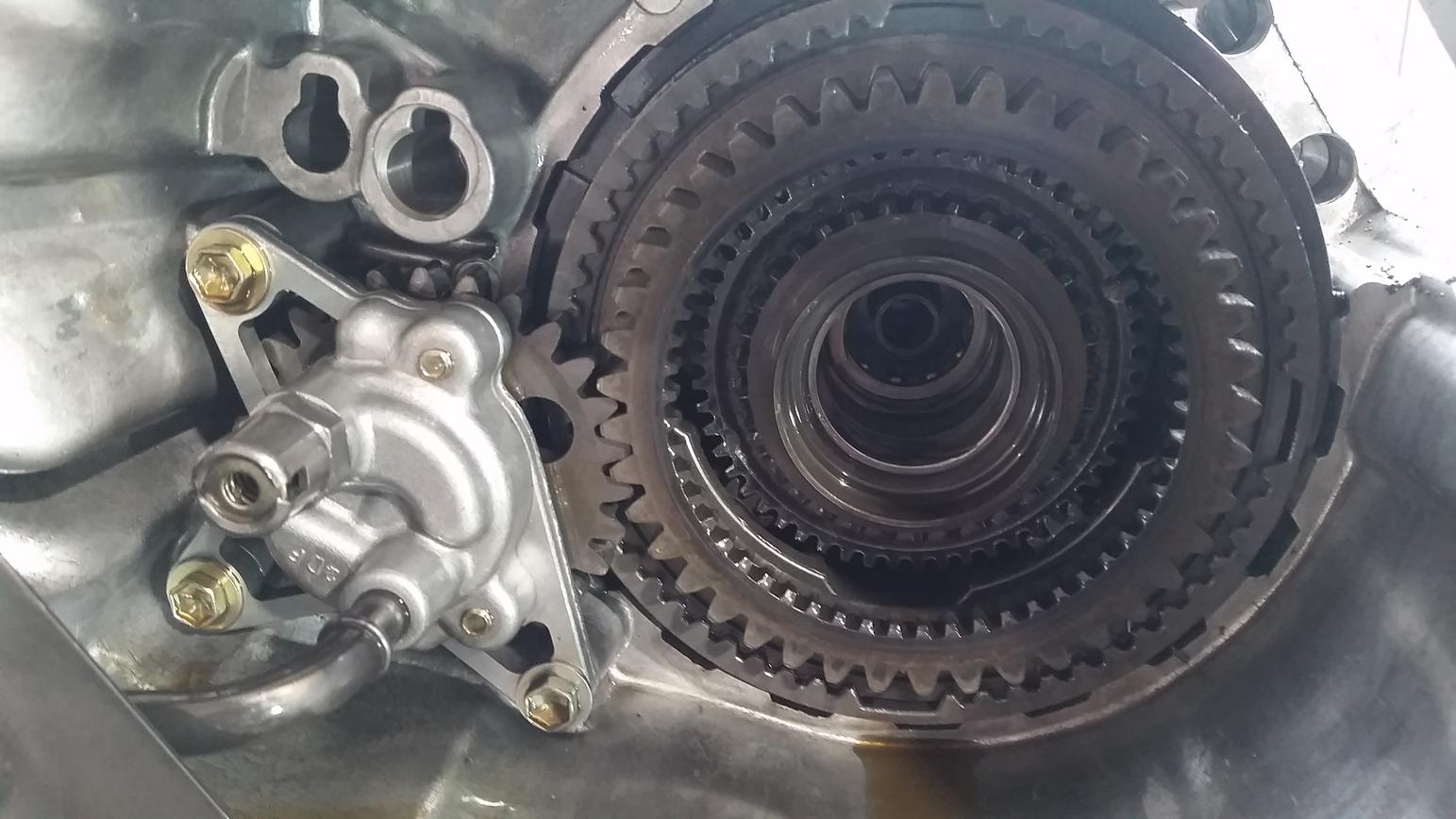

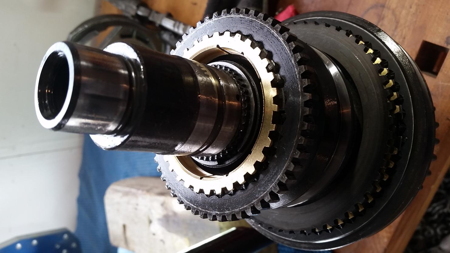

I got my t case disassembled. I can't see any damage to any parts. Everything looks good to me (rookie). Please take a look at my (HUGE) pics and let me know if you see anything out of place or wrong. I really want to get this put together and in the truck.

I tore the t case apart last night (sorry again for HUGE pics), and inspected everything. I couldnt find any damage, cracks or anything that looked out of place. So I put it mostly back together (didn't attach extension housing and front and rear flange) and I didn't put any FIPG on...this was a dry fit. I tested it in every gear configuration and they all worked. I was so stoked. My wife and I were taking my son and daughter in law to dinner, so final assembly had to wait.

The Gold ring is a synchronizer. It helps two spinning pieces come together. I believe it just floats in there.

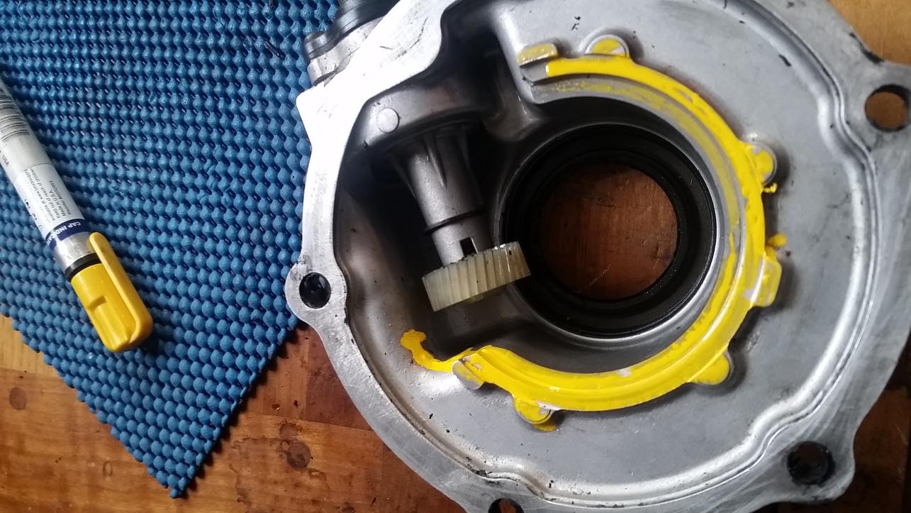

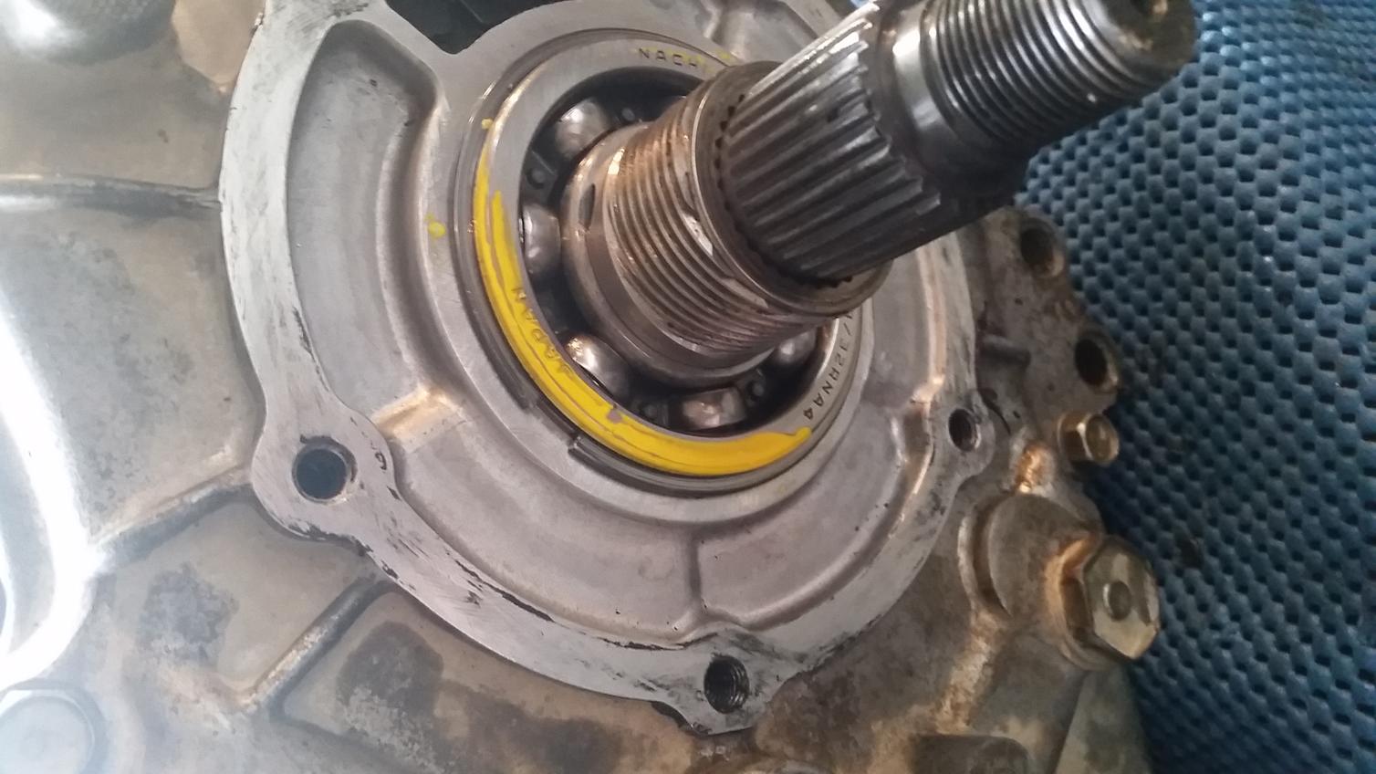

The pics show where ext. housing is contacting t case...on the bearing. ?
Why would this prevent rotation of shaft, and why only in low range?
