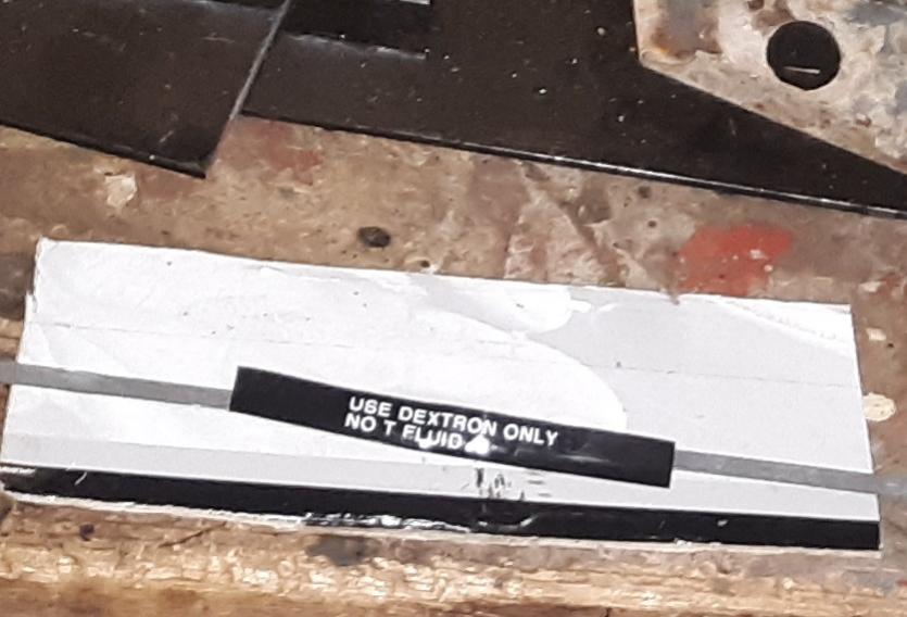

Phattyduck is 100% correct on the fluid. There are 2 or 3 tech bulletins out there as to not use T fluid in the 3rd Gen transmissions. I glad I used a dextron. However, I seen posts of people use it. Majorly big no no and will probably cause the transmission to slip. :[
I believe he was trying to say the word is spelled "Dexron"; not "Dextron". It's a common misspelling and pronunciation mistake. I've done it myself.

I can't spell so you got me :D.. They made a mess out of the fluids as they say all transmissions after a certain date. Then you see these Technical bulletins excluding certain transmissions etc. Valid points you have.. :-)

On Serious note: The late model Gens says Dexron II or III while the earlier gens say Dexron II
I included the TC003-99 Technical bulletin That is very Clear that we need to stick with Dexron Fluid
