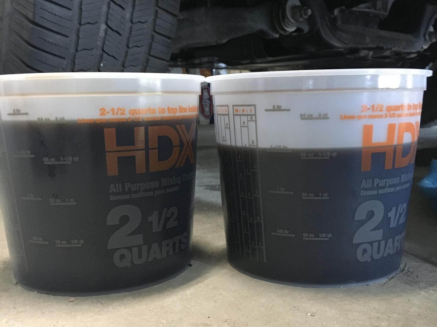

If you don’t have a 5qt then you can do what I did.
I got two 2-1/2qt paint mixing buckets from Home Depot because they were out of 5 qt.
Open the check plug and you will get about 1.5 qts.
When that stops dripping, open the drain plug and get the rest, about 2 qts.
Replace the check plug and drain plug. Use the old gaskets. Flat side against the screw head.

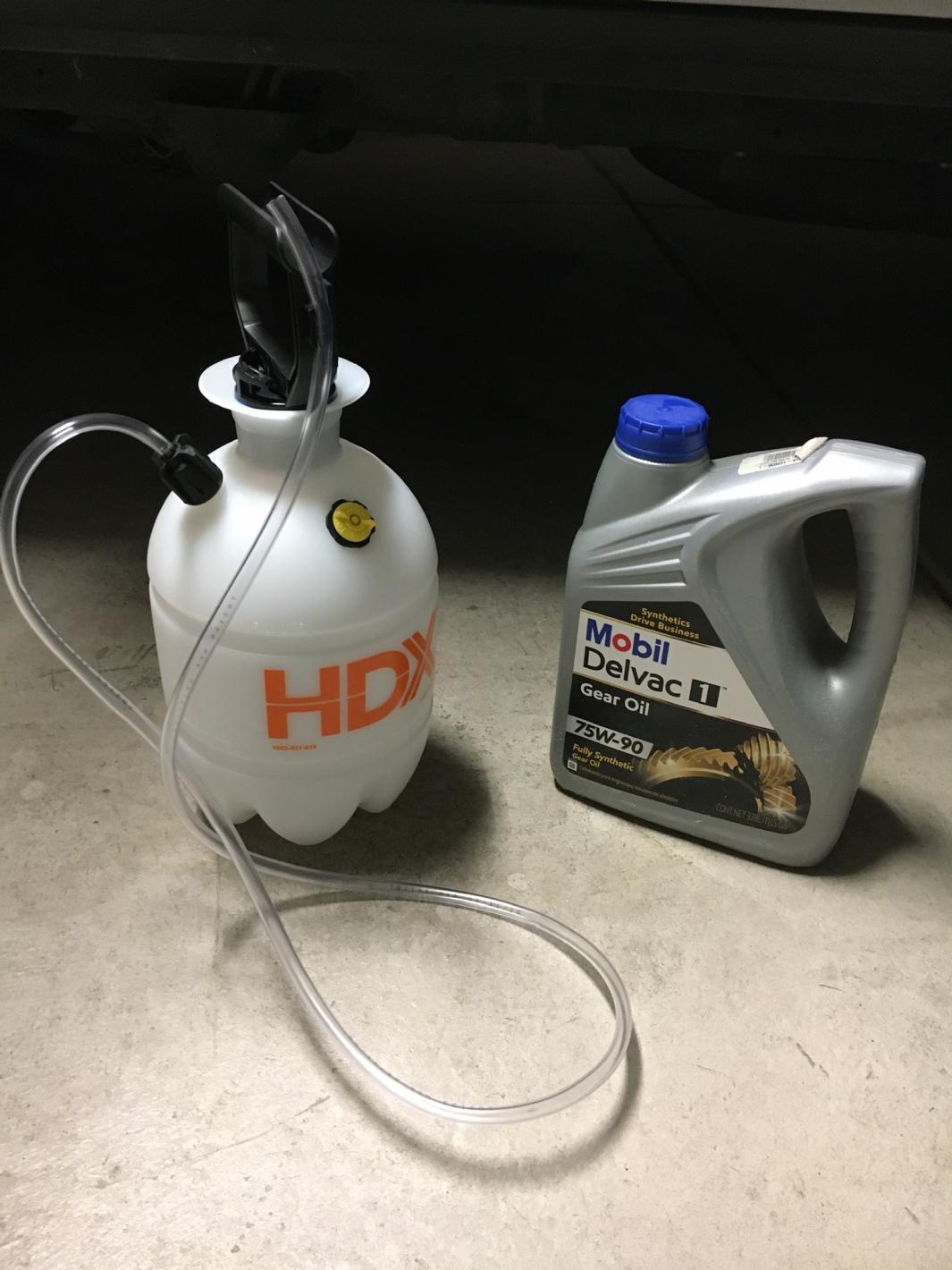

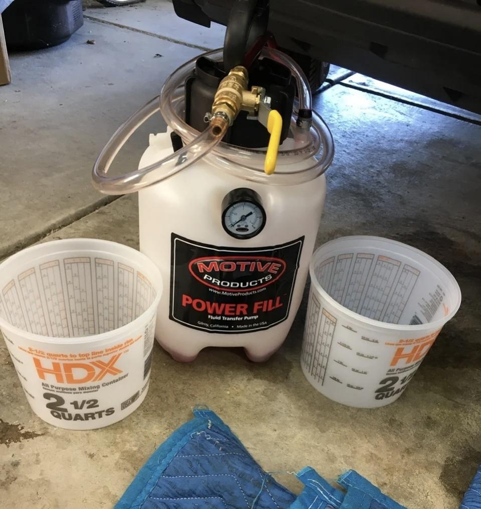

Recommended:
Get a Motive power fill.
...or make you own from a Home Depot garden sprayer.
I just made one of these and tested with water but not yet with oil. I’ll be using it for diffs.
Here’s a vid on how to make one.
How To : Make a Pressurized Fluid Dispenser - YouTube

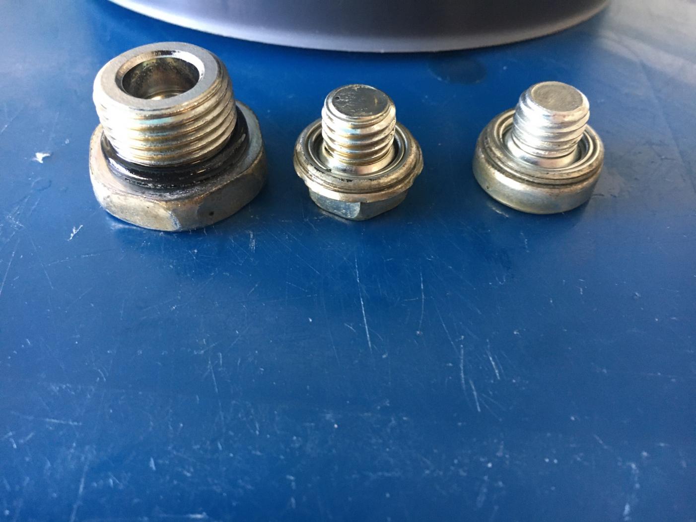

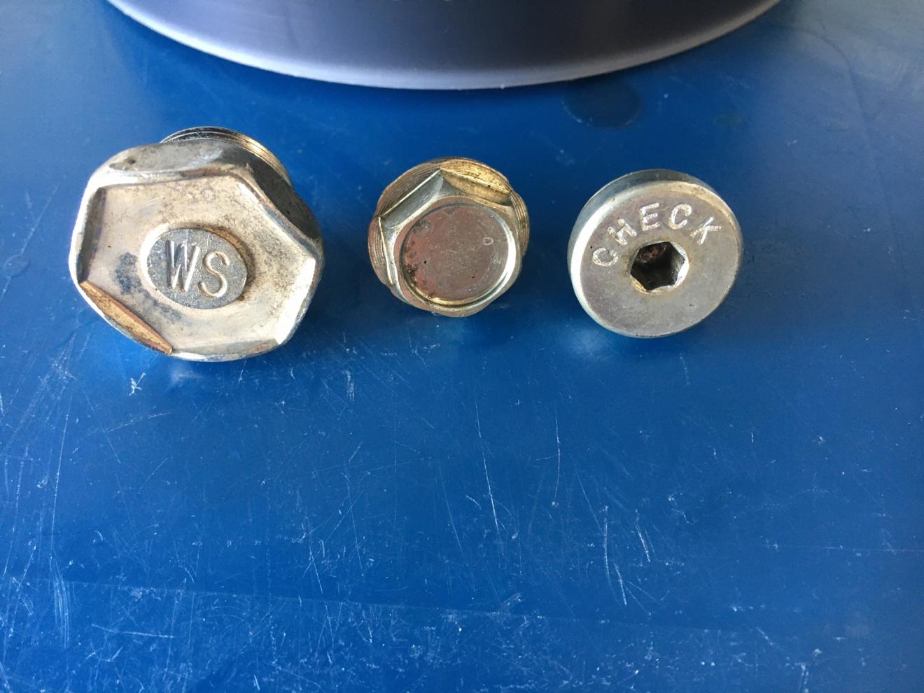

Torque specs:
Drain plug - 15 lb-ft (14mm)
Overflow plug - 15 lb-ft (5mm hex)
Fill plug - 27 lb-ft (24mm or 15/16")
Parts: (I pulled this info from someone else’s post. Sorry I can’t remember who’s.)
4 to 12 qts Toyota ATF WS fluid - Toyota part # 00289-ATFWS
Drain plug gasket - Toyota part # 35178-30010
Overflow plug gasket - Toyota part # 35178-30010
Fill plug gasket (rubber O-ring) - Toyota part # 90301-15004

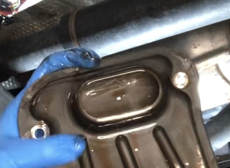

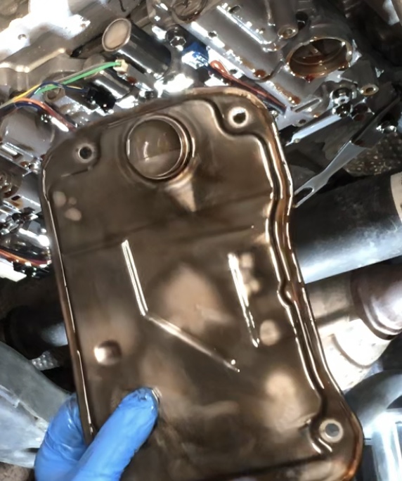

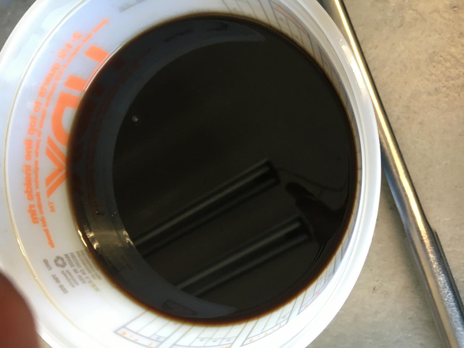

Oh, the fluid in the pics has 111,000 miles on it. It’s dark but smells fine and is not gritty at all. Nothing much was left at the bottom when I dumped it.

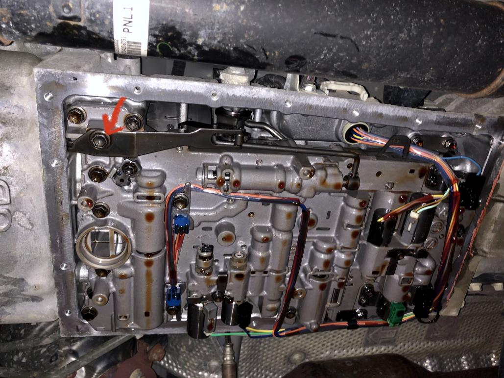

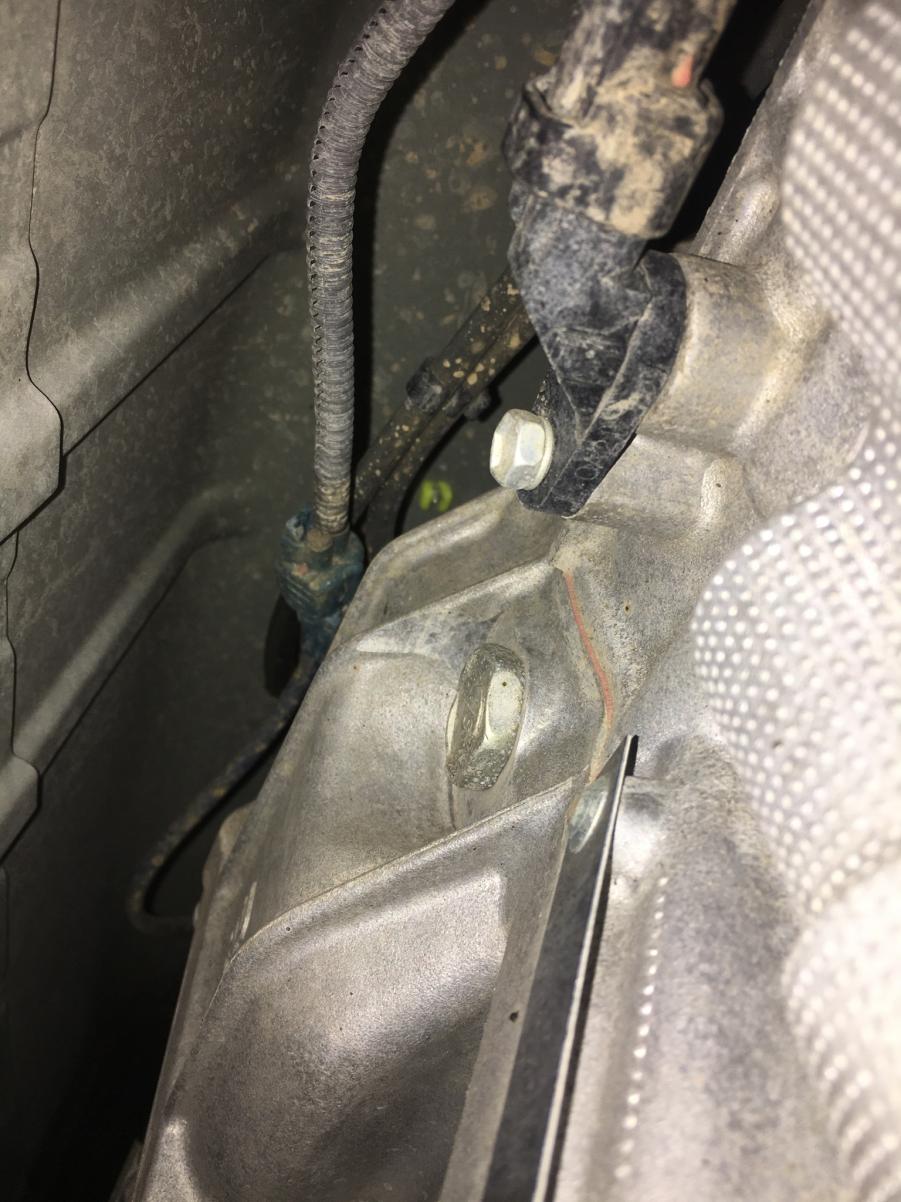

I am changing the transmission fluid and filter in our 2015 4Runner. I accidentally loosened the 10mm bolt right next to one of the filter bolts and am hoping someone knows the torque it needs to be re-tightened to. It’s the one in the attached pic with the red arrow. Thanks!

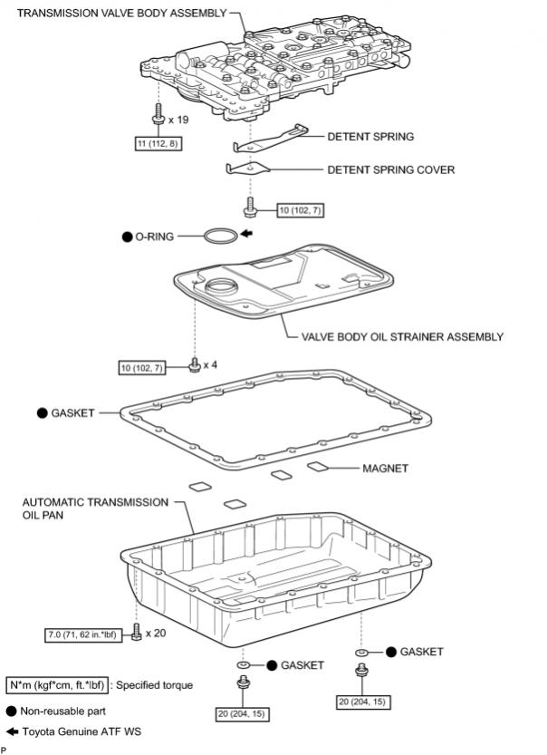

I accidentally loosened the 10mm bolt right next to one of the filter bolts and am hoping someone knows the torque it needs to be re-tightened to. Thanks!
That bolt assembles the detent spring and detent spring cover. The torque is 7 ft-lbs (84 in-lbs) per the following image.
