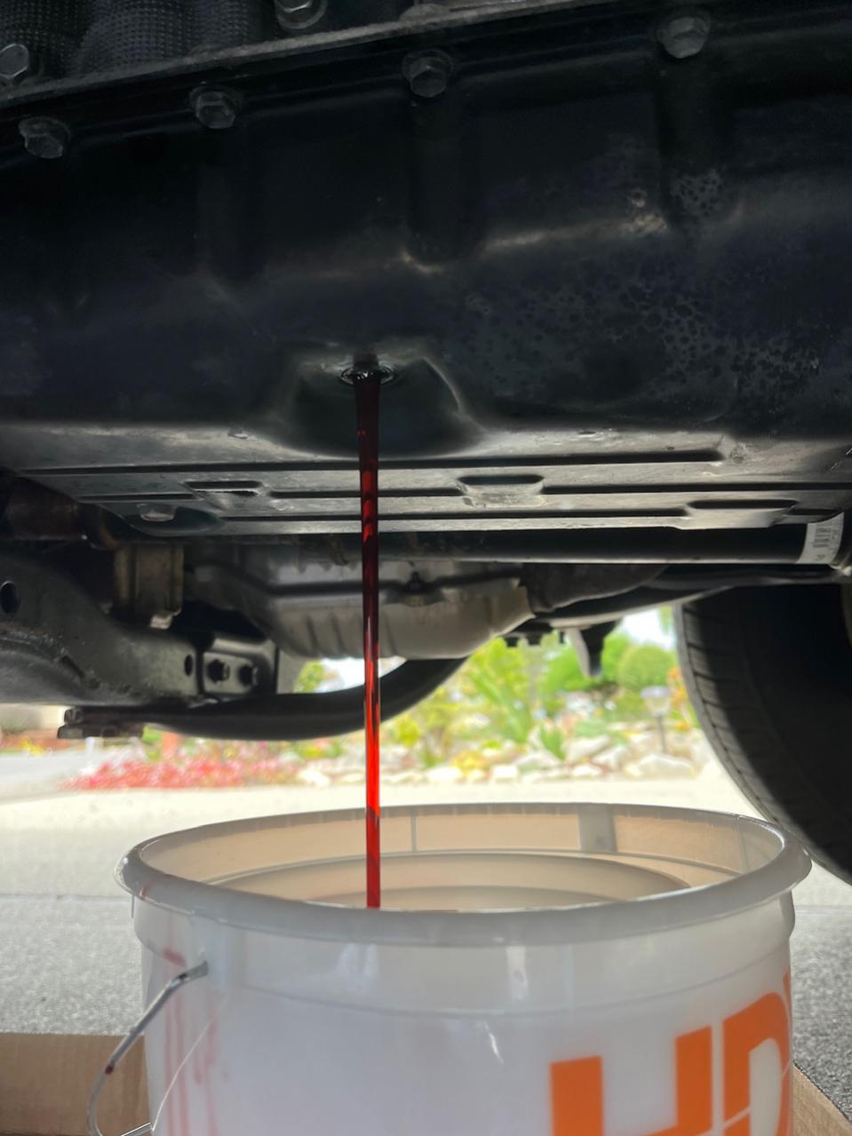

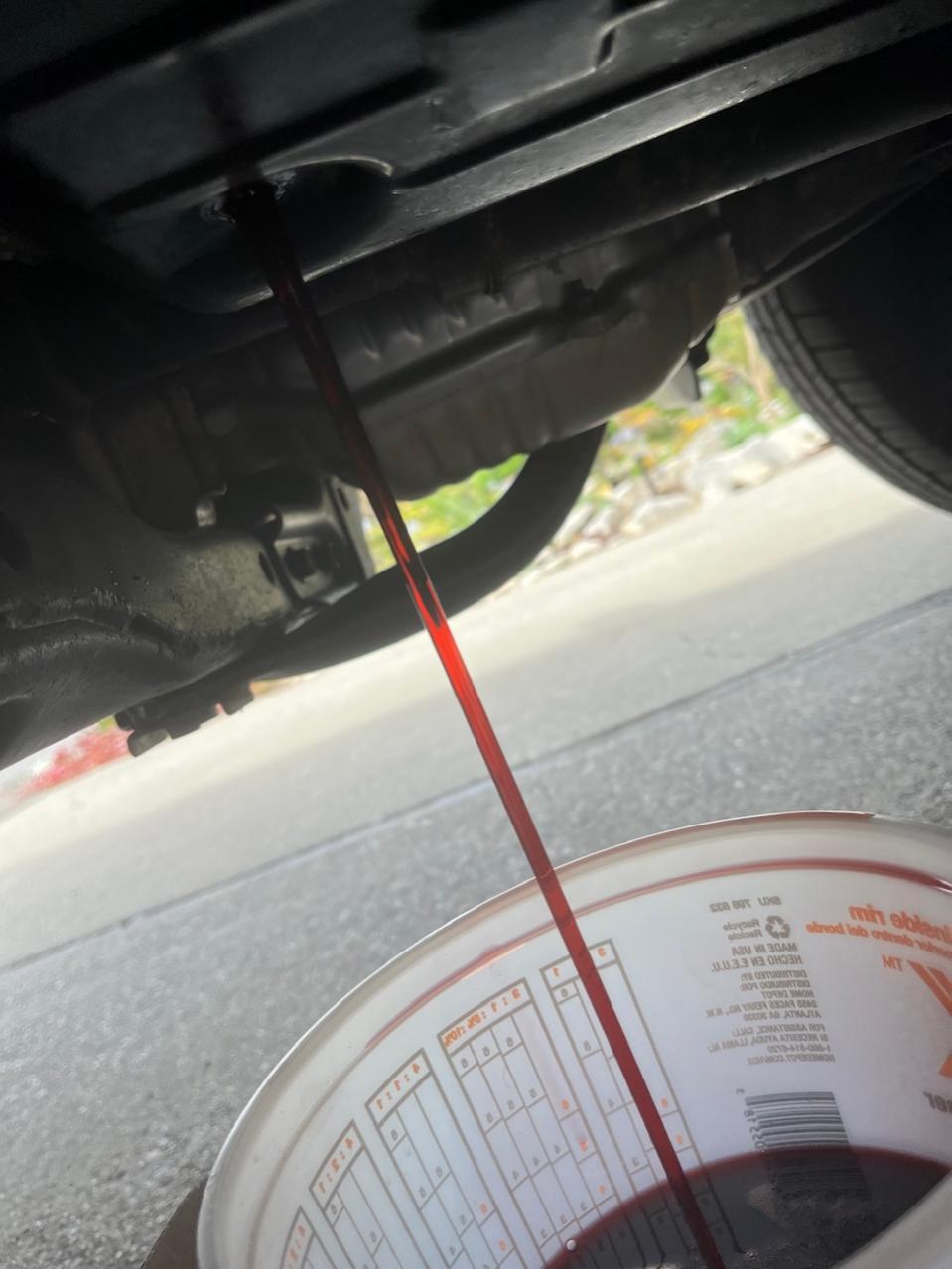

Doing my second transmission service today. 141,143 miles. Approx 30k and 4 years after my last one.
I drained from the check plug first then the drain, not sure why. A little less than last time so far but I’m leaving it to drain for awhile.
Fluid looks very good. I’ve been monitoring transmission temps since I got a ScanGauge and have been using 4th gear a lot more on hills. Max Torque Converter temps I see peak at 213° and maybe once hit 216° IIRC. Pan temps are always below 200°.
My floor is level, my frame is level, but the pan is significantly tilted down towards the front. I ended up jacking the front end to get another pint or so. I will do the final level check on level ground.
Edit! After checking my previous post, I drained the same amount of fluid this time around, a little under 3.5qts.

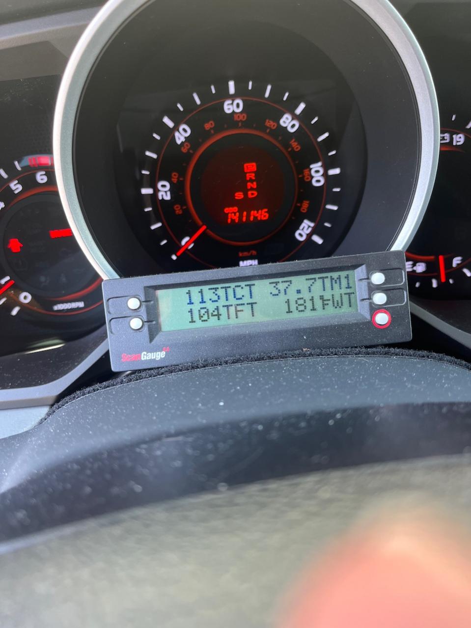

Refilling and level set went smoothly. I pulled out just shy of 3-1/2qts so I put in the same and 4-5oz extra. With ScanGauge, I just drove around the neighborhood until I reached 104° and when I started the check I was at 105°. Got about 4-5oz back out and I had enough time to put a new gasket on the check bolt. Ambient temp affects how long it takes to warm up and how long you have before it gets above 113°. Last time I did it in hot summer and had to wait for it to cool down because I needed to add 1/2qt and check again.
