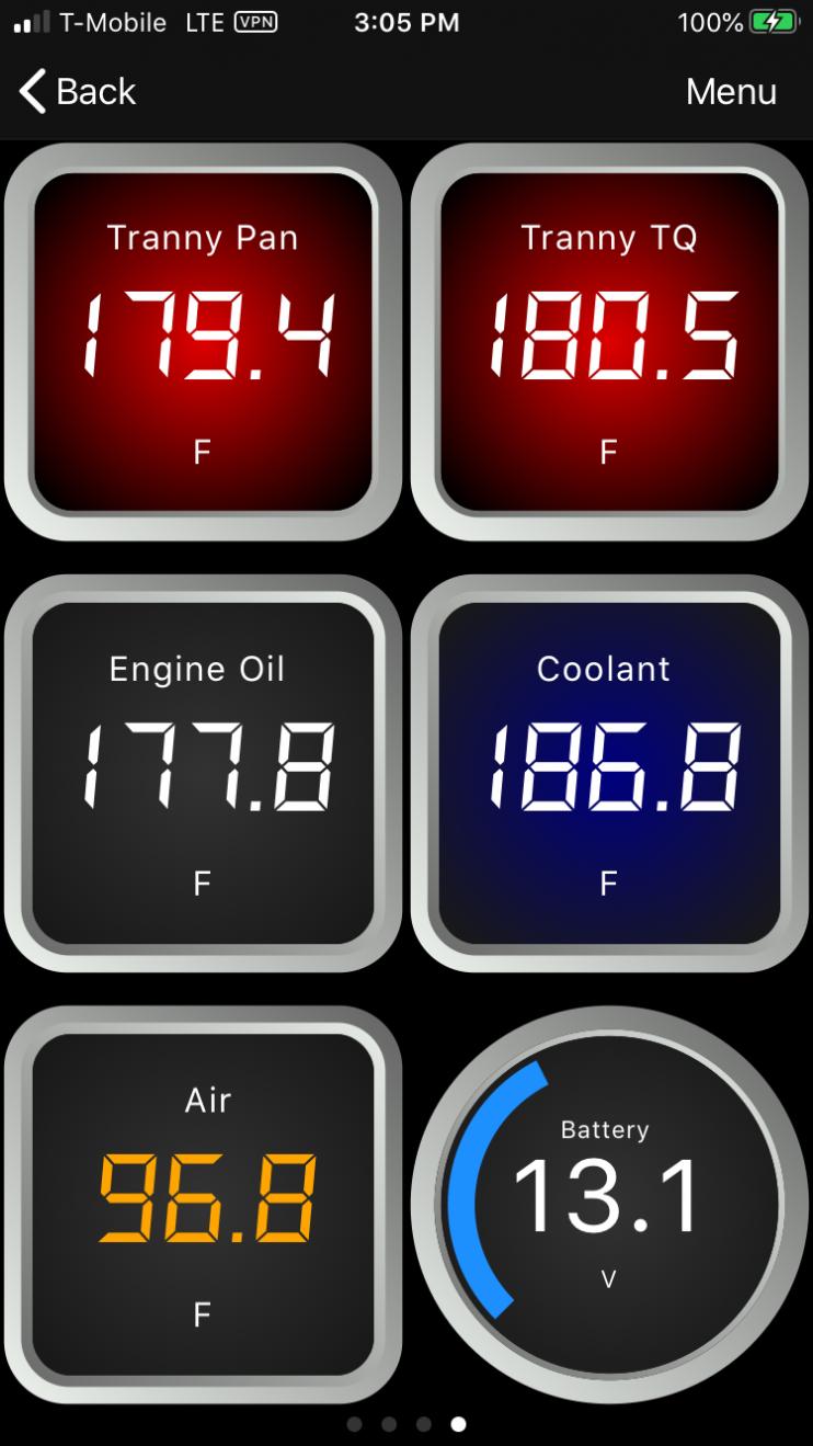

Just so you know the engine oil and transmission fluid on these 4Runners run on the cooler side. At least running empty, I haven’t towed with mine yet so not sure how it handles heat while towing.
The pic below is me running empty from Florida to Georgia, about 7 house on the interstate at 70-80 MPH. Not sure if a transmission cooler is needed unless towing or trying to muscle over some mountain pass out west on the heavier side of GVWR.

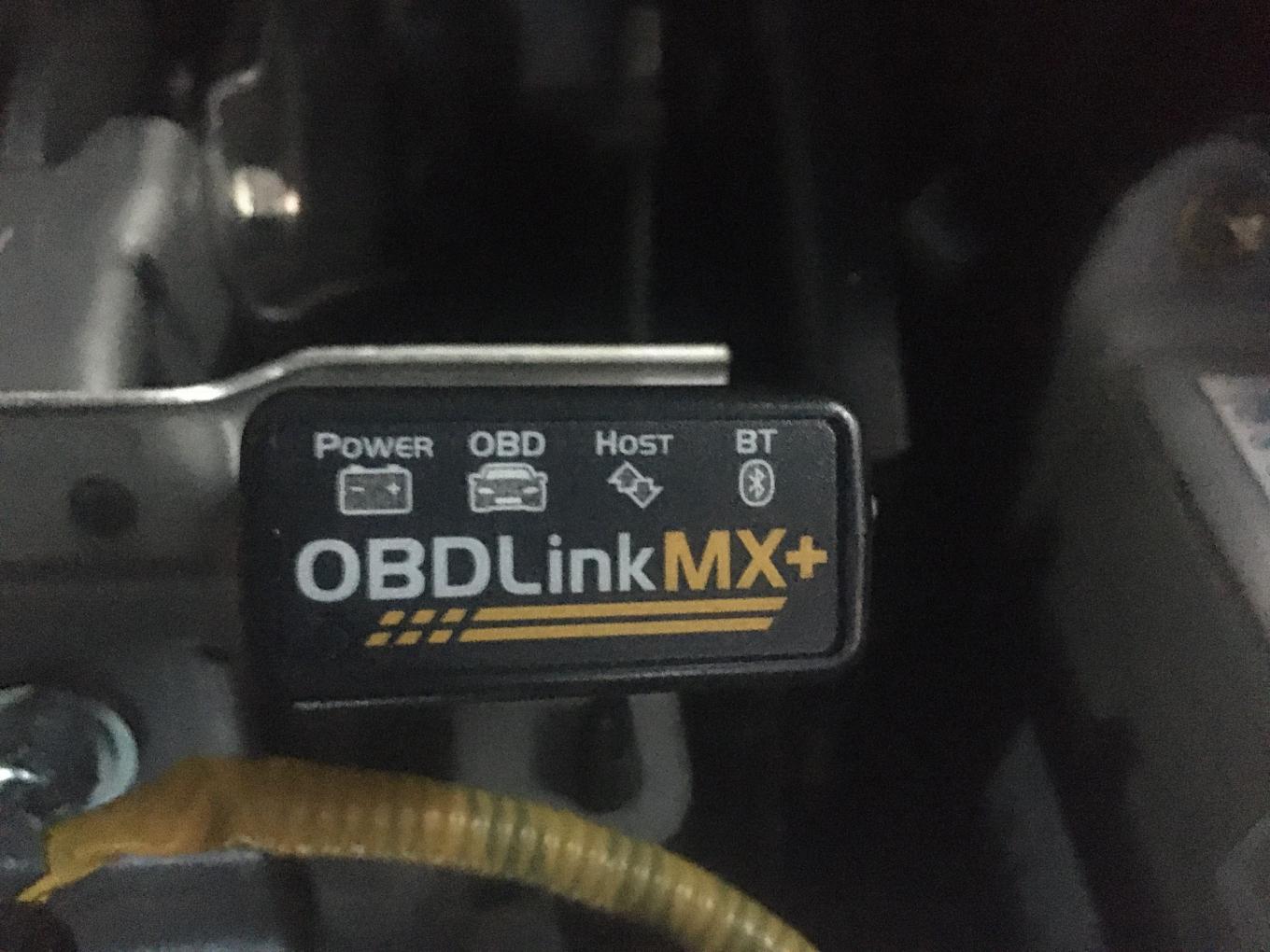

I thought there was no oil temp sensor on the 4Runner.
Here is a pic of the tool I use, simply plugs into the port under the dash. Leave it plugged in and it connects by Bluetooth. There are all kinds options from fluid temps, knock sensors, fuel monitoring, air, power and much more. Only option it doesn’t have is oil pressure which kind of sucks for me because that’s important to me. But the bright side is I get to monitor my fluids. I even got a thermal gun and made sure the temps were accurate. I tested the transmission pan and the oil pan and both were consistent with the scan tool readings, usually within one or 2°. Overall I like it, especially on my trips out west hitting the trails and days of interstate travel.

What app is this?
