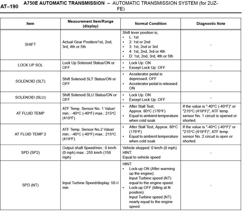

The following page from the service and repair manual indicates that there are two separate temp sensors/outputs on my transmission (V8: A750E).
Edited earlier post re output value of 21D9

MikeInNh, what makes you think there are no temp sensors? Not only does the FSM reference two sensors, but many people here are able to monitor their trans temp using a ScanGauge or UltraGauge. People have also confirmed their accuracy with an IR temp gun.
