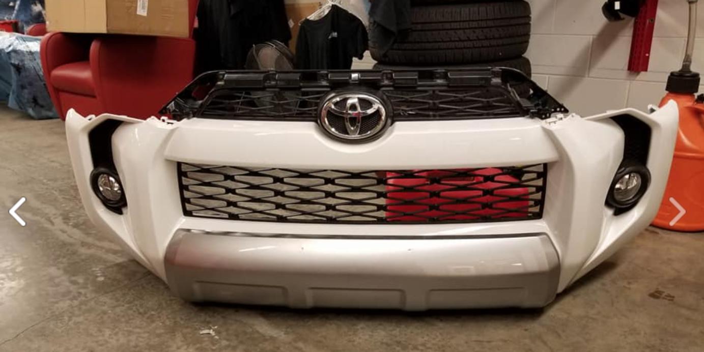

Limited to Trail front bumper conversion soon to happen! Found a sweet deal. Brand new front bumper cover from a 2018, hardware that came with it, the reinforcement bracket, and even the fender liners for $450!
Quick question - I still have to get the bumper painted blizzard pearl since this is a super white bumper and I want to get the valance painted black. I believe the base coat for the blizzard pearl paint is super white? Should I just prep it by sanding the surface clear coat and letting the body shop spray blizzard pearl paint on it? Or is there any other kind of prep I should do. Also same for the valance, should I prep it somehow and what is the actual color code for the black paint that the black trd pro valance uses?
