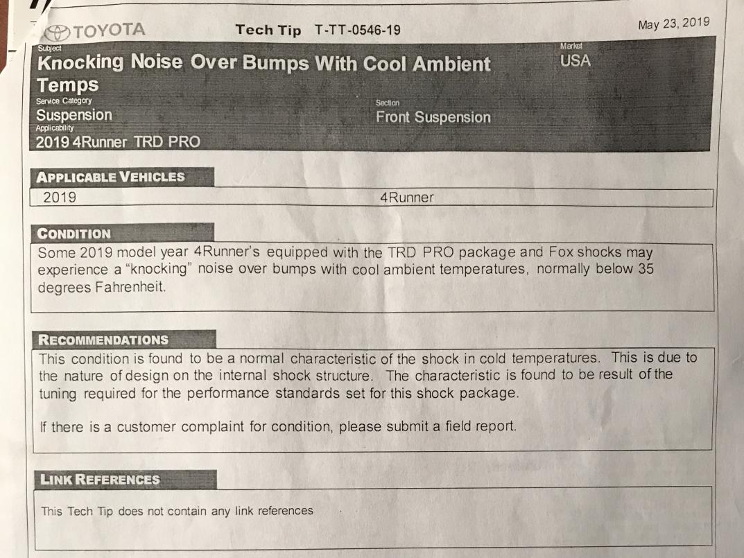

Took my wife’s 19 to the dealer last week for this problem as well. Only difference is it started doing it before it ever got into the 30’s here. More like low 50’s. They game me this informational bulletin I’m posting a picture of. Notice the date of May 2019 in the top right. They’ve known about it for a while. Seems to be coming mostly from the right rear in my situation. Gonna be taking it back as it’s rather annoying.

There is no issue. It's a normal characteristic of the shock. There is nothing to figure out and fix.

“Thank you for your business sir. Oh by the way there’s as good chance the suspension is going to creak like wooden stairs in an old house all winter long. Don’t worry. It’s normal.”
