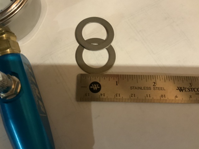

Well, for the next step you could add the very thin washer to the rear mount like I’ve suggested twice in this thread.
After all, it did fix the clunking sound I had for 2 brands and 4 different shocks; which is to say that it wasn’t the shocks, it was the width of the lower shock eye vs the length of the mounting post.

Can you share the specs on the washers? - apologies if I've missed it from an earlier post.
Thank you for the feedback. Honestly my rear suspension noise isn't so much "clunking" and isn't just over bumps or when the shock is cold (originally the thought was after the shock body warmed up a bit the noise was gone). I think another member described it best when they said it sounds like driving over fresh snow and you're packing it down for the first time. To me it sounds more like a bushing or end link binding than a shock problem.
Apologies, I thought you were fighting a clunk sound. Which I spent a lot of time tracking down. Hell, it even took a friend and a big retaining wall to figure out whether my clunk was coming from the front or back of my vehicle. Big bumps didn’t make the sound, it was just small irregularities, which drove me bat shit crazy. It was not easy to track down, but when it was finally fixed, I couldn’t believe the beautiful silence
The washer has an inner diameter of 3/4” and an OD of 1”. It is about 1/32” thick, and it is stainless.
I found them at Home Depot of all places in their specialty parts bin. It is a shim washer. I looked high and low for them beforehand.. all over the web. I couldn’t believe I found them locally at a home improvement store.
https://www.homedepot.ca/product/paulin-3-4-steel-spacer-washer/1000128967
Lower shock eye comes off, spacer goes on, then shock eye, then the retaining bolt. I used a bit of no-squeal brake gel to hold it in place during maintenance when I switch shocks.
It takes up the small amount of slop that is unusual, but was present on my vehicle.
