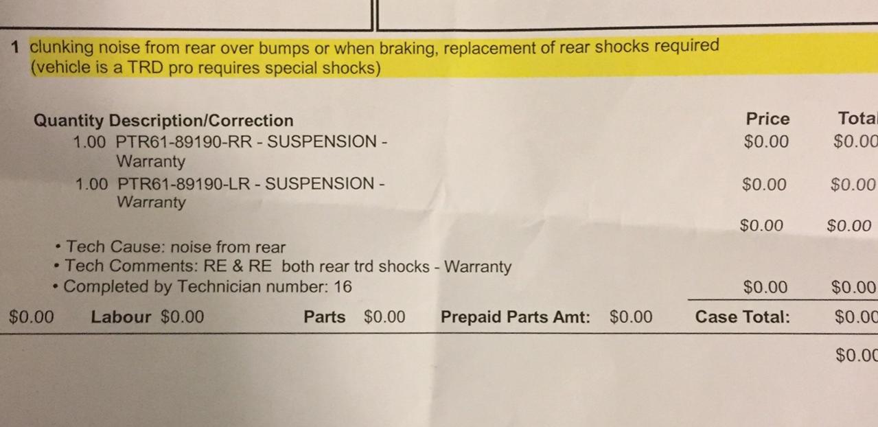

Well, I picked up my vehicle yesterday after the repairs were performed. Front left and right Fox struts we’re completely replaced. I haven’t driven it much since then, but the noise in the front end appears to have gone away. I’m still getting some small creaking from the rear, but will wait it out for a couple of weeks to see how it is under different conditions. Overall I’m very pleased with how it was handled. My claim is still open if there’s any future issues.
Attached is a the redacted repair sheet.
Clunking noise from suspension
I just picked up my 2019 TRD Pro today after the dealership replaced the Fox rear shocks.
Drove it today and no issues. Fingers crossed no more issues.
Thank you two for posting updates and the pics. Hopefully the rest of our dealers start to do what’s right and back the warranty. Good luck with your trucks
One question for ya, what is FTS where it says replace per FTS? Is that one of your tech or field tech service? If you know. Just seeing if they had a document I haven’t seen or something to help the case
I’m honestly not sure. I know my service advisor in the lead tech at the dealership was in direct contact with some regional guy from Toyota. I think they referred to him as an engineer. Who knows. I would assume it’s a Toyota field tech.

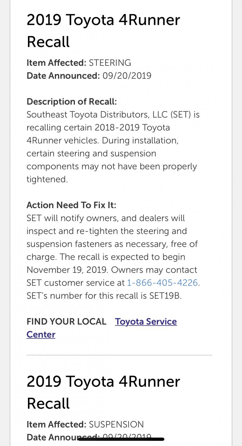

Somehow just saw this recall and not sure how I didn’t see it earlier. Wonder since it’s a shock/sterling issue if it can help this issue
