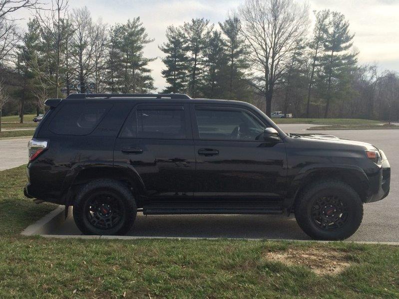

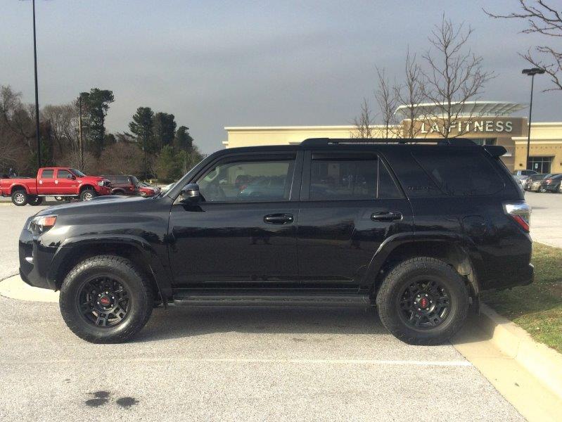

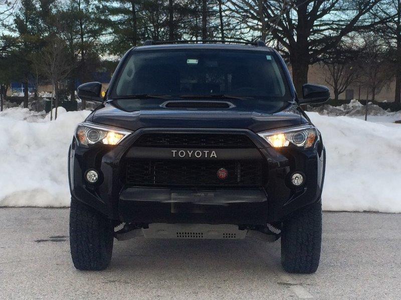

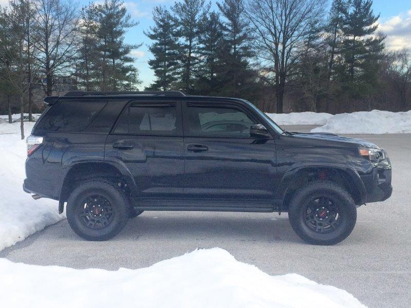

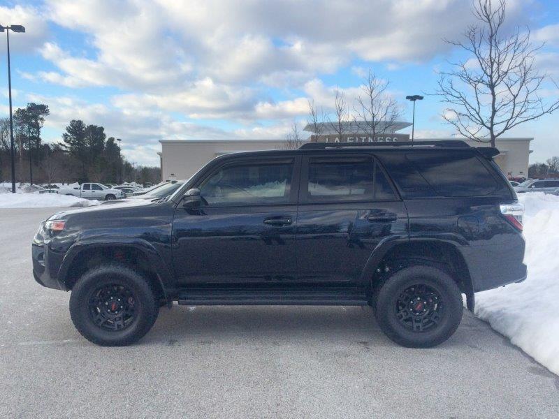

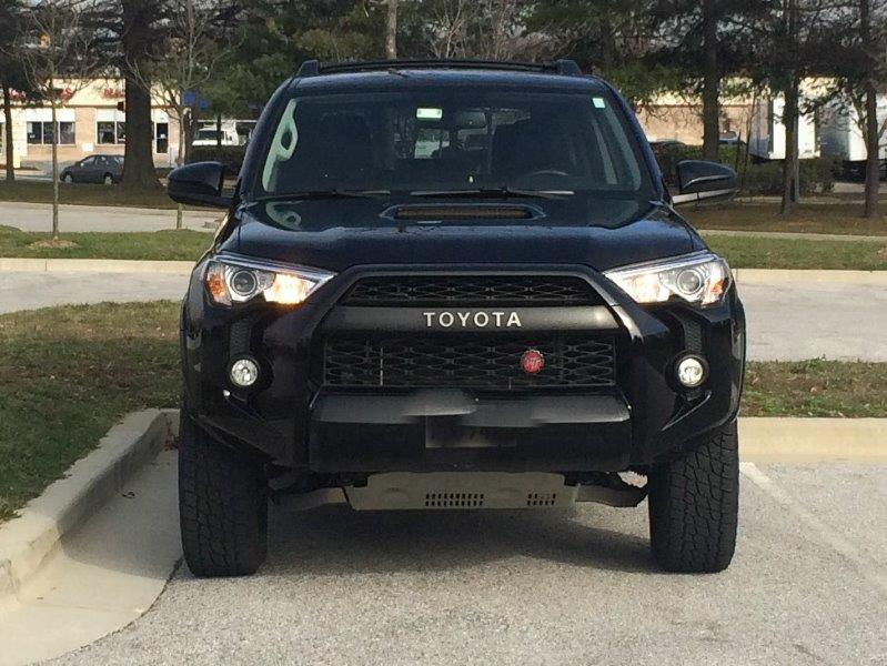

Before pictures are without snow. After pictures have SnowZilla 2016 leftover snow piles. Sorry for poor picture quality, I tried lightening the wheel-well area to show the new gap.
