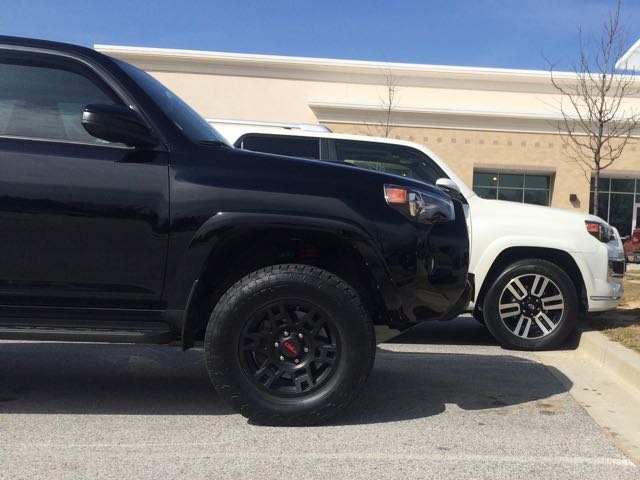

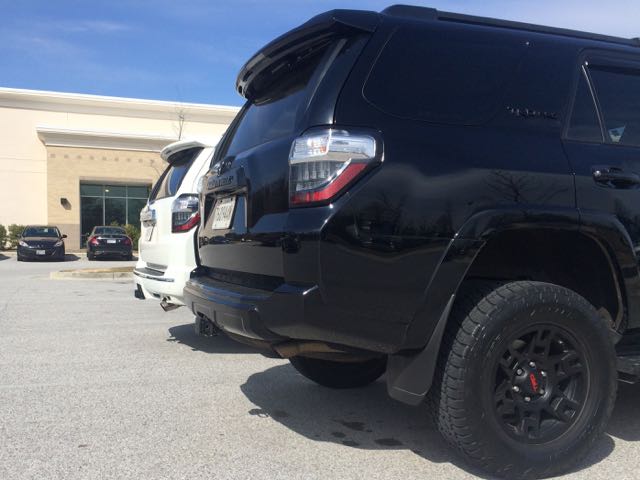

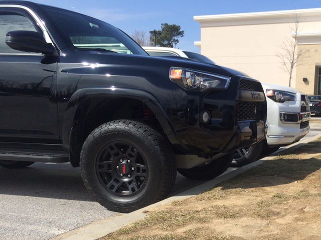

More pictures for comparison. I saw a 5th Gen Limited in the same parking lot and pulled up next to it. I didn't go too crazy as I did not want to alert suspicion. There is some "cheating" in the perspective with my 4Runner closer to the camera perhaps making it look taller due to vantage point. Not a dramatic difference but 2" is 2" right?
