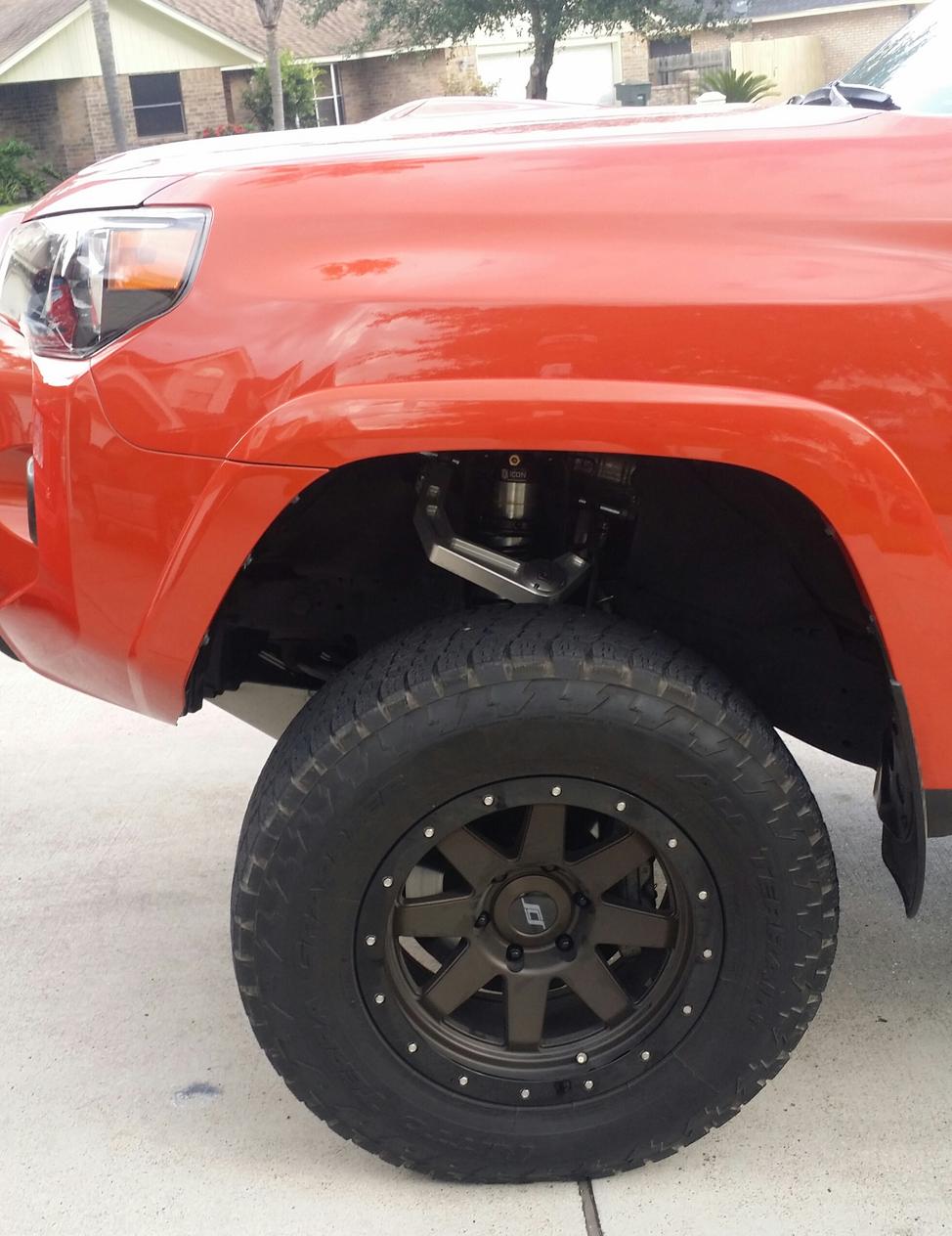

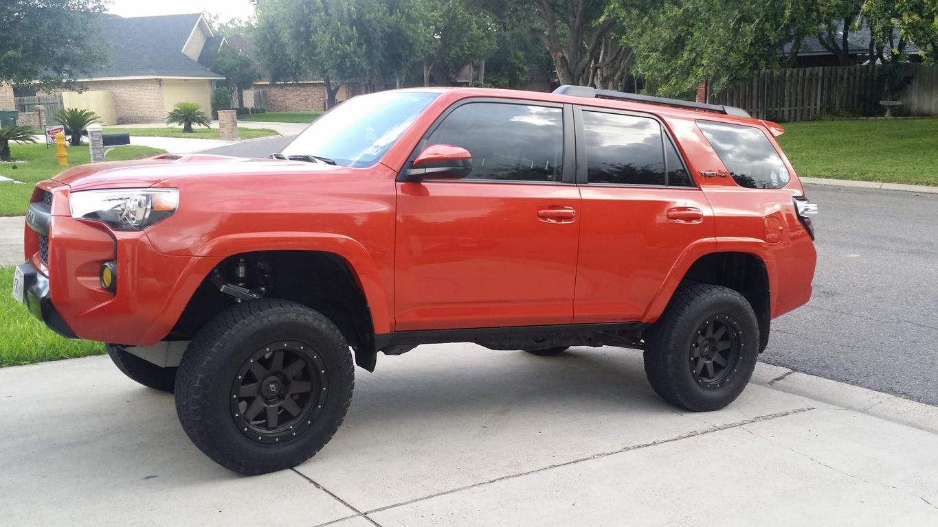

Sits and rides perfect. Installed on monday. I forgot to post it in this thread. Tires should get here friday... can't wait.

Looks good. I have the Quicksand TRDP also. Now that you have the lift and the big tires, how does it feel while driving it? Any issues at higher speeds?
It rides great! no speed issues the tires balanced out nicely. As far as taking it off road I have not done that yet with the new tires. Just got them two days ago, but I'm planning a trip to Silverton Colorado over the week of Fourth of July. I just got back from Moab a month ago and I can tell you that I'm so glad I did this lift. It handled great and I didn't have an inch to spare. It got me through Hells revenge, fins and things, and top of the world.
I've got the 285s. No chop or pushing. Only rubs in reverse full lock ever so slightly.....sometimes. After all this time, I still don't see where it rubs since it is so rare and slight.
If you don't know, now you know!
Are you running any spacers? Rigs looks good!
Any rubbing? just ordered a set of 285 KO2s. Rig looks good!
No rubbing at all on road around town, but I did notice a very slight rub when I had the staring at full lock on one of the switchback in Colorado. Which could've just been the mudflaps. Either way it's nothing to worry about.

Noticed how far your driver coilover is cranked down. Be careful to not go over two inches of gap between the top of the spring collar and the bottom of the top cap. It will cause the spring to bind. Just an observation!
