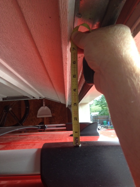

I don't have the Gobi rack. I have the stock rack rails and the tallest point is the shark fin antenna at 75 inches. My garage door is 82 inches at the lowest point. Here is a pic between the fin and the door and I have about 7 inches to clear.
I went with the 275 K02s before adding the toytec TRD kit and they look a little small after getting the additional lift. If you are going to go with 275s I would do the sway away 1.5 in the back vs the toytec springs. I am looking at upgrading to the 285/70/17 Nitto Ridge Grappler as they offer a C load range in that tire and I have found the KO2 E's a little rough for around town.
Correction, I have 7 inches from the black part of the roof rail and not the fin to the lowest part of the garage door.
Awesome. Thanks for the info. I'm feeling more and more confident about this. Just need to get the truck, rack, tires, and lift. Then I'll be all set.

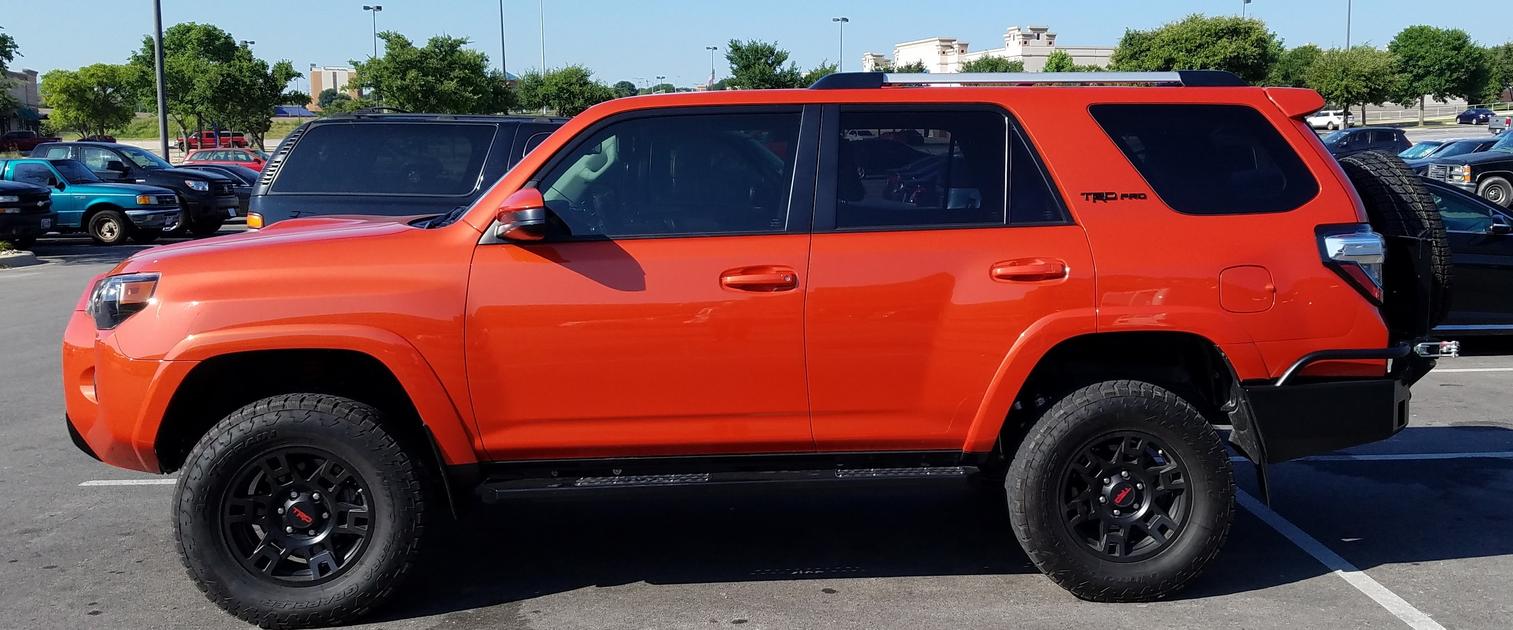

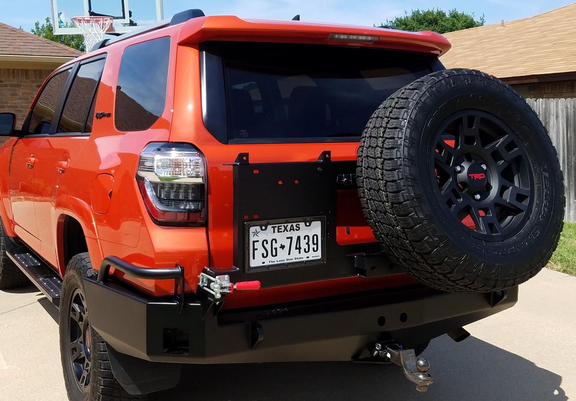

My 2015 TRD Pro
Toytec Lift, CBI Rear Bumper and Slee Sliders.
After installing the rear CBI swing out bumper it sagged a little so I decided to go with the TRD Toytec kit that includes the spacers in the front and the lifted rear spring. Could not be happier.
BTW, if you are thinking about a rear bumper the CBI fabrication is amazing! The actual swing itself is super heavy duty.
