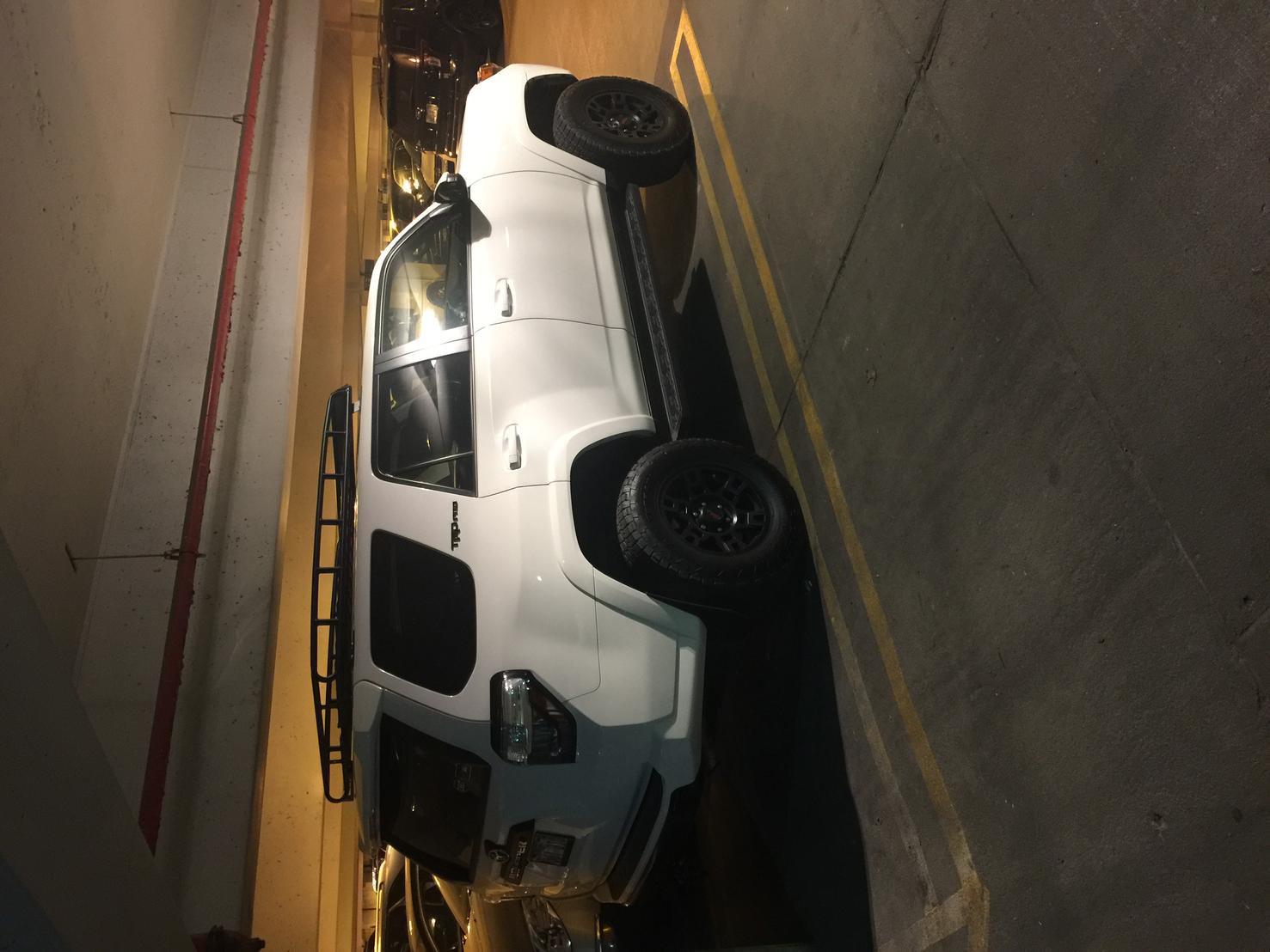

I have this lift installed and am leaving on my first fully loaded trip this weekend. Wife, two kids, cargo area completely loaded, Gobi rack completely loaded, etc. I was going to get airbags (airlift) installed today and the shop just called and said they will not work with the rear springs (superflex) on this kit. It was a air lift 1000 universal kit and both the shop and airlift confirmed they won't work. Concern is that the bump stops have to be fully cut flush and since the bump stops help hold the spring in place, the spring may dislodge if I get a bit too off camber while wheeling.
Does anyone have this TRD Pro Lift installed with air bags? If so, which ones?
Has anyone run this lift completely loaded without airbags and done some wheeling? Any issues with the weight?
I'm now a bit concerned on it's ride and handling when I'm fully loaded.
