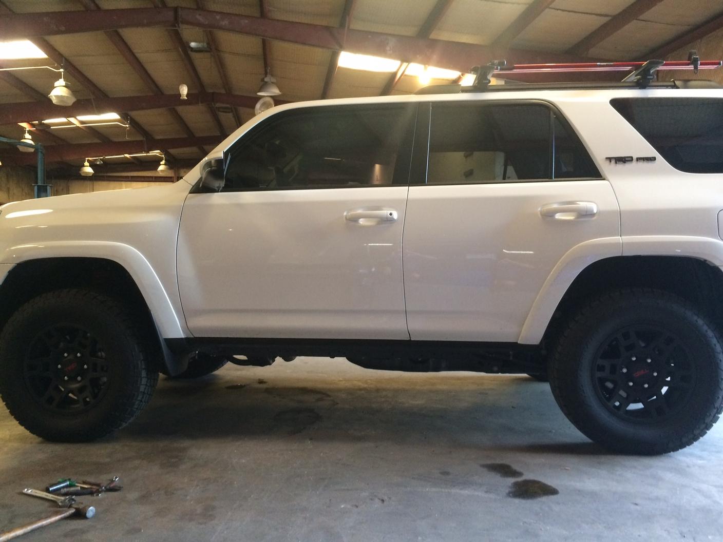

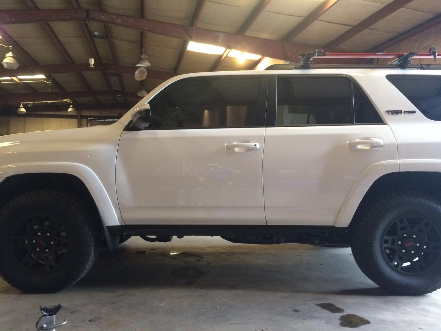

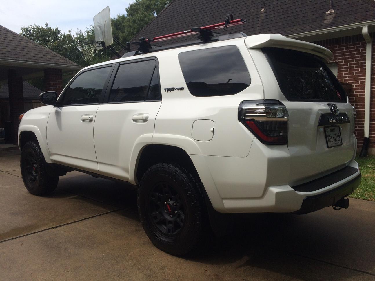

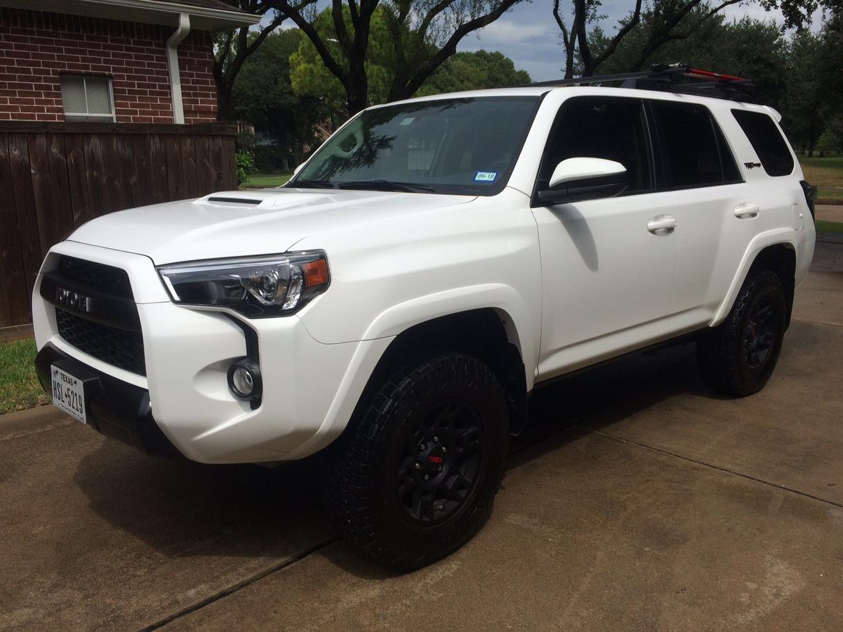

Here you go - Before/After shots of my TRDP with the Toytec 1" leveling spacer kit (Part No. 'BAJA1-B', designed specifically for 4R TRDP's and TRD Baja Tacos).
I couldn't be happier with the results. The installation took about 2.5 hours, and I'd rate it a 6 out of 10 for difficulty (at least at my level). The most difficult part was getting the strut assemblies out (and back in) and of course the most precarious part was compressing the spring (rented the tool from Autozone - no charge, just a $55 fully refundable deposit). Definitely get an extra set of hands to help you out if you go this route.
The stance is perfect, in my opinion. For those not wanting to install the 2" Toytec lift or are wanting to wait until your stock Nittos wear to do so, this is the way to go (I think the 2" lift looks borderline silly without replacing the stock 275s w/ 285s). As far as mitigating nose-dive when braking...it does...slightly...enough for it not to bother me anymore if that makes any sense. From what I understand, although the springs are pre-loaded the spring rate is the same, so I'm assuming it has to do with CG/weight distribution. I'm sure I'll be corrected if I'm wrong. Also - No perception of reverse rake, whatsoever.
Here are the pics:
Stock setup, before/after installation:
After I was finally able to clear her up:
Here are the pics:
