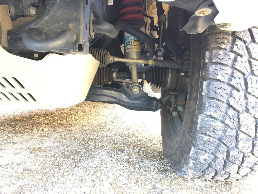

Took a lil longer than expected but here are comparison pics. Stock and after the lift I put on.
