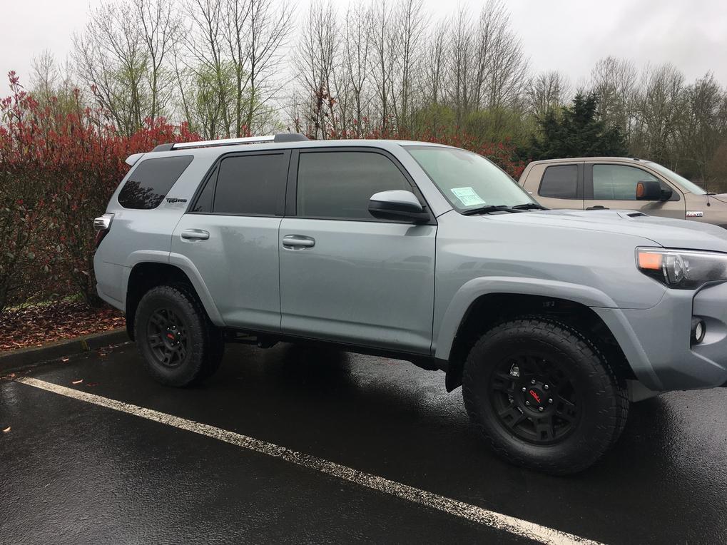

I prefer the wider/fatter stance look but these don't rub, have good height, and mud isnt flying everywhere all over the truck.

Just when I thought I had the tires I wanted picked out. Damn! Looks great!

Digging the pizza cutters Matt. I may actually go that route next time around.
Thanks. I was hesitant at first. Changed my mind 58 times in a week.lol
Love the look of 285's but I also like being different.
Zero rub. Zero trimming. Not getting caught up in all the 285 rutts off road and there's not mud flying all over the sides of the truck everytime I leave the yard. Great height. Also the recommended wheel width for 285's is 7.5" minimun. Our stock wheels are 7" which is perfect for the 255s. Yes you can run 285s on a 7" wheel but I feel more comfortable airing down with the proper size. To each their own.

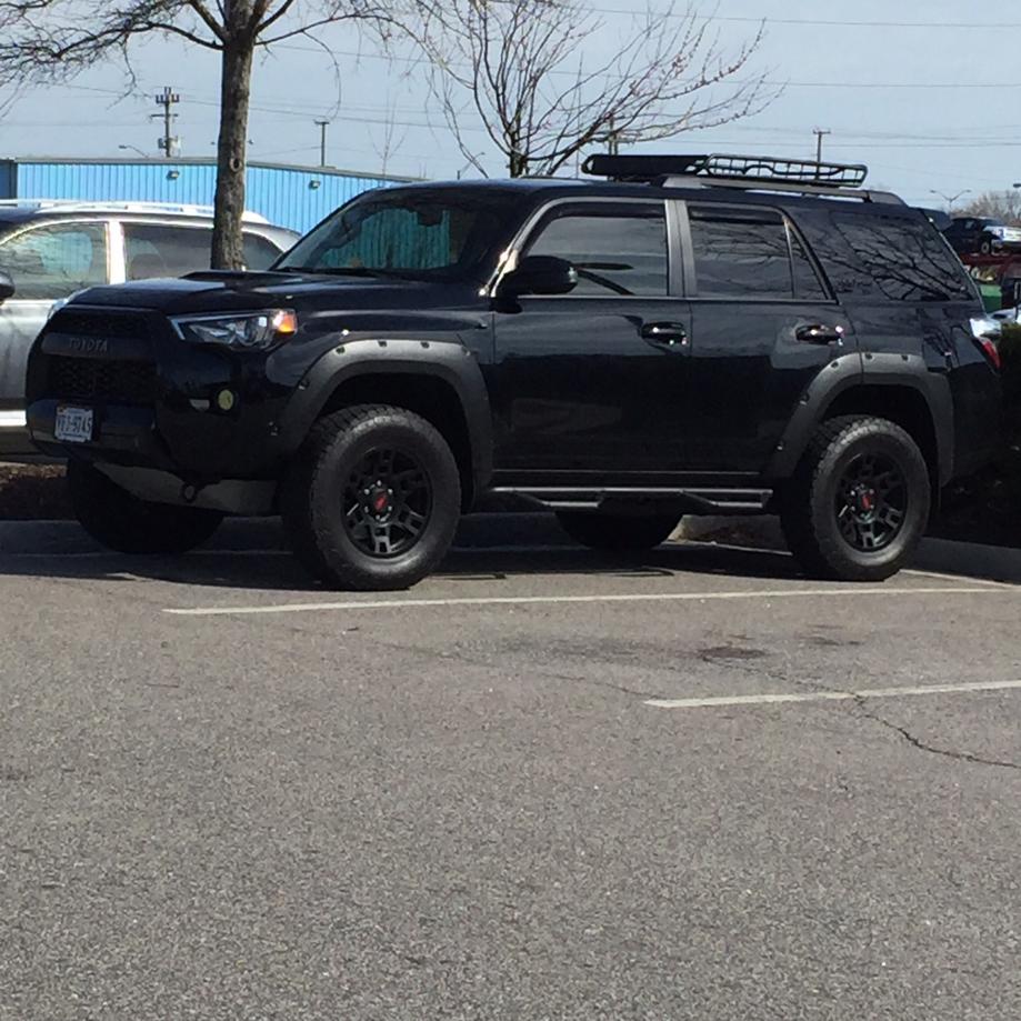

Cornfed 2.25 front spacer and 2.00 rear spacer. Sitting in my garage. Waiting to be installed! :guitar2:
Toytec 3/4 front spacer will be for sale soon. This is how she sits now with the Toytec 3/4 front spacer, only 1/4 inch of rake in the front.

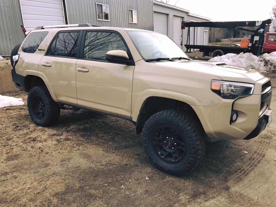

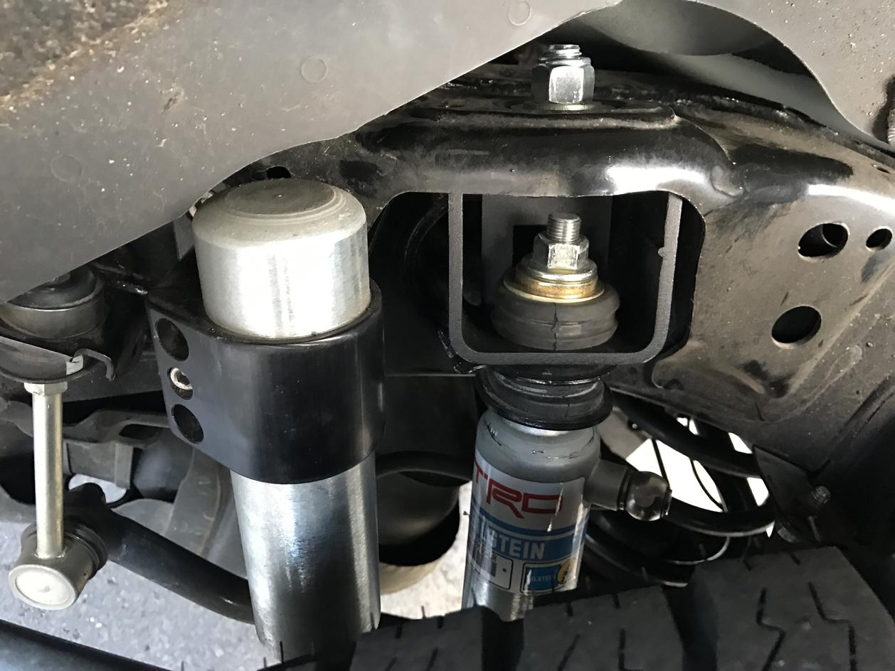

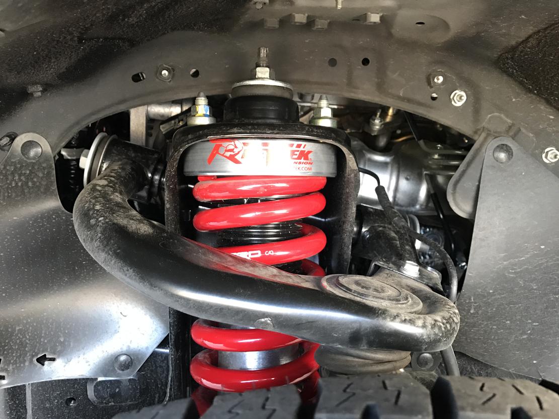

Brand new prototype revteck lift for pro
1.5 inch spacer in front and a small spacer in the back to keep the factory rake. which is not much.
We still get full extension and flex on all shocks and coils. "What we paid for"
Tire size suggested could possibly be a a 275/65/r18 -12 with no trimming and removing the front mudflap. Bassically something smaller then a 33" tires would be perfect so you can play with the numbers a little and your back spacing but to get all of your flex/body roll I wouldn't go bigger. Personal choice
I haven't been able to get tires on it yet this right after the lift but this Very very soon to be fixed. I'm thinking of either a toyo mt 275/65/r18 or a nitto ridge grappler 275/70/r18 -> the ridge grappler is a weaker tread tire so I should be able to get one size up but I'm probable getting the
"This lift will give it the look of a normal sr5 with a 3" suspension increase"
Here are some photos.
1- no lift
2- lift
3- spacer
4- rear spacer

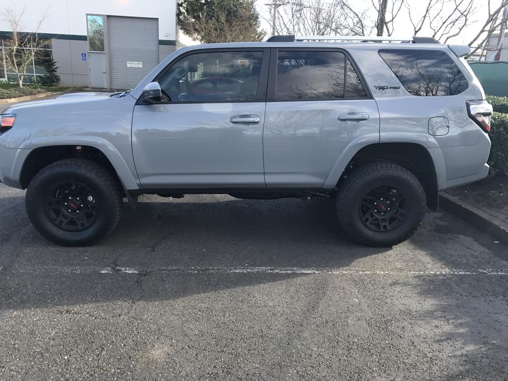

New lift with Stock size Nittos
Installed the toytec 2" lift with HD 2.0 rear springs to support the SSO rear bumper. Loving the HD springs, it makes her drive like before I got the SSO bumper.
I decided to stick with stock size tires due to the 7" TRD Pro wheels, next tire change will include a 8" wheel and 285's.
I think the stock size looks pretty good.
The toytec lift is a no brainer for the TRD Pro. Makes the ride much better IMHO, especially if your carrying around a bunch of weight in the back all the time.

JW, was there a bump stop extensions added w/ this kit? Because you will prob blow your rear shock if not...
