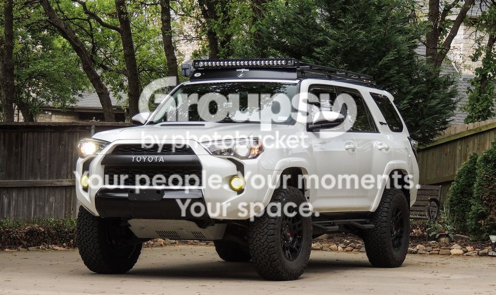

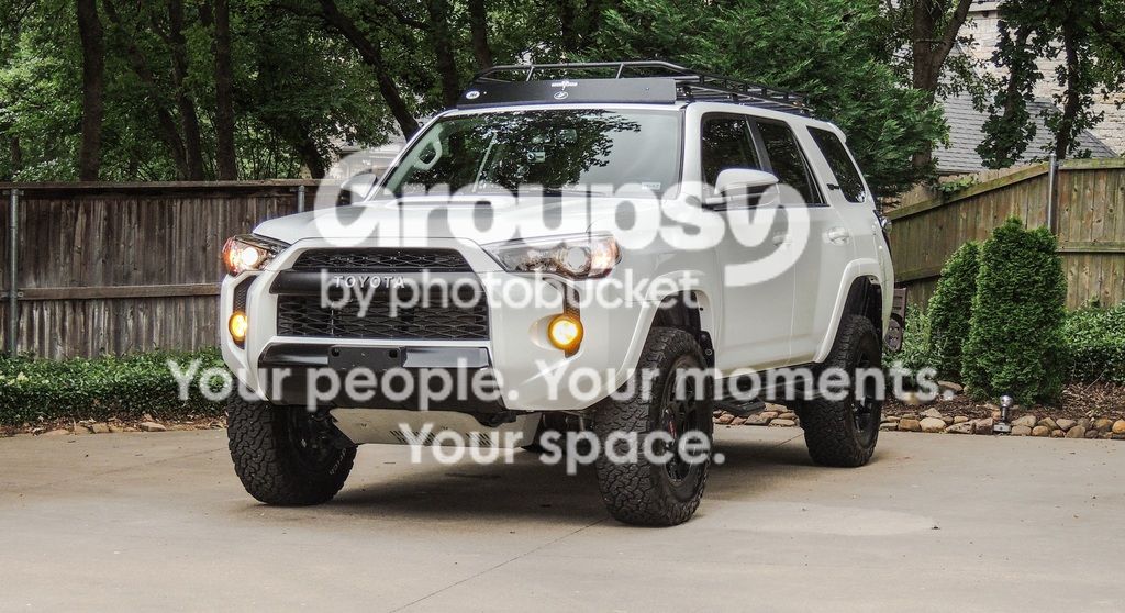

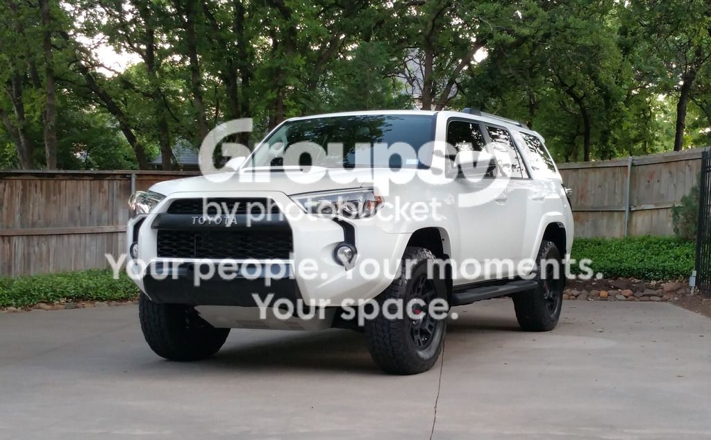

I installed the Toytec TRD Pro lift way back in November of 2015, and had no issues with it at all, as far as performance/issues ect.
One thing that always bothered me just a little, was the almost 2 inch front rake. I liked where the rear stood, but always wished the front was a little higher.
I just recently replaced the Toytec kit with the Icon Stage 2 kit, and I love having the ability to adjust the front coilovers.
Along with better on-road/off-road performance, I was able to get the rake where I wanted it. From almost 2 inches, down to about .75....
The rear measures about the same heighth as the Toytec kit, but I was able to bump up the front height a little over an inch from where it was before, to get it leveled out.
Here are some pics for comparison:
1. Stock w/ stock 265 Nittos
2. Toytec Kit w/ 275 K02's
3. Icon w/ 285 K02's

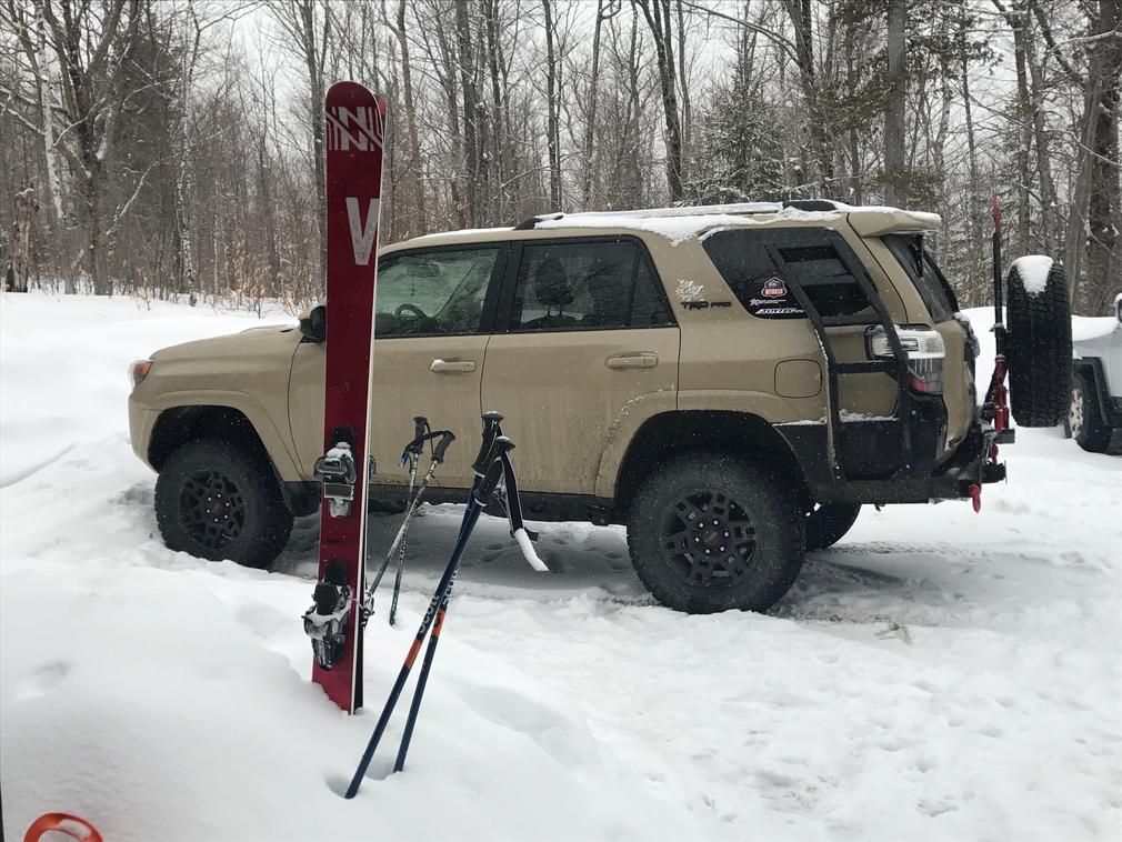

Hey guys. I had my lift installed last week and got a chance to take "Trudy" (My TRD Pro) on a Skiing/fishing trip over the weekend.
I got the Superflex 2.0 HD springs and the 2" spacer up front. At the same time I switched to the Nitto Ridge grapplers E rated. I got the HD springs to support the SSO bumper and I was a little nervous that it would be a rougher ride, especially with adding the 10 ply tires to the mix.
I was warned by my fishing buddies that the road over was in extremely bad shape. One of them had broke a leaf spring on his Taco the week before. We piled into the 4R and hit the road. I was freaking amazed. I have never been in a vehicle that could soak up bumps and be so comfortable on such a disaster of a road. Multiple times my buddies gave the "Oh shit... here comes a really bad spot" and we virtually floated over these massive imperfections in the road. Trudy rides remarkably better than the day I took her off the lot.
We also got onto some unplowed roads on our way into some spots and the Nittos trudged through 10-12 inches of snow without a problem.
Just wanted to share my experience and the fact that this has been the best upgrade I've done to my vehicle to date. I would highly recommend it. Beyond impressed with this setup.

Looks really good viper! What is the ride quality like compared to the Toytec? Any funny noises? Any profile shots?
Thanks man! The ride quality is awesome.....Takes rough roads/speed bumps a lot better....Haven't been off road yet, but will soon, & I'm sure I'll be happy.
No funny noises...Pretty quiet actually. I'll try to post some profile shots later today.
Thanks again.
