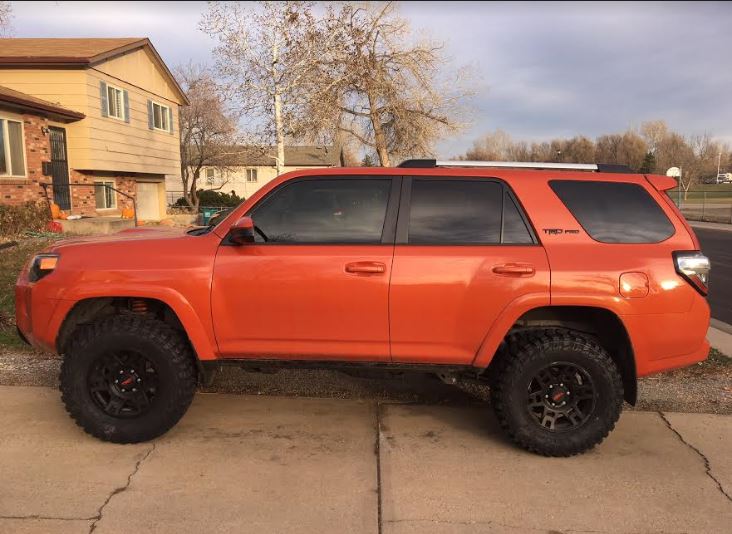

Another successful report of the Toytec TRDP lift and fitment of 285s. I put on 285/70/17 Cooper Discoverer STT Pros which measure at just about 33"
No rubbing on the road when braking/turning/etc, but that likely won't be the case once I hit the trails.

I love the inferno color so much. Looks nice.
