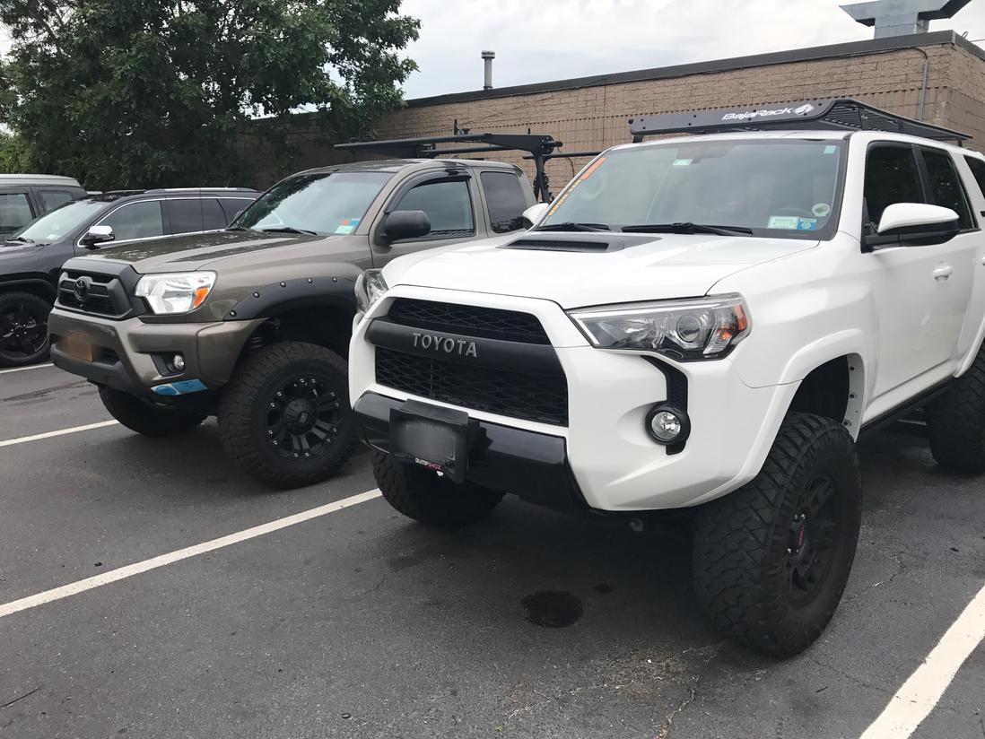

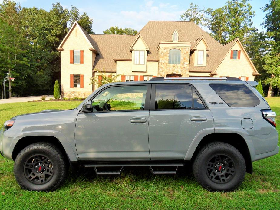

I installed the Toytec TRD Pro lift way back in November of 2015, and had no issues with it at all, as far as performance/issues ect.
One thing that always bothered me just a little, was the almost 2 inch front rake. I liked where the rear stood, but always wished the front was a little higher.
I just recently replaced the Toytec kit with the Icon Stage 2 kit, and I love having the ability to adjust the front coilovers.
Along with better on-road/off-road performance, I was able to get the rake where I wanted it. From almost 2 inches, down to about .75....
The rear measures about the same heighth as the Toytec kit, but I was able to bump up the front height a little over an inch from where it was before, to get it leveled out.
Here are some pics for comparison:
1. Stock w/ stock 265 Nittos
2. Toytec Kit w/ 275 K02's
3. Icon w/ 285 K02's
