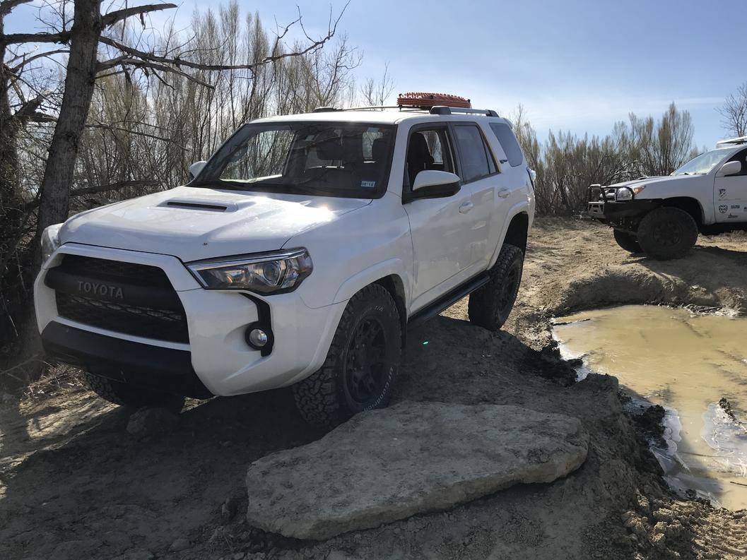

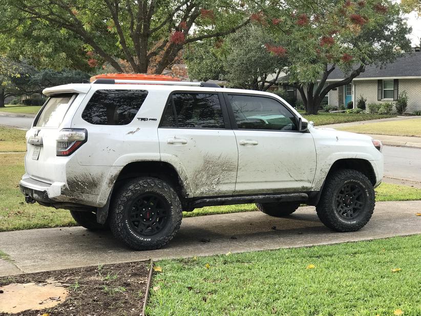

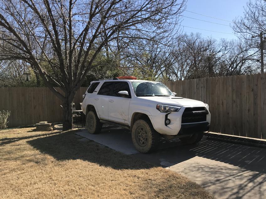

I’m another advocate for the Toytec lift. It lets you keep what you’re paying for in terms of the ride and how they perform, but it gives you two extra inches or so. I fit 285 KO2’s on mine, and never rub. I’ve also got my front sway bar off and even then, they’ve never rubbed while off roading. Feels like a great height, and the tire change made a huge difference both on and off road for the better. No more slipping off the line in the rain, and much better off road traction. Could be the size off road, but even in mud they do better it seems. But, that’s just me.

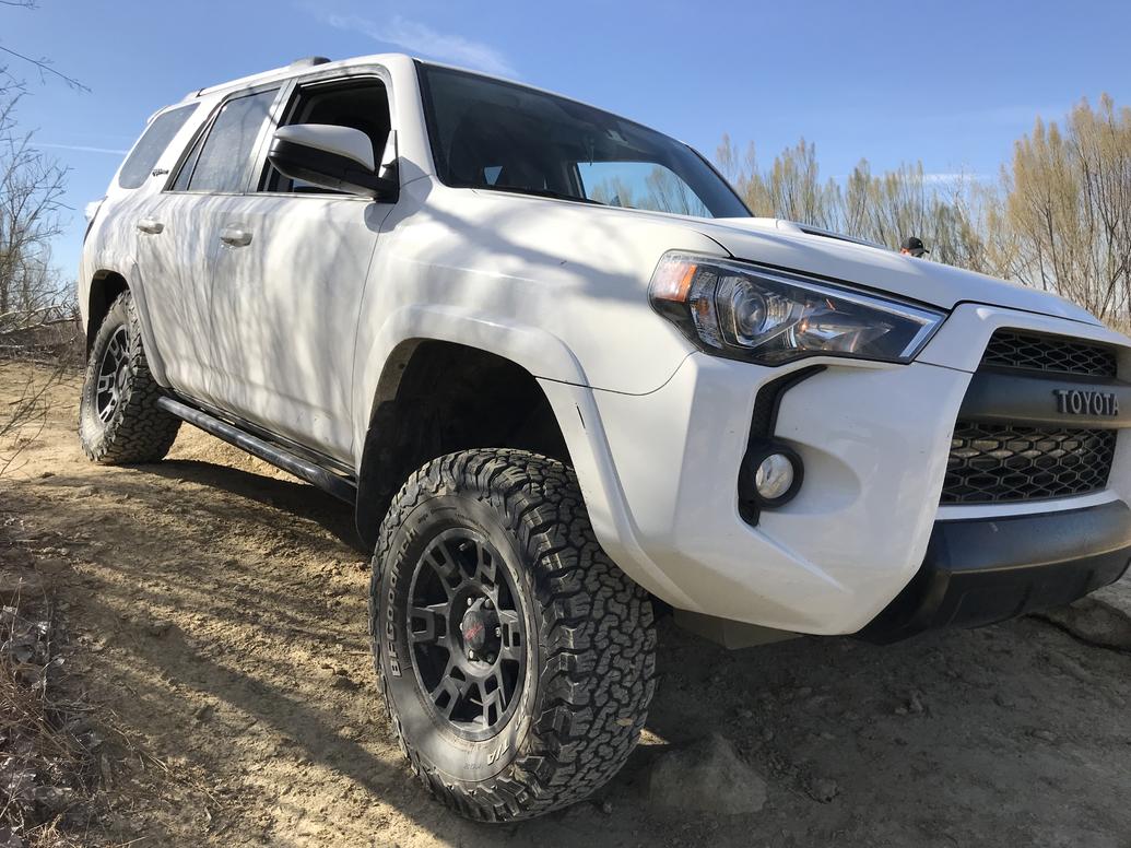

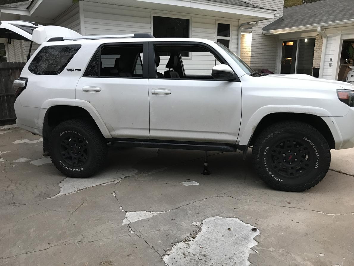

For me, I got the 2” lift which was about $440. I haven’t measured to see if I got any more or less, but it’s a noticeable lift. I’ll post a before and after for you. You can really notice it when you’re driving next to a stock one.
