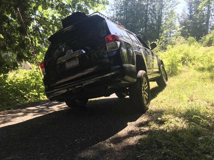

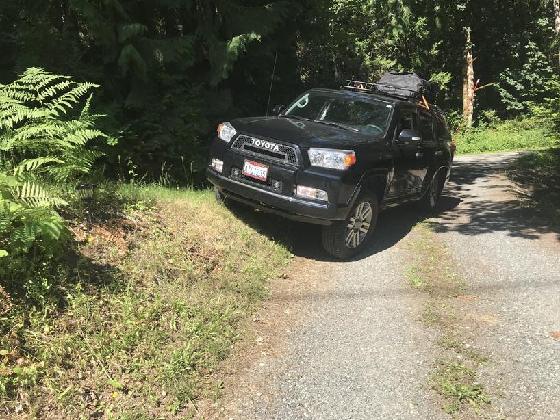

I found an open opportunity this afternoon to install the new springs. After the recommendations here, and speaking with Toytec, I did end up going with Sway-A-Way 1.5" rear coils.
While I didn't get a lot of measurements, here are some pictures that might help you decide.
First and foremost.. Obviously this isn't level ground. And I cannot tell you how excited I am for my house to be complete where I have a nice 3 bay garage to do work like this in. This working in the dirt and dust takes me back to college... and I didn't like it back then any more.
Here is a before picture:
The passenger side went very easy. This is actually the best angle to see the size difference in the springs:
Here is another picture of the spring differences. The Toytec pro on the left, the new sway-a-way in the center, and stock on the right. I tried to get out of the sun to get the picture and I messed up the angle doing that.
Driver side was a little more of a pain. I didn't have a wrenching buddy to help me out... and I was so darn close to getting the old spring out. I didn't really want to monkey too much with the panhard bar, and I knew I needed just a little bit more to get it out...
So a little redneck ingenuity here. I found that by placing the tire on top of the hub and laying on it gave me enough weight to drop it far enough to remove that spring by myself:
And this is the after picture:
Again I apologize for no measurements. I think you can see from the pictures there is a decent difference. I will say this: I took the picture, took the 4runner straight up in the air, replaced the springs, dropped it straight back down and took the after picture. I know the ground wasn't level, but it was as close to being in the exact place for the before and after pictures.
I think these are the springs the kit should come with. I do not like the rake at all. I get why some people would like it... But 90% of the time I don't carry anything heavy enough to need that extra height in the rear. I much prefer the more level stance!
