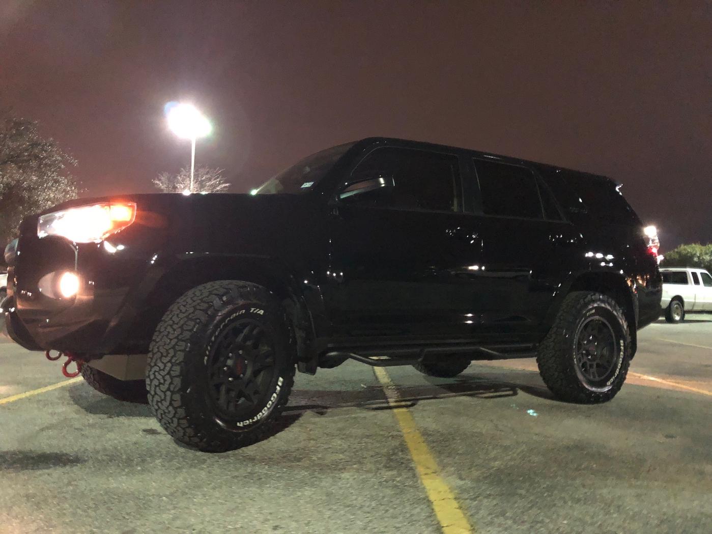

I've skimmed 90% of this thread and this is the first time I've seen that 285's will fit the TRD Pro without a lift of some sort. Do you have pictures of your 285KO2s with now lift?
Here you go
Thanks for the picture and response. Those are 285 70r17? I bought my TRD Pro used. The previous owner added what I believe is a Pro Comp 3" Front/ 2" Rear spacer lift with 285 70r17 KO2s. It looks great but I think it rides/handles like crap so I'm considering removing it. If I can get away with removing it with the 285KO2's on it then it doesn't cost anything but some time and an alignment.

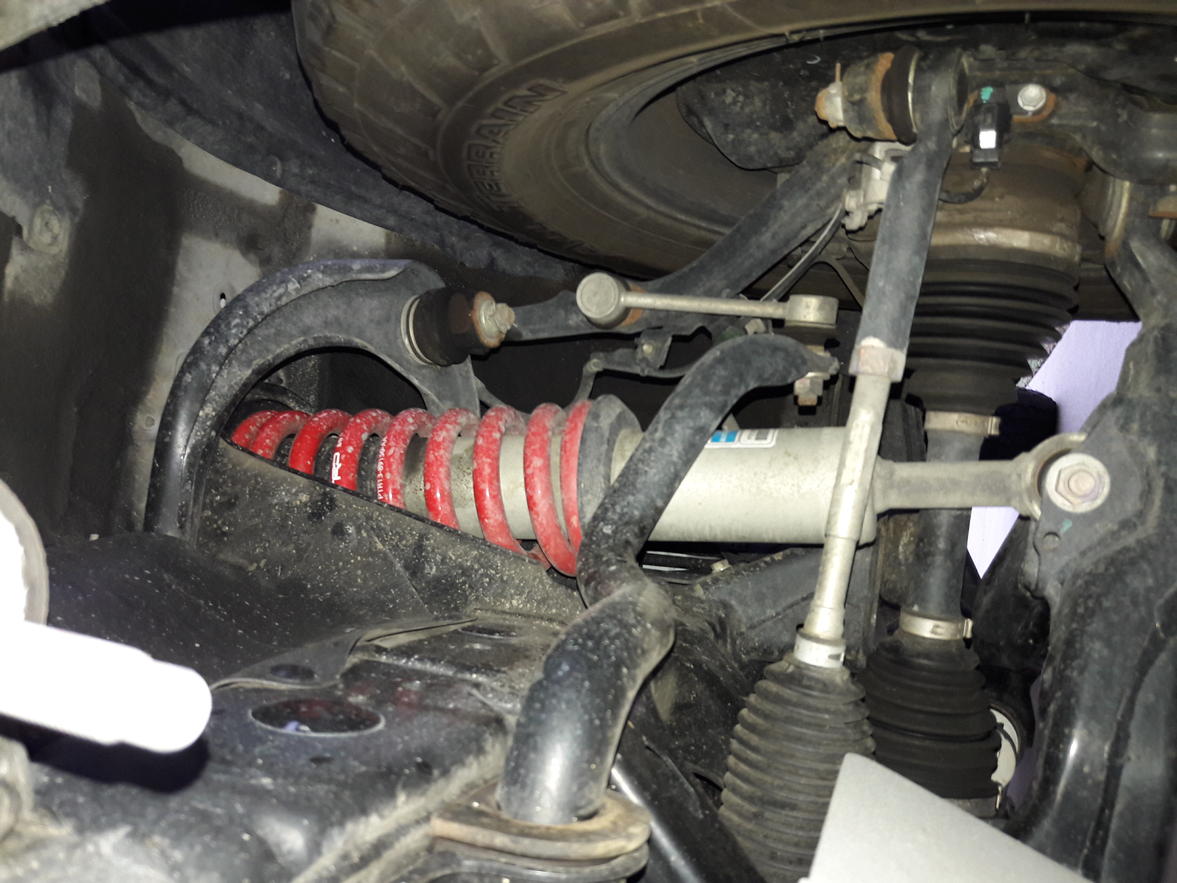

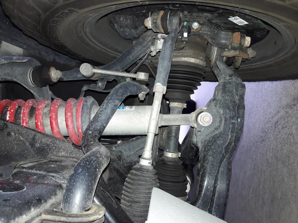

Can someone do me a favor and post a pic of the CV boots of a stock TRD Pro. I just replaced my suspension over the weekend and I’d like to see a comparison. Thanks in advance!
Couple pics for ref stock 16 TRD Pro
Sorry about sideways view. Just turn head 90*
