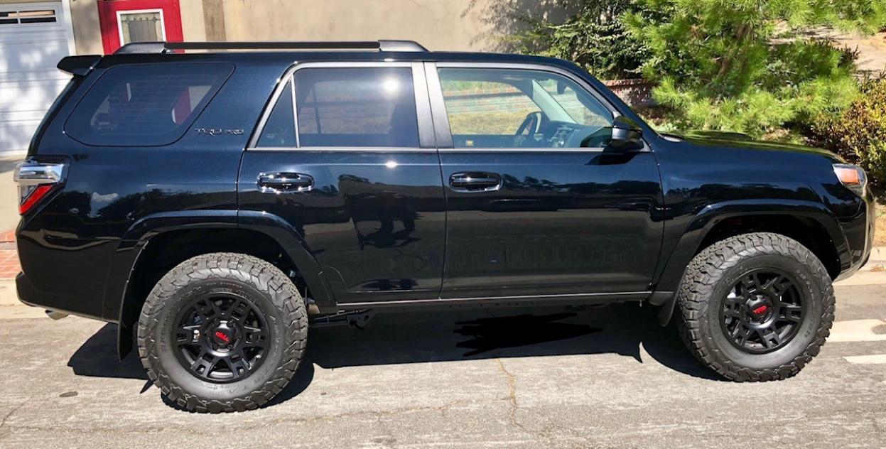

My TRD Pro Lift
Since my truck is pretty level and you do want a slight rake for additional weight added to the rear when necessary, I’m contemplating if I should do anything at all.
I’m running 275-70-17 on my stock 2018 Pro without any problem. The fender liner mod has already been done on the Pro at the port. See link. T-SB-0009-15.pdf - Google Drive
As for a lift, check out forum member Tejas’s Pro with Burtman Industries Cornfed 1.5/1” spacer lift on a Pro with 275’s.
My TRD Pro Lift
Those 275s look great. Thanks for the info!
Pro with 1.5/1" spacers (Cornfed/Burtman) w/275's on stock Pro wheels. 275's work just fine on the Pro stock, but I wanted a slightly taller vehicle without getting carried away.
