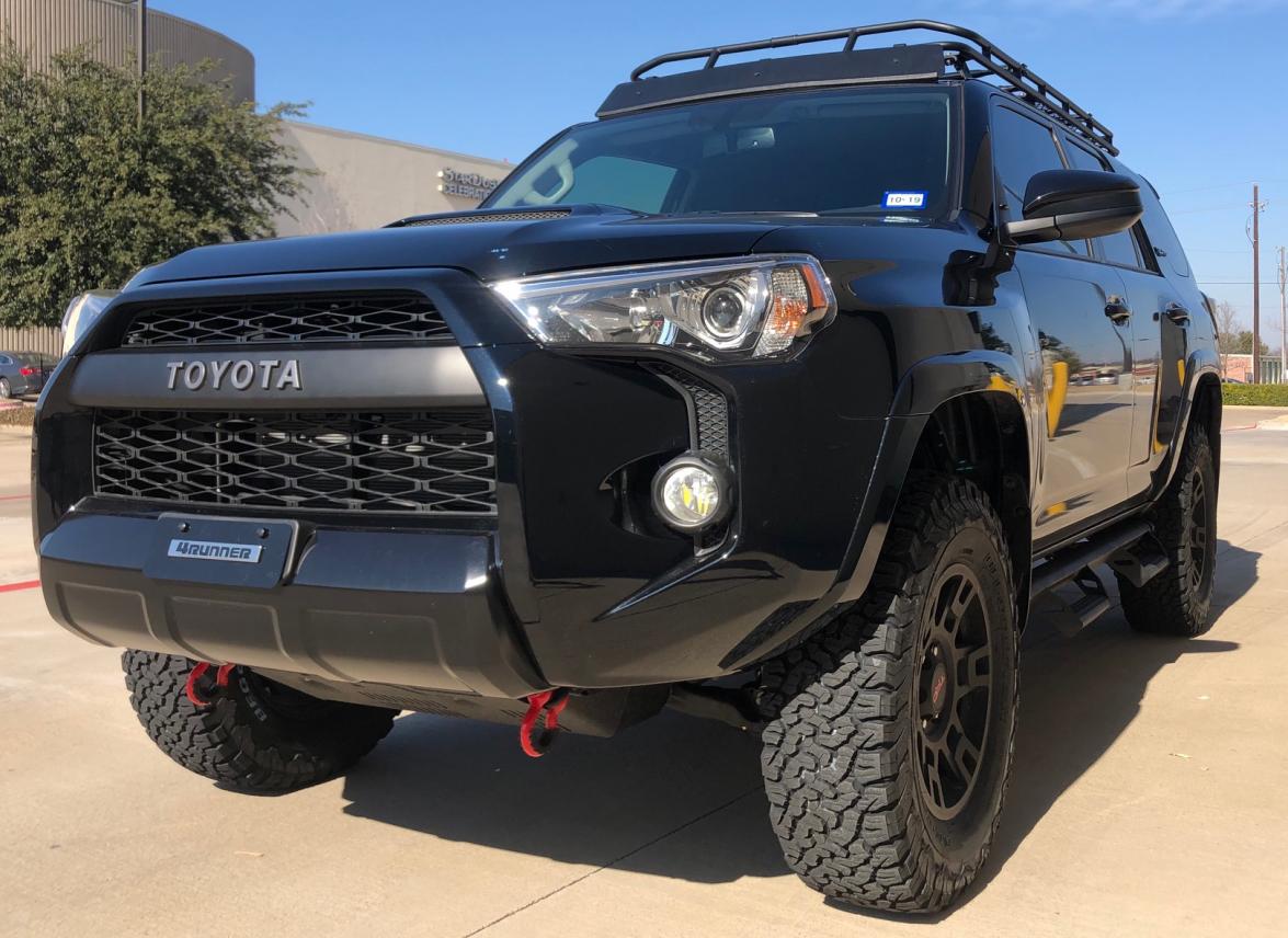

I'm still on the stock rear Pro shocks.. no issues at all and huge amounts of flex. These actually have a higher than average extended length. I still had some travel. I haven't topped any thing out.

The rear is OME 2895E springs and 1.5" rear poly spacer. Rides like stock. A bit firmer, but very comfortable. 8k miles with this rear setup. No issues. Everyone is going to flame me for it, but first, I've tried other setups. This works really well on and OFFROAD. Sometimes you just need to KISS.

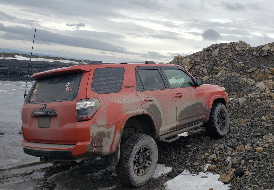

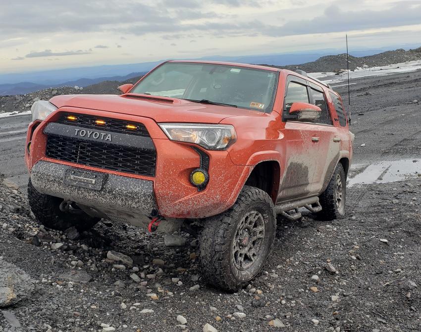

I’ve wheeled my with and without the Daystar spacers. Without, I was dragging the rear diff hear n there and the skids were rubbing. Didn’t have the funds for a full suspension upgrade so went with the 2.5@ front and 1.5” rear spacers. Next trip out, didn’t rub at all and kept the same factory ride quality.
It’s also about how where you place those tires on the trails.

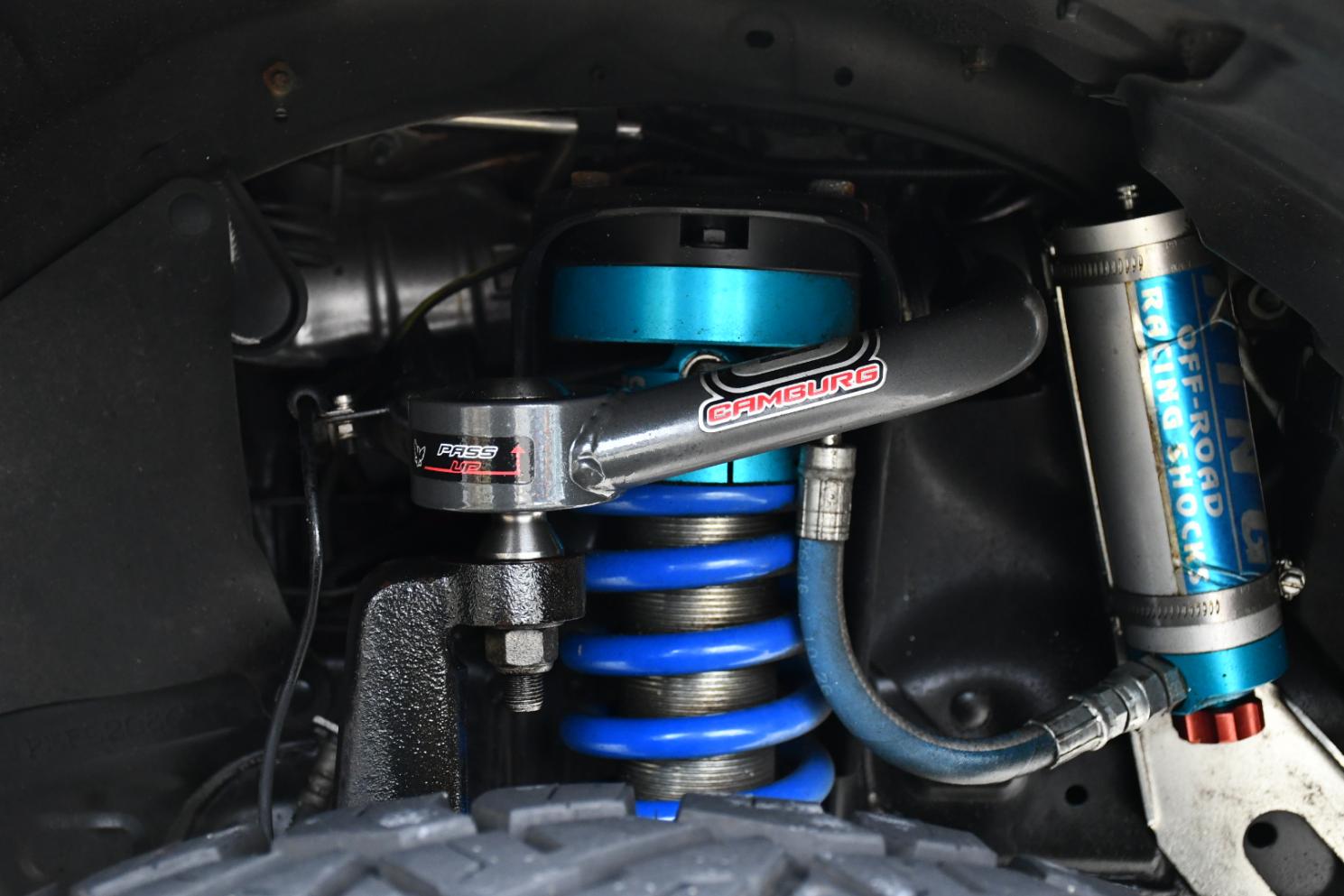

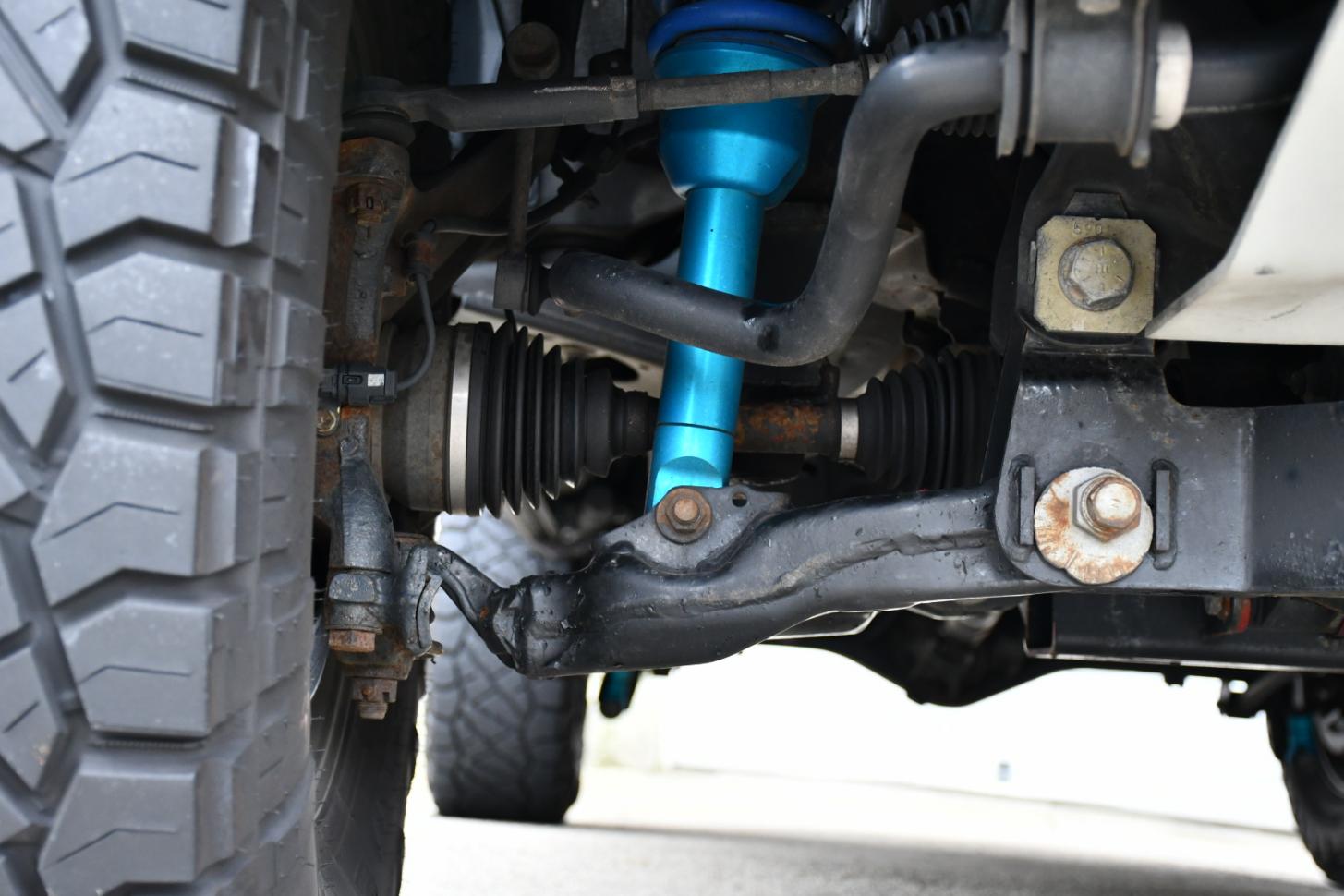

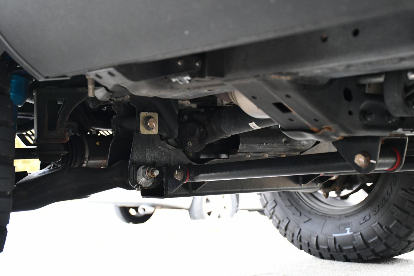

Not necessarily because I want a 6 inch lift, but rather that I would like better geometry.
Here are some pictures as promised. We didnt get the snow that was promised. Tell your friend to DM me because you wont find an off the shelf "Kit". This is not a DIY lift that comes in a box. Take a look at the CV angle and the LCA angles.

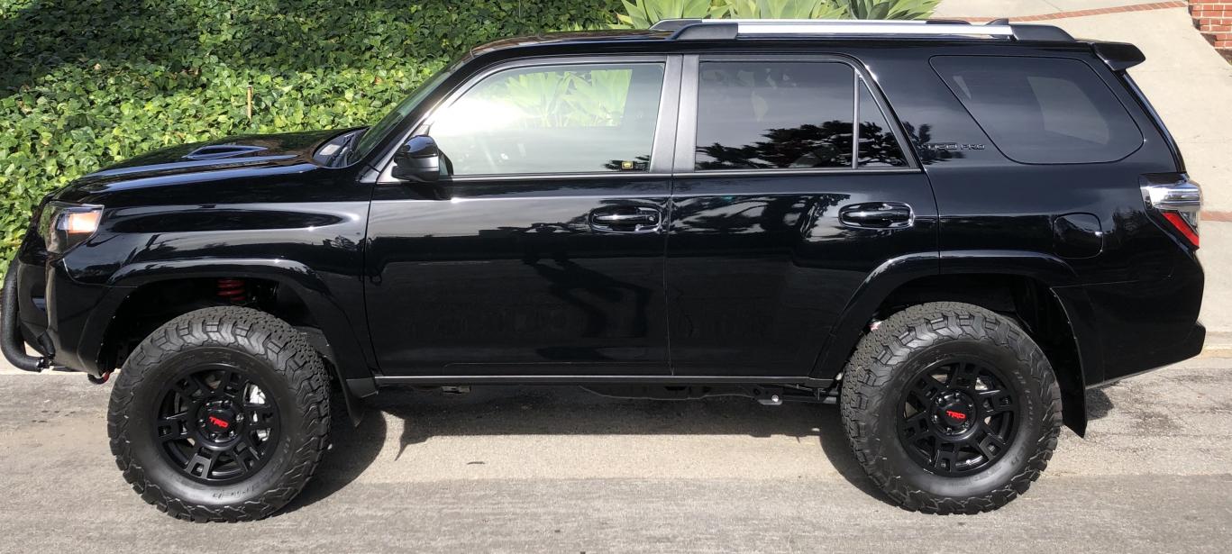

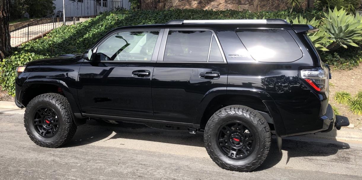

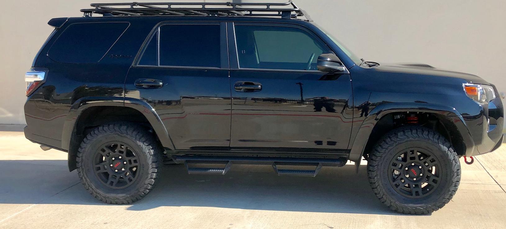

Finally had my Burtman Industries Cornfed Pro spacer Kit installed. 1.5/1”. A big thank you to forum member Tejas for answering my questions and concerns as I replicated his lift and to Jason Burtman for a good deal and information also. Truck seems to handle a little better, nose dive is less and it looks great. Running 275-70-17 KO2’s.

You have improved cornering and nose dive with spacers?
They're preload spacers. They do firm up the front end some and they do improve nose dive. I have the ToyTec version and I could absolutely tell the difference before and after install. I also have poly sway bar bushings though which were a big help so really can't say if the spacers made any kind of additional difference.
Yes. 2016 is correct. Since they add a preload the ride is more positive and there is less felt roll and the nose dive has been decreased.

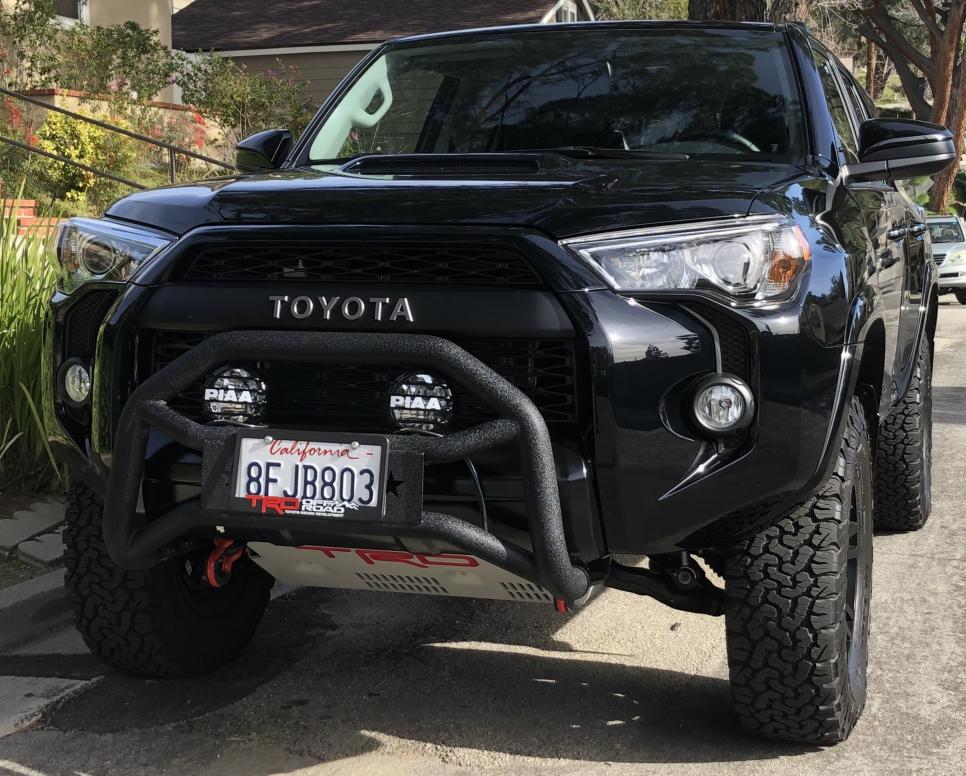

That's hilarious, I logged in to thank Tejas for advice on the same lift. Cornfed's are great- I feel like it does drive better and there is way less nose dive. I'm very happy with the build. This will complete my mods for now- or at least until a supercharger becomes affordable ;)

In black, of course. Lol. I don’t think you’re completely finished with mods. Looks great lol. Tejas will be back with a BP51 kit with 295’s on SCS wheels.
Using the same red shackles too. Did you paint or powder coat your skid plate? Was considering doing mine. Mine came with the 2019 version with red inlays. I also added gloss black lugs.

I know a Line-X guy who did the skidplate. My experience with painting is it gets dinged pretty quick and you're constantly touching up. The shackles I found online and are functional plus look great with the springs
