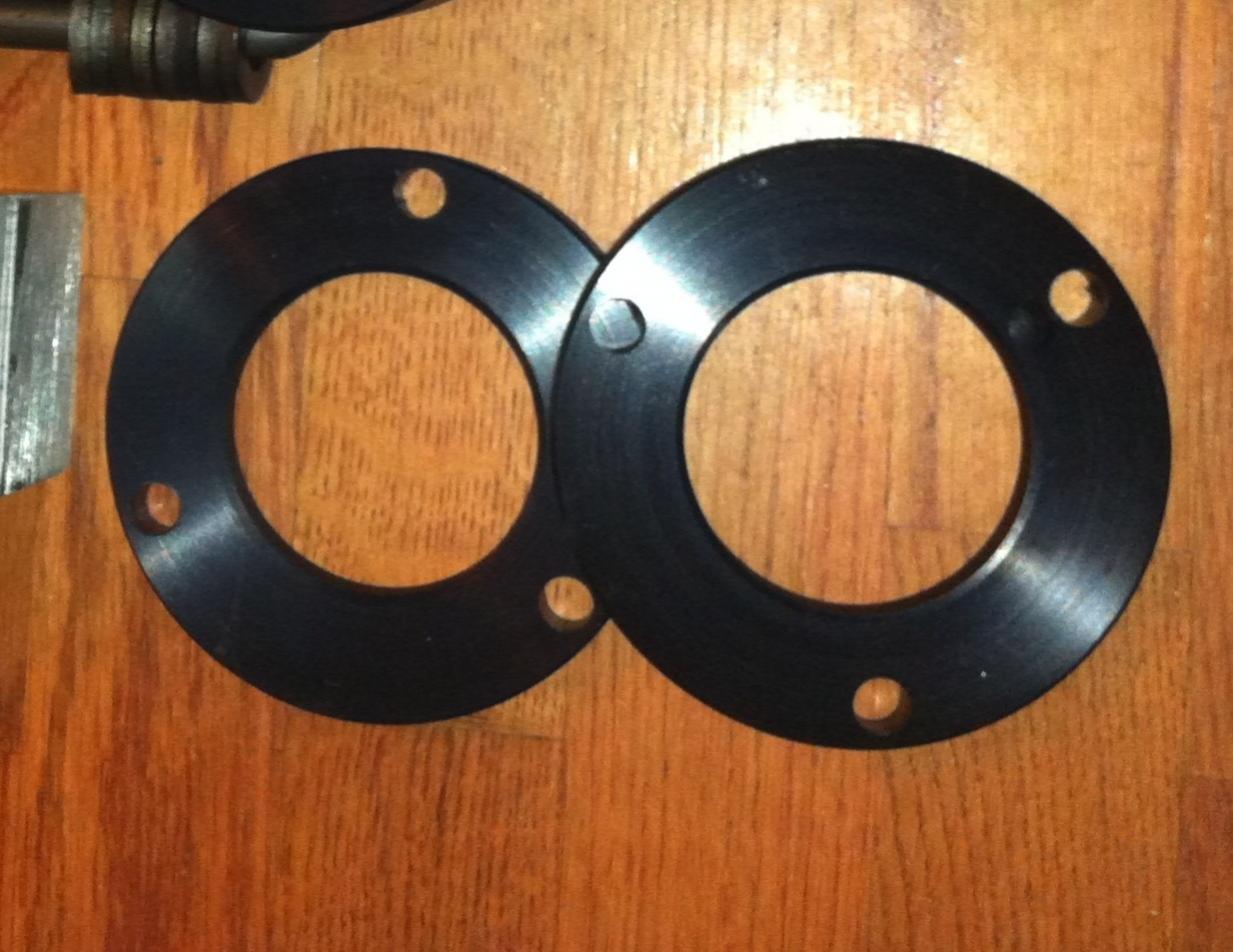

No they do not. The ToyTec kit sits below the coil and replaces the OEM spring seat. The top hat spacer sits above the top hat so there is no shock disassembly required at all for up to a 1/2" thick spacer with yields 1" lift.

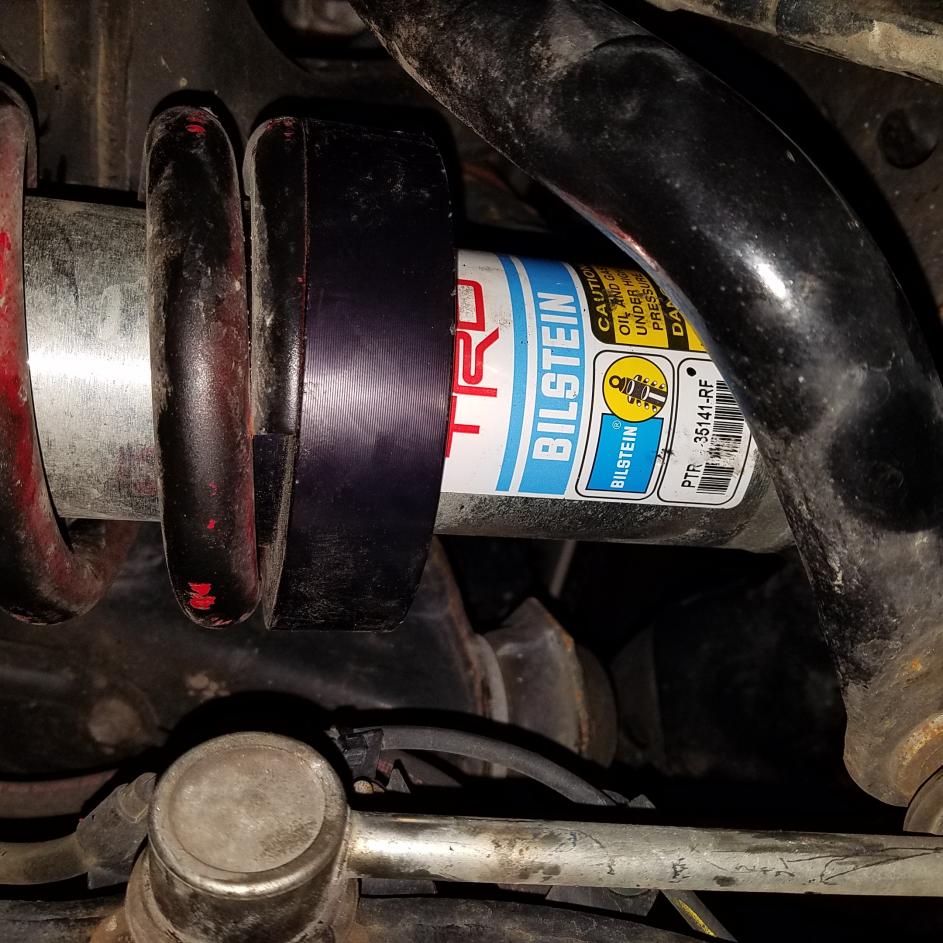

Kit yields .75" up front in a 5th gen. The Toy Tec lower seat adds 1" and the 3/8" thick top hat spacer I installed yields another .75" I'm at 2.5" total up front and have plenty of room for a 285/70/17 I ran a 295 will less lift and I plan on going back to a 295 very soon.
So you have both style spacers ? One below the coil and one at top? If so, why both ? Why not just one of them ?
Yes both. One preload spacer, one top hat spacer. I wanted to be right on 2.5" up front. Just incase you don't know, this is the top hat spacer. It goes above the top hat between the top hat and the spring perch.
