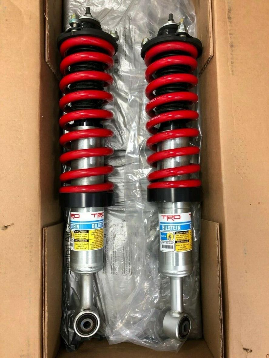

I have the TRDPRO kit PTR13-89160 on the way for my 2019 SRS Prem, it already has the Toytec 90513 Baja/TRD 1" spacer installed. The driver is set at the 2nd notch for the lean, the passenger side is on the bottom.
Question 1 - how much lift will this yield me in the front? about 1.75"
2)What size Cornfed spacer should I run in the rear, 3/4 or 1"? Or wait and see after front kit is on and settles? I have ICON 2.0 shocks in the rear, no lift.
3)If I get an alignment right after the front and decide to add the rear spacers after, is another alignment needed due to the rear lift?

Your front lift will yield you ~ 2.75” as your lift is usually double your spacer in the fronts.
For the rears 1” sounds about right.
I believe you should always align if your changing heights.

Just a heads up, that spacer only lifts the vehicle 1 inch, as the spacer is only 0.5 inches taller than the stock spring perch. You should get about a 2-inch lift from that setup, TRD pro shocks + Toytech spacer, not a 2.75-inch lift as suggested by another member (I bet he is running the top plate spacer as well, and that WOULD give a 2.75-inch lift.). I am running the same set up on my 2018.
I am not running any spacers for the rear, and I still have a small rake. I do have a winch bumper and winch though.
For your rear, I would go with a 3/4 cornfed spacer. This would leave a very slight rake. The front springs will settle over a few days, and the rake should end up being pretty much perfect. I am very happy that I did not install a rear spacer, as my winch ended up exaggerating my rake.

Info above is incorrect. The toytec preload spacer yields 1" It's a preload spacer, not a top hat spacer, they do not work the same way. The pro suspension will give you an additional 3/4" so putting those shocks in your SR5 will yield 1.75" up front. Go 1.5 in the back to keep a slight rake or 1" of you want to be pretty level.

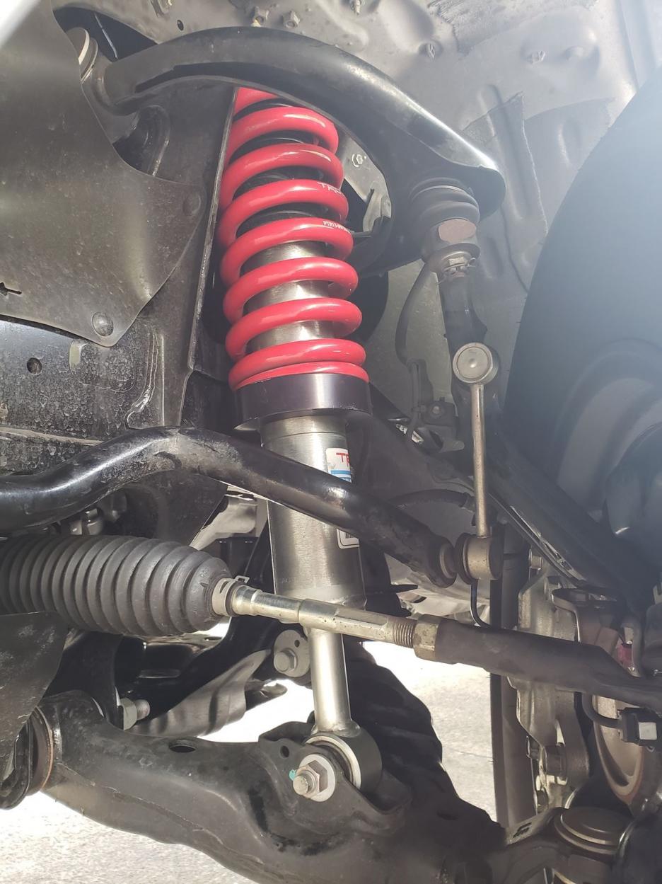

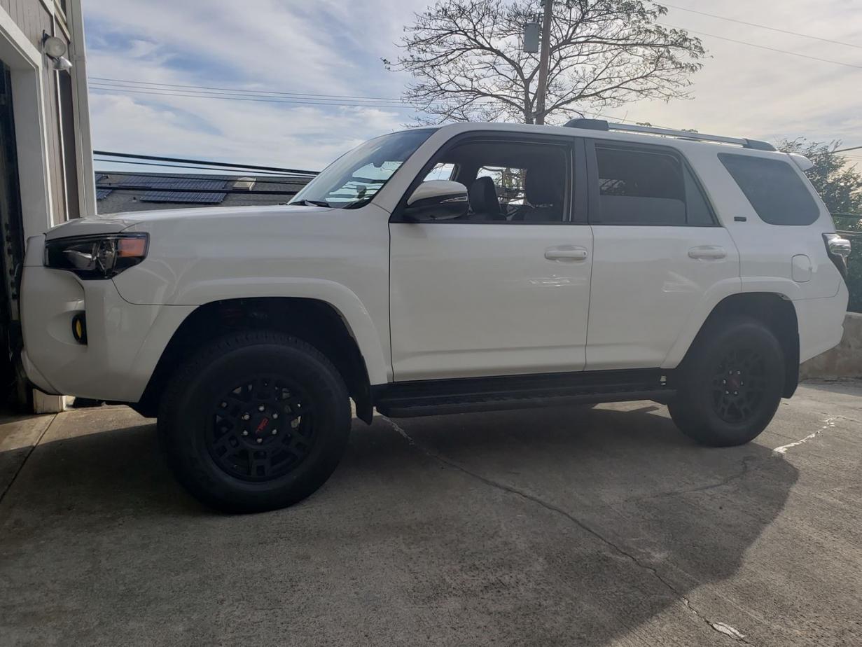

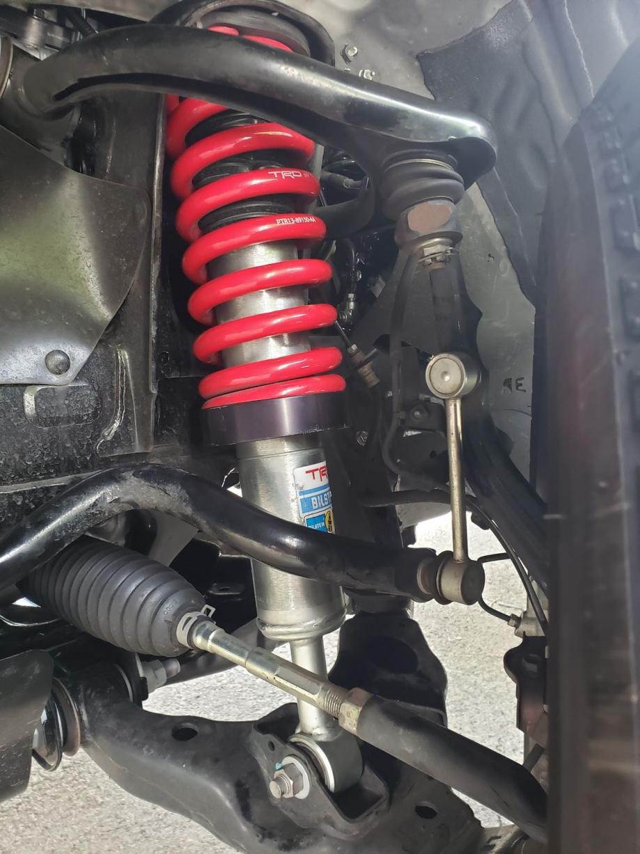

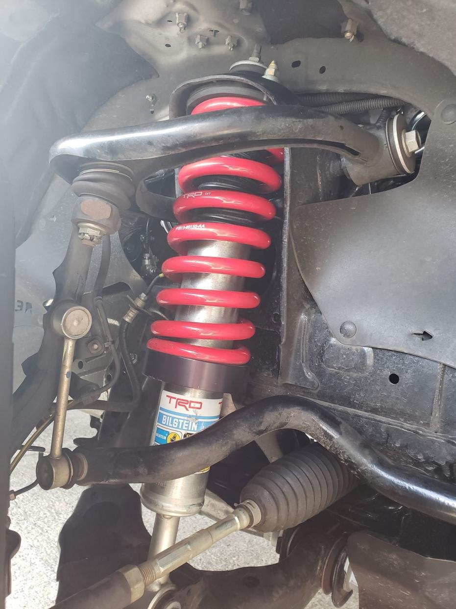

The front kit arrived today, got it installed fairly easily without any issues, having it preassembled was worth it. Currently sits just over 3" taller, should only be 1.75. I did a quick shake down test drive, all is good. FYI - I did not have to loosen the lower control arm nuts, just the 2 on the hub assembly but I did undo the skid plate and sway bar.
I'm hoping it will settle a lot more before the alignment on Monday. It looks just a little toey.
New measurements:
Ground to fender
DF 37.25 PF 37.25
DR 36.5 PR 37
Any idea why so hi? The kit was exactly as pictured in the thread above.
New measurements:
Ground to fender
DF 37.25 PF 37.25
DR 36.5 PR 37
Which kit? With the pro suspension, the lower spring seat, and the top hat spacer, you will sit right about 2.75 over stock. Can you post pictures of how you installed it? I have seen a bunch of people install the kits incorrectly which causes all kinds of issues and way too much lift.
The kit is PTR13-89160, No top spacer, just the bottom Toytec 1".
The STRUTS are part# PTR13-89160 LF AND RF, the LF(driver) is set at the 2nd notch up and the RF is on the bottom notch.
The springs are TRD part # PTR13-89150-AA
This is my first Toyota front strut change but have done it 3-4 times on my 15 Colorado, similar job.
I undid the sway bar, top 3 strut tower bolts, lower strut bolt, 2 bolts on the lower arm near the ball joint, did not need to loosen the lower arm control nuts. Slid out the OEM strut assembly, slid in the TRD kit, rebolted/ torqued everything. What did I miss? Why is it still sitting so high?
Appreciate any feedback. I may end up removing the Toytec spacer as I don't want to be over 2". The back has no lift.
Is there any chance the unexpected increase lift height is because I'm a 2wd vs 4wd, less weight? If I remove the lower 1" spacer, what part do I replace it with, prev owner did not include the orig spring seat.
