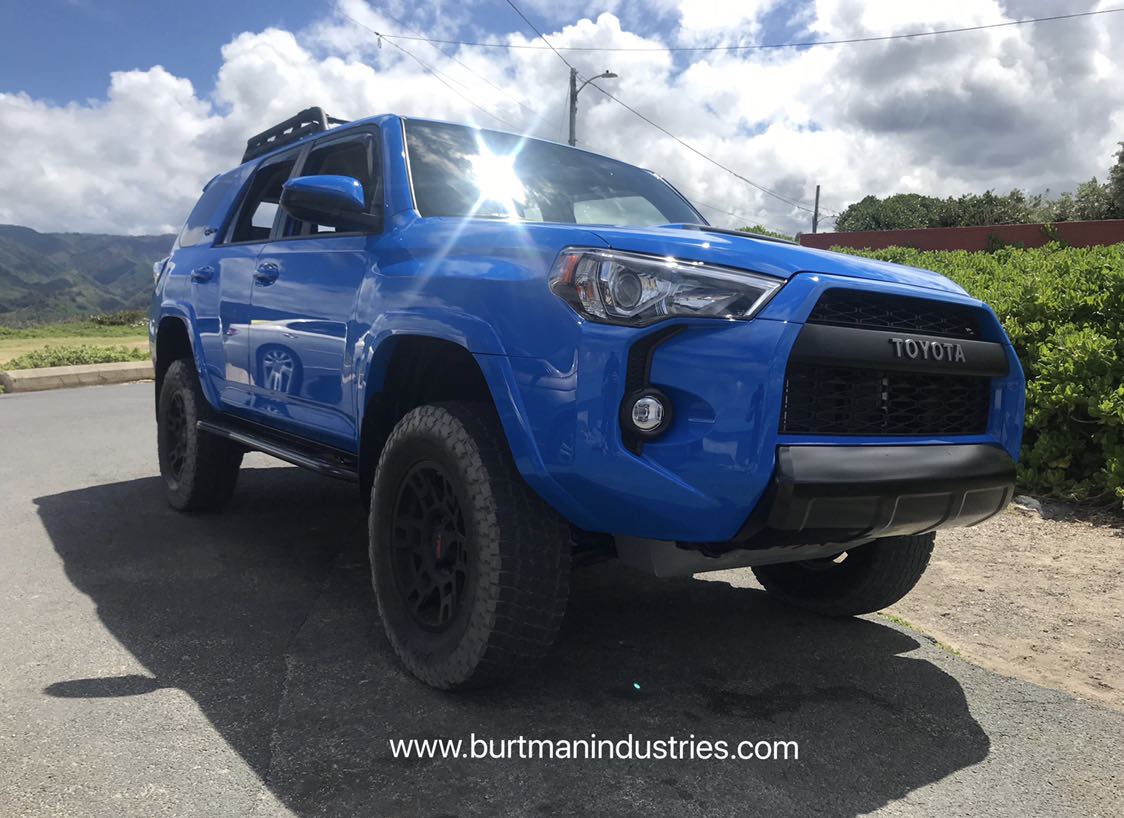

Which lift kit is this in the pictures of the calvary blue?
Hey, yes, that's actually a 2.25/2 kit. Yes, can do that kit also, on the website, choose the 2/1.5 kit, and in the notes box at the final stage of checkout, put in, custom 2.25/2 kit. Will do for same price.
Burtman Industries 5th gen lifts for sr5, trd pro, etc.
Oh and guys, I can have ANY SIZE custom made for you. Just let me know.
ANd here's a new Vodoo blue from another customer I sold lift to:
