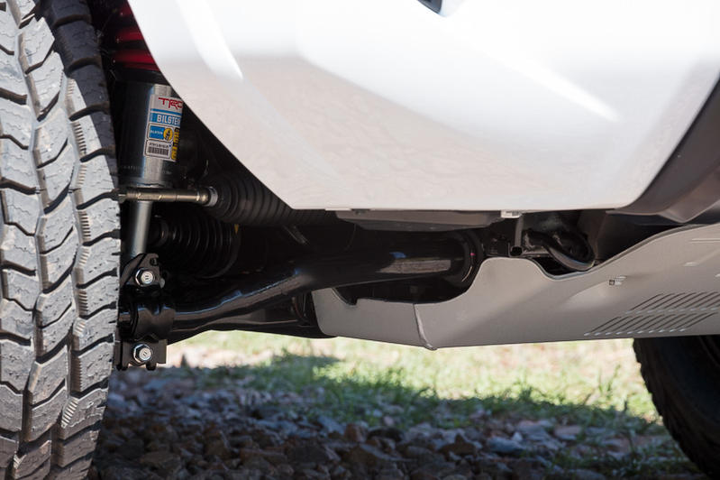

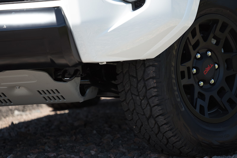

And it's finally here after 7 weeks of waiting, skid plate installed:

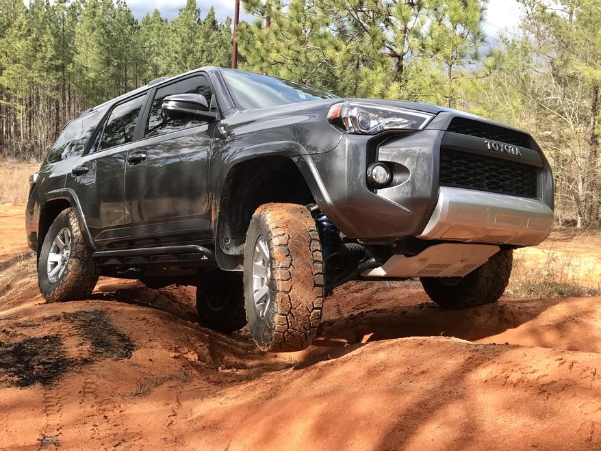

Thanks for making the PDF and thanks to [MENTION=139345]MtlTRDPro[/MENTION] for making the template. I haven't installed mine yet as I'm waiting to put my lift on but I feel it turned out pretty decent.
I ended up repainting the front of the skid. I marred it up a little while doing the cutting. Plus I didn't want to have exposed bare metal in some places. It's a tiny bit brighter silver with a touch of metallic. I like it.
Those cuts look really clean. Did you use a jig saw?
Yes, I used a jigsaw. The cut that was longer and less curvy turned out amazing. The other one wasn't nearly as good. However I went up to my dads today and used some of his metal files and cleaned it up. Made it look as good as the other. Then I just sofented up the edges on each side.
