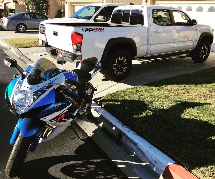

Just wanted to thank everyone, again, for their support. I have gotten a replacement sooner than expected. It's not a 4Runner, but it's still a Toyota. This time, I did purchase a recovery device.

Great looking truck! I haven't driven a new Tacoma yet, but it would have been on my test drive list if I thought the wife would have given it a chance. She drives the 4Runner as much as me, so I had to consider her feelings.

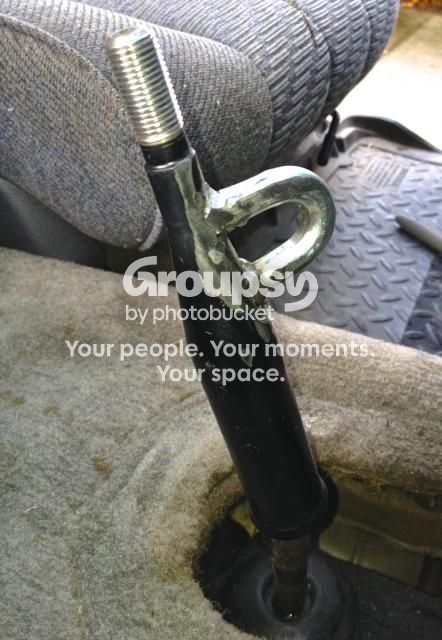

For those of us with older trucks , a quick and easy shifter lock
I welded half a metal link onto T-case shifter
IMG_3490_zpse832383c.jpg~original

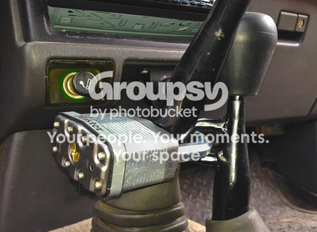

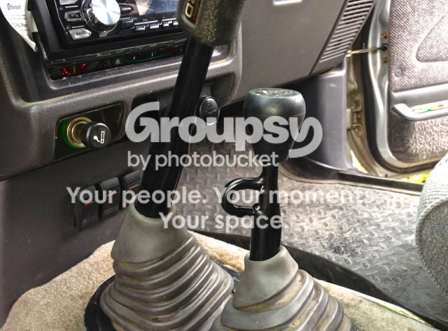

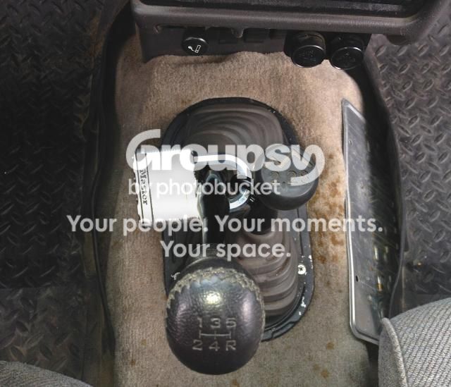

With truck in reverse , tranny shifter and T-case shifter can be locked together
IMG_3510_zps60cbd6af.jpg~original
IMG_3511_zps4af6cb37.jpg~original
IMG_3512_zps59fd55df.jpg~original
Along with a kill switch , this just adds a little more inconvenience for any would be thief ...
Now THAT'S a good idea :bravo:
You also have a manual transmission, that should be enough in itself! Ha!
